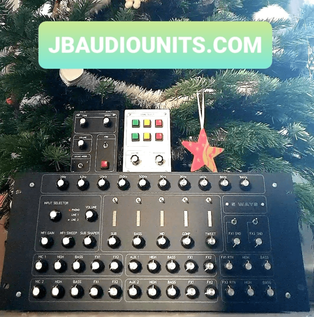

These days i don't often play parties anymore, and if i do, it's mostly on a dub sound with a custom build "dub preamp" that does not have that. But most soundsystems use dsp now (8x8dsp modules, with the filters still from that preamp, but with eq and phase alignment, limiters and delay lines in the dsp) and most do cut at 30hz with a steep filter to avoid blown drivers. It used to be a common thing before dsp, but new drivers are very expensive...
This is one of the more popular "dub preamps" made now by a guy known in the scene as JB. Many older ones are still in use altough (taken from his FB). It's custom build dj mixer, eq and 5 way active crossover in one unit, tuned to play reggae and dub and is almost always mono (as dub sounds only play in mono) and only has one turntable/cd input as the music is not mixed traditionally. This can be customised off course, as each unit is build to order and modular. Other builders do similar things. The smaller units on top are dub sirens.

Our sound system used active filtering already in 2000. We had behringer analog xover and dcx2496, the gain in clarity versus passive was obvious... but it was often drunk punk operated at first, it took some dead drivers before the rack seen a locked front door to not let random guys applying 'filter effects' on the whole system when operated. Damn acid driven a..holes!
I think i've already seen JB mixers circa 15/10 years ago. Last dub system i've seen runned a tube based frontend. It was fun to listen to.
Siren are a big deal from what i've seen ( did some studio work for dancehall/ragga when still in Paris).
In what they are so special? I never got it. I usually used my DP/4+ and BBD delay/ line6 echopro to produce approaching effects but producers was not all happy about it.
Hmm. I think we drifted really OT...
