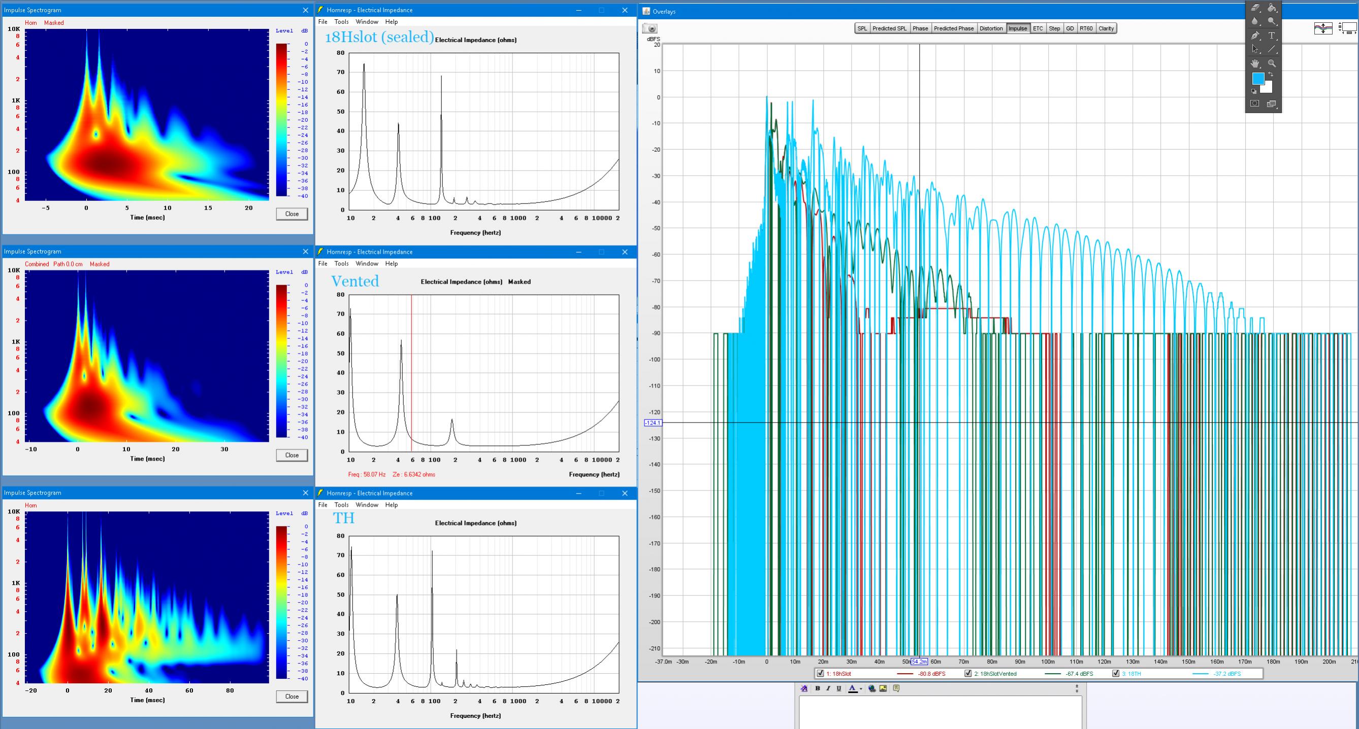

Tell me more please. I used to run MLSSA and export the data into LEAP, but that was long ago and I'm out of touch with current options. And I cannot connect my LEAP parallel printer port key to my MacBook Air ha ha. Yet I plan to get back to designing a project and need more modern software.modern design software
I also very much would like to be able to simulate tone bursts. Even if just from a simple electrical filter model would be interesting. I just find it a very visual representation. I could once upon a time do this by exporting a simulated response backwards into LMS and it would do a transform and then I think I could simulate a tone burst...or was it just the impulse response, hmmm.

Hmm, seems reasonable, but the reality is that a low Qts driver will in comparison have a higher/wider impedance peak at Fs ['ring' less] than an otherwise same driver except higher Qes, Qts.
In 'round' numbers, double Qes = halve the impedance peak and IIRC, halve the BW.
GM
If we go outside a driver that is considered "otherwise" the same....then yes? A lower impedance might be the result of less magnitude of resonance...correct?
~363l and tuned to ~22hz
Yes, if I understand you since you can juggle specs to get the same results, ergo conversely juggle them to get radically different ones, so seems better to solve for one or more specs to get the lowest practical total impedance and of course there's the box Q and any vent losses to account for to get the desired system Qt [sysQ].
GM
What is it you are showing there?
compare impedance vs resonance.
