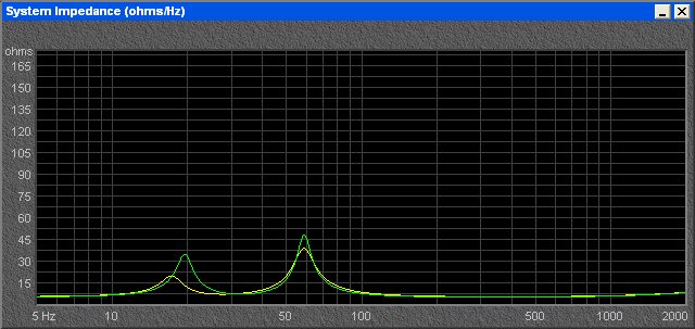

If the acoustic curve is "right" what does the twin saddle impedance curve look like?
No worries, this is for fun.
Hello DT
Depends on what you are doing. My last DIY speaker I chose to low tune the box to 26Hz and add a 6dB pump filter to extend and flatten the response. I also had a more typical 32Hz box tuning.
Looking at the impedance curves they follow the pattern where the closer you get FS to FB the more even they get. Green is 32Hz and Yellow is 26Hz.
Only thing I look at is the minimum nothing below 4 ohms.

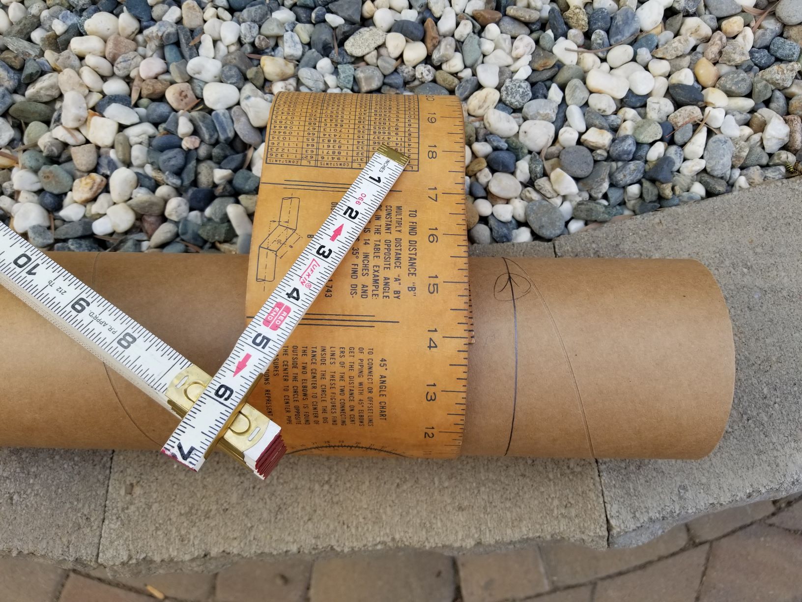

Hello All,
This is a bit more hands on than sitting at the desk.
Yesterday I received from Amazon a box containing several Heavy Duty 4 inch ID mailing tubes. Soon to be cut to size to be speaker enclosure test ports. There will be 6 or so ports cut in ½ inch or so increments. To keep the box internal volume constant the port tubes will extend outside the enclosure.
The enclosure is near 2 Ft3. The driver is a JBL 2204H, perhaps if anyone insists, also a JBL 2206H. The test plots will be impedance, phase and a little later Frequency Response. Initially the interest is the shape and slopes of the impedance curves, starting with frequency and magnitude of impedance peaks and to note any changes as a result of the addition of enclosure and port stuffing.
Thanks DT

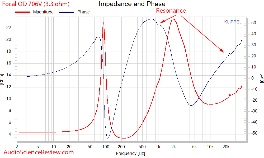

Hello All,
Let’s assume that the typical speaker simulation software does an ideal job of selecting woofer box volume and port dimensions.
With that assumption in mind what does the woofer impedance curve look like?
I have spent some time looking at speaker reviews over at AudioScienceReview.com. The bulk of the speaker reviews all of the reviews of real commercial reviews have a impendence plot where the higher frequency of the “twin saddles” has a higher value impedance than the lower frequency saddle.
What does the woofer simulation theory say about that twin saddle impedance curve?
Does the theory match the empirical data?
Thanks DT

For a maximally flat damping, the two impedance peaks should be of equal amplitude.
If overdamped, the higher frequency peak has the higher amplitude.
If underdamped, the higher frequency peak has the lower amplitude.
Tuning at fs may sound 'boomy' and so the overdamped alignment may be preferable, as indicated by your commercial reviews.

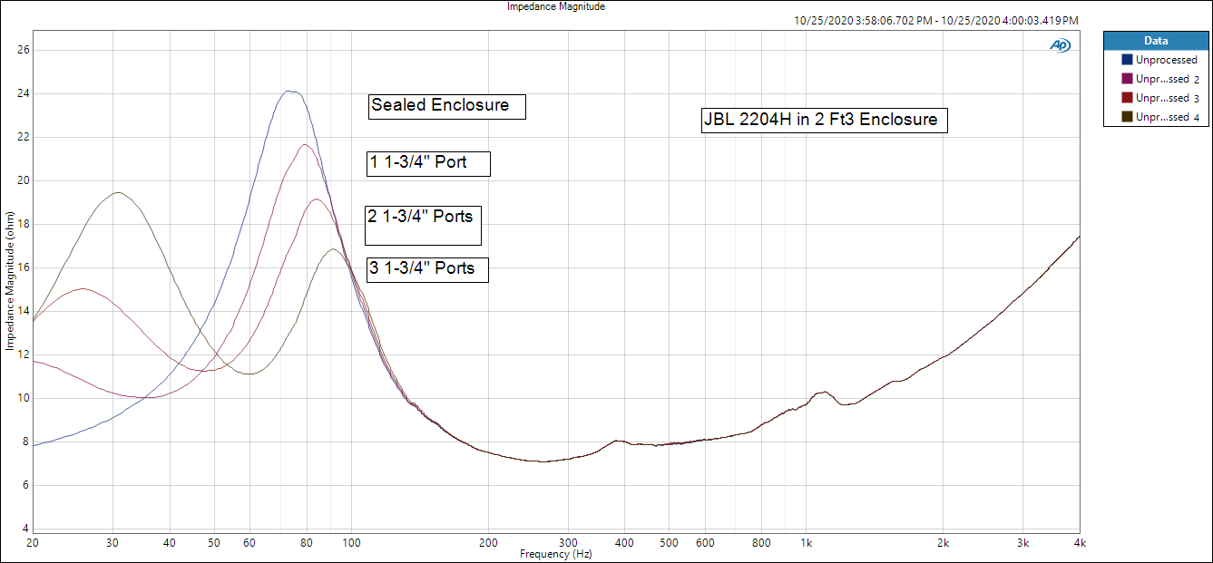

JBL 2204H in 2 Ft3 Enclosure.
Impedance Plots:
Plot with 0 Ports
Plot with 1 Ports
Plot with 2 Ports My Pick for SQ and bass extension.
Plot with 3 Ports

.... and the relationship of impedance, cone motion, and sound output is:
The impedance of a cone driver tattles pretty well the cone motion.
A purpose of the BR concept is to counter-act cone motion by anti-tuning the box you mount it on to somewhere near the driver resonance. But there are trade-offs.
North of the tuned frequency, the port(s) add to the cone motion and help the bass.
At the tuned freq, all bets are off depending.
But below the tuned freq, the port(s) subtract from the cone sound.
So in your mind's eye, you can look at those very nice curves and add or subtract to get the expected speaker sound.
BTW, the box is way too small for that fine Lansing driver. That's why the impedance peak is so darn up the freq scale.

2ft3 is exactly what JBL recommends for this JBL 2204H driver.
Different design goals for different people. If spousal-factor (size of cab) matters a lot, then 2ft3 is great.
But if satisfactory bass is your goal, moving the resonance cut-off of the driver from 45 Hz to 75 Hz, that small box isn't a good choice.
Sims may give the same odd advice. I think the sim is prioritizing the range of flat performance at the cost of low performance. Not a smart trade-off I'd say esp since nobody really likes flat bass, at least at volume levels that preserve your hearing. You shouid have a conversation with your sim just as you have a conversation with the folks who come to paint your house.
B.
Yes I think that it interesting that the simulators probably do target a flat response rather than some single accentuated one note bass thing.
