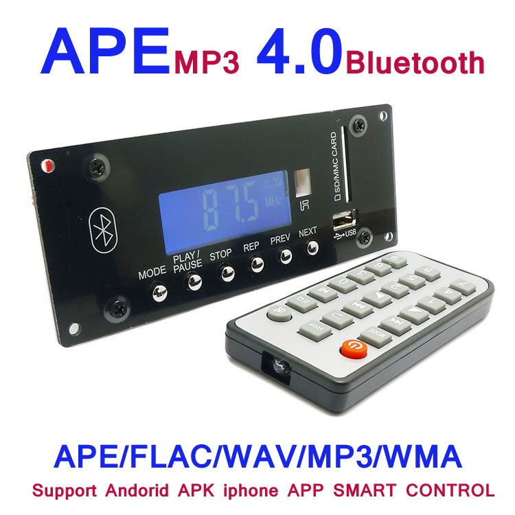

I am building a little integrated boombox style unit for my girlfriends apartment and looking for a tuner/mp3 player that is of decent quality. I already bought this
Jk6836bt Usb Sd Mp3 Digital Display Led Aux Radio Fm Decoder Module Dc12v 5v Board For Audio Player - Buy Fm Decoder Module,Digital Usb Module,Audio Player Module Product on Alibaba.com
But it is such a 2 cent piece of junk that i wouldnt give it to my worst enemy.
Aside from using a car head unit are they any well made products similar to that, but with a better build quality???

The tuner section is the same - useless.

This module has good reviews but in this category it will always be a hit or miss...
