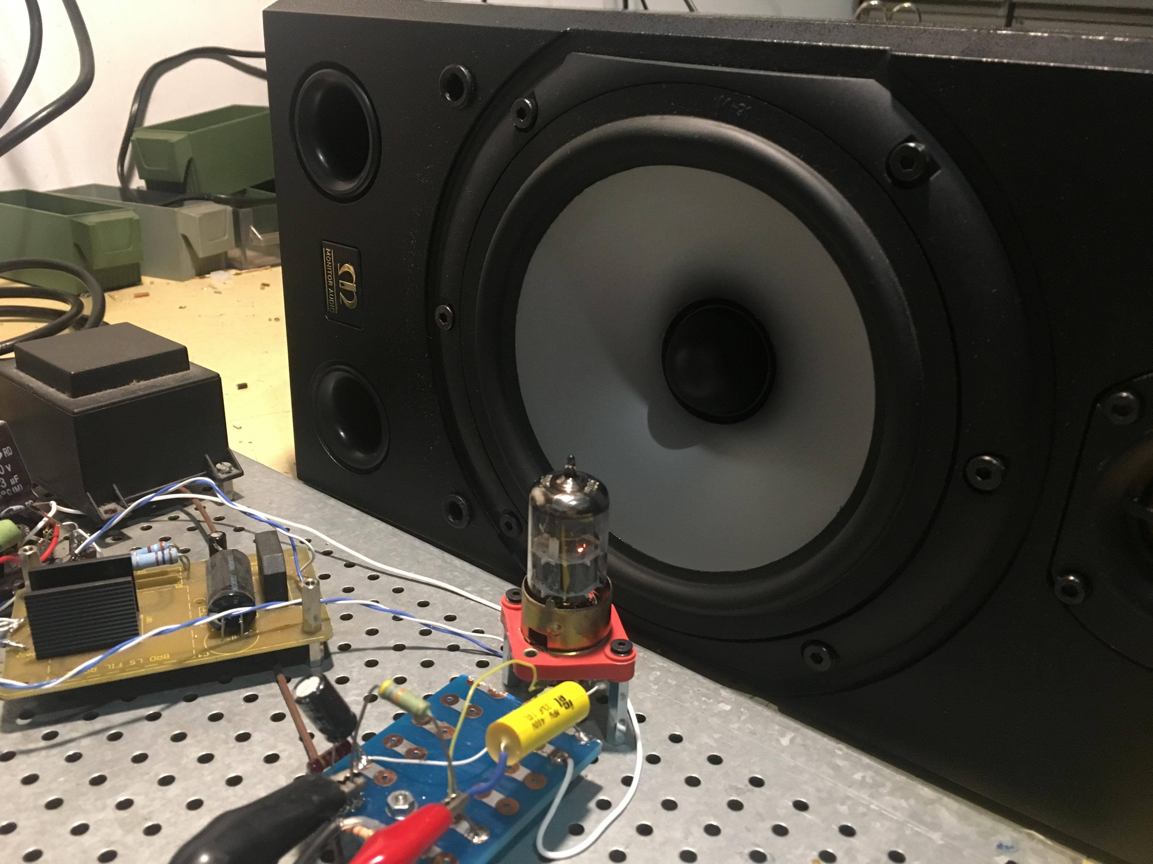

- The test set up was found after some check. The main goal is to isolate the valve from vibration comes from table, mechanical stuff as rigid cables form test board to socket, etc. This was done because I put a two way speaker (Monitor Audio) directly pointed to the tube and installed on my table:
Foto_10
In this situation with a sweep from 20 Hz to 10 kHz nothing happen on a low range frequency while at high frequency the results are comparable with the one obtained with Fostex .
The vibration to the tubes comes in two way, first trough the mechanical stuff as rack, foot of the equip and metal box; second by the air with the sound pressure.
So the first thing to do is to eliminate ( as much as possible) the mechanical way.

Regarding the O-ring the effect is very good: the E88CC Siemens is very good tube well made ( as normally for thr Nos) but a little bit microphonic so the test tell us that an improvement is obtained.
It is an improvement and not a solution because, in my opinion, the limits of the quality of the mechanical costruction are always present and, in every case, a metal structure has a proper vibrational charatheristic.

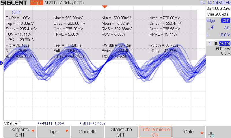

In Figura_15 there is a capture from a scope of a spurious signal at the output of the test circuit with a 6H23 russian with a single point getter; I sent a 1 w / 14.600 Hz signal to Fostex, this frequency is resonance seen on Test_B9 (Trobbins was fine, was my typing error!!!)
Is possible to see a signal with an amplitude and seem to be instable.

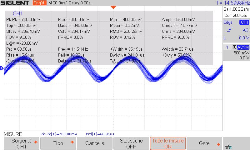

On Figura_16 the same with the O-ring installed, the signal is more clear but the amplitude is lower. peak to peak from 1,06 volt to 780mV
I teste the same type with two different getter, one fix point and two fix point; the results are better for the two fix point.
On the Mullard tests there was a results with a tube with two different getter fixed in different mode
The better result is with the getter fixed stronger.

I test at 1 watt with Fostex just because this loudspeaker can't handle more power; in my opinion this is fine because the main goal is to understand what happen. In future will be possible to check.
I have also test with a can installed on McMurdo socket, I haven't found great changes; the impression is that was worst but I haven't spent lot of time.
