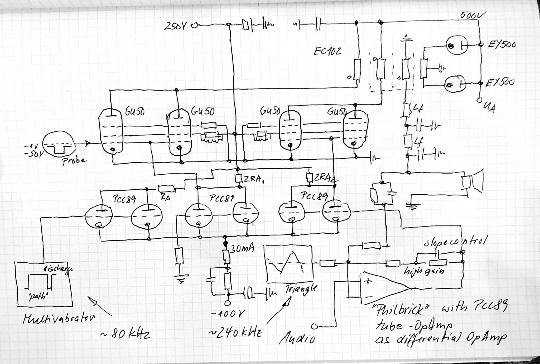

Details in my circuit are weak design. I need to enhance the driver, in order to ensure it's swing exactly down to -50V and guarantee no positive values at all.
But I started simulation and the delay beween the crossing of audio and triangle to output is in the range of below 100 nsec delay. That seems promising.
The 3-triode design will be a 3-double-triode design. Fun fact: 3 times 7.5V/0.3A heating is easy to get with my 12V/24V transformers.
The Mullard datasheet for PCC89 indicates 15mA as nominal anode current and 90V nominal and 130V max. Others specify 20mA max.
The 3-triode design will be with 1 single common cathode current source.
Use of the differential stage (2 of three triodes) is the best option for symmetric, fast and opposite output to the GU50 gates.
The anode resistors and anode current in fact dominates the rising time at the gate of the GU50.
I will update the schematics, when I am satisfied with secure swing at GU50 gate 1.
The magnetic discharge will be changed to double the winding, center tap and use 2 pretty EY500 for discharge.
Greetings,
Joachim
The simplified circuit, but with driver stages fully drawn.
The tuning of the 3-triode differential amp (with double systems) is done with the resistors. Maybe, I add a supervising circuit, which ensures the g1 swing between -50V and -1V at those 4 GU50.
The 3-triode circuit is driven with 2 rectangular signals in harmonic frequencies.
One represents the 'PWM' with 50/50% at idle, silent audio, the other is the magnetic discharge control. It will have a 33/66% constant ratio, in order to fully discharge the EC102 ferroxcube magnetic energy. Keeping this ratio is a security measure.
The GU50 will switch between almost 0 and 300mA each.

Thats about 16W of heat on each of them ( 250v - 50v) ,and also rise time not guaranteed . Better i think would be use same type tube as dynamic load or as CCS in place of these resistors .
30mA == 15 mA each. Anode voltage swing to ~ 5mA is 50 V; in idle, silence this is 50% of 1.5 W max anode dissipation ?
I know, resistors are limited. But look at the current per voltage of GU50, that is not too bad.
You said swing for gu50 is 50volts .Supply voltage +250V, GU50 cathode is on ground potential. So one resistor end is at +250V always ,another end is at about ground potential (when gu50 is off) and about +50V when GU50 is ON .So simple mathematics : ((250V - 50V)*(250V-50V))/2500 Ohms . So resistor dissipates 200 to 250V on its 2,5k , P=U*U /R . 200*200/2500 = 16W .And also current is 80ma for each resistor when GU is on ,and even more ,if OFF .

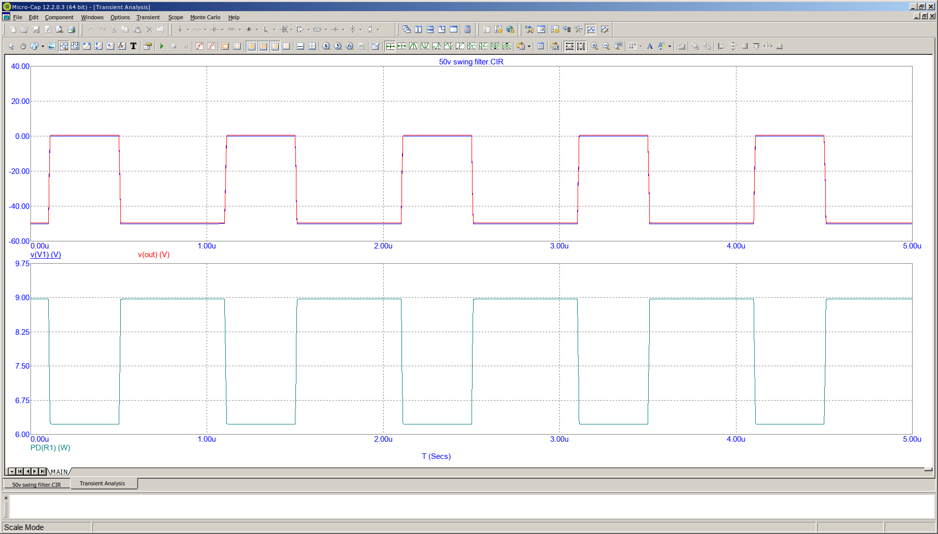

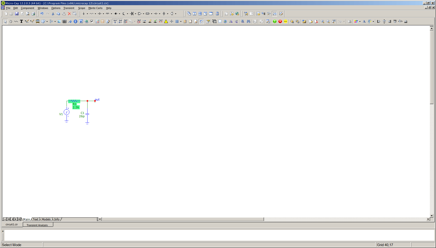

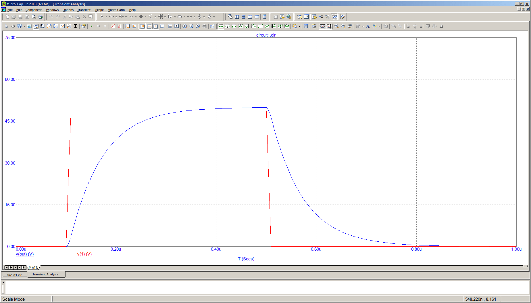

2,5k resistor and 26pf makes a nice filter for even slow frequencies ... You will get a closer to triangle to sawtooth with resistive driver load .And this is not include sockets capacity ,output tubes capacity ,wires ,pcb and so on. Screenshot from microcap sim attached . Red is pulse source ,set to 100ns rise and fall times ,50V amplitude ,and blue is what you get after resistor value 2,5k . You said 10k ... That's worse .To be more precise , need to be simulated from higher voltage source, it may improve a bit .
Your circuit is not comparable: the voltage source is not 50V and the slope will keep the high rate from start. Constant current!
We need a calculation with Coulomb, current, capacity. The current is only defined by the resistor, in upper slope. The triodes define the currents.
Parasitics are more, but the gate capacity dominates.

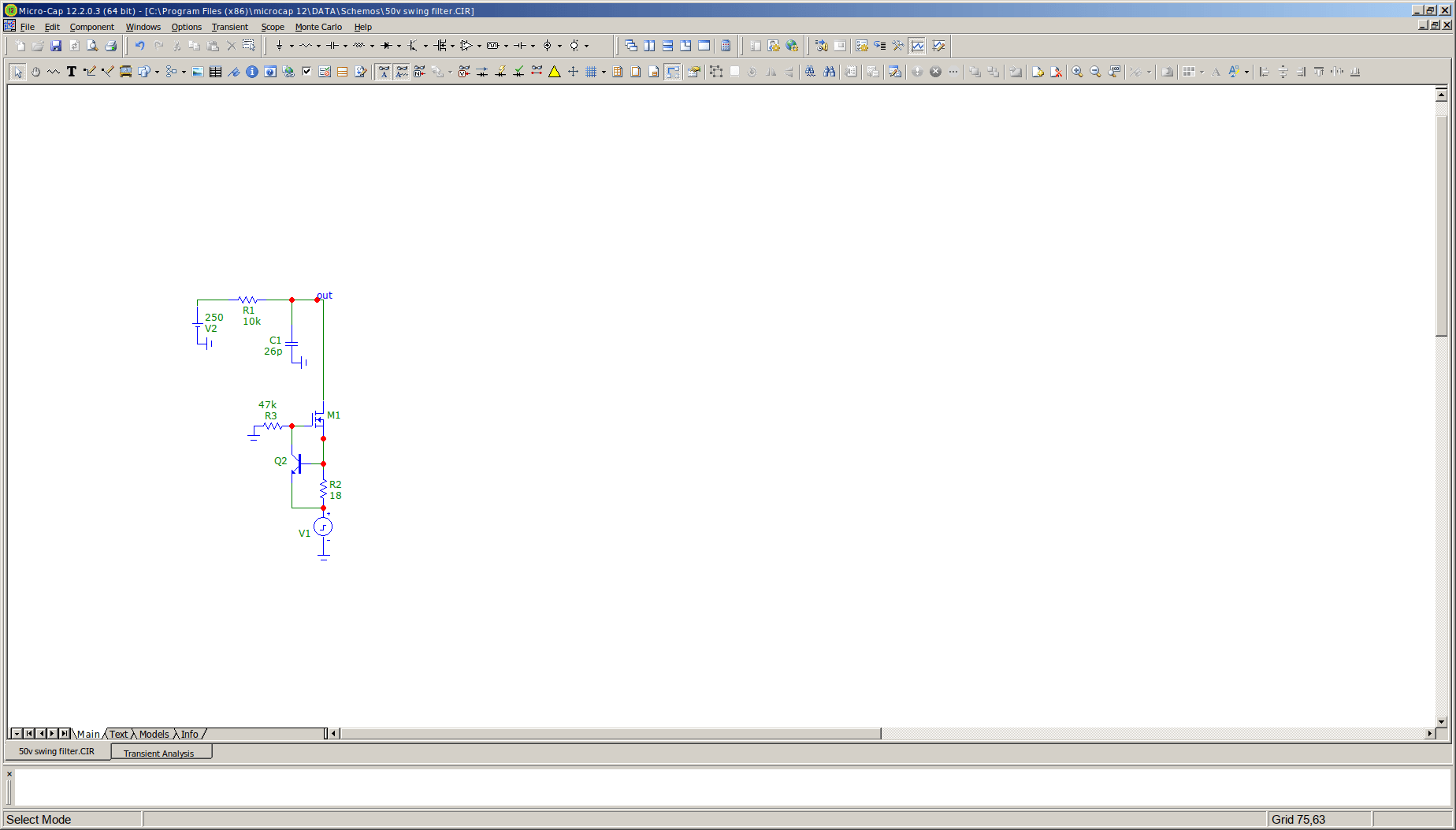

Triodes define current only in one direction , when voltage at GU50 input is going to be negative . When voltage is coming close to ground ,turning ON GU50 ,resistor resistance dominates . Your driver is currently assymetric output . Negative swing is dominated by triodes ,thats right ,but positive - by resistor . Rise time will be different than fall time i think .Yes ,i agree, my circuit is not accurate ,but its showing a resistor effect with input capacity of tubes .Maybe i should try another simulation with current source to negative ,but i don't think it will improve rise time , only fall time .
Try to use just the 10K with 250V and start from -55V , stop at 0. 😎
Start will be at little bit more then 30mA, Stop at 25mA.

Let us try simple. Just with: let the triode react large signal, from 30mA to just 1 mA, to keep it running. In order to raise anode current to 30mA ASAP. The cap of 26pF is then discharged trough resistor over a swing of 54V with 30mA at the beginning, 25 mA near finish. The last mA is drawn somewhere, no matter, how. We just want stay at -1V and at -55V, respectively.
Average current is 27.5mA. Charge within g1 at start will be 1.04nC. At the end it will be 0.026nC. Simplify to 1nC. Slope time will be 36,36 nsec.
If we count up other parasitics, this might be 40nsec. Just for this gate drive. Not too bad!
