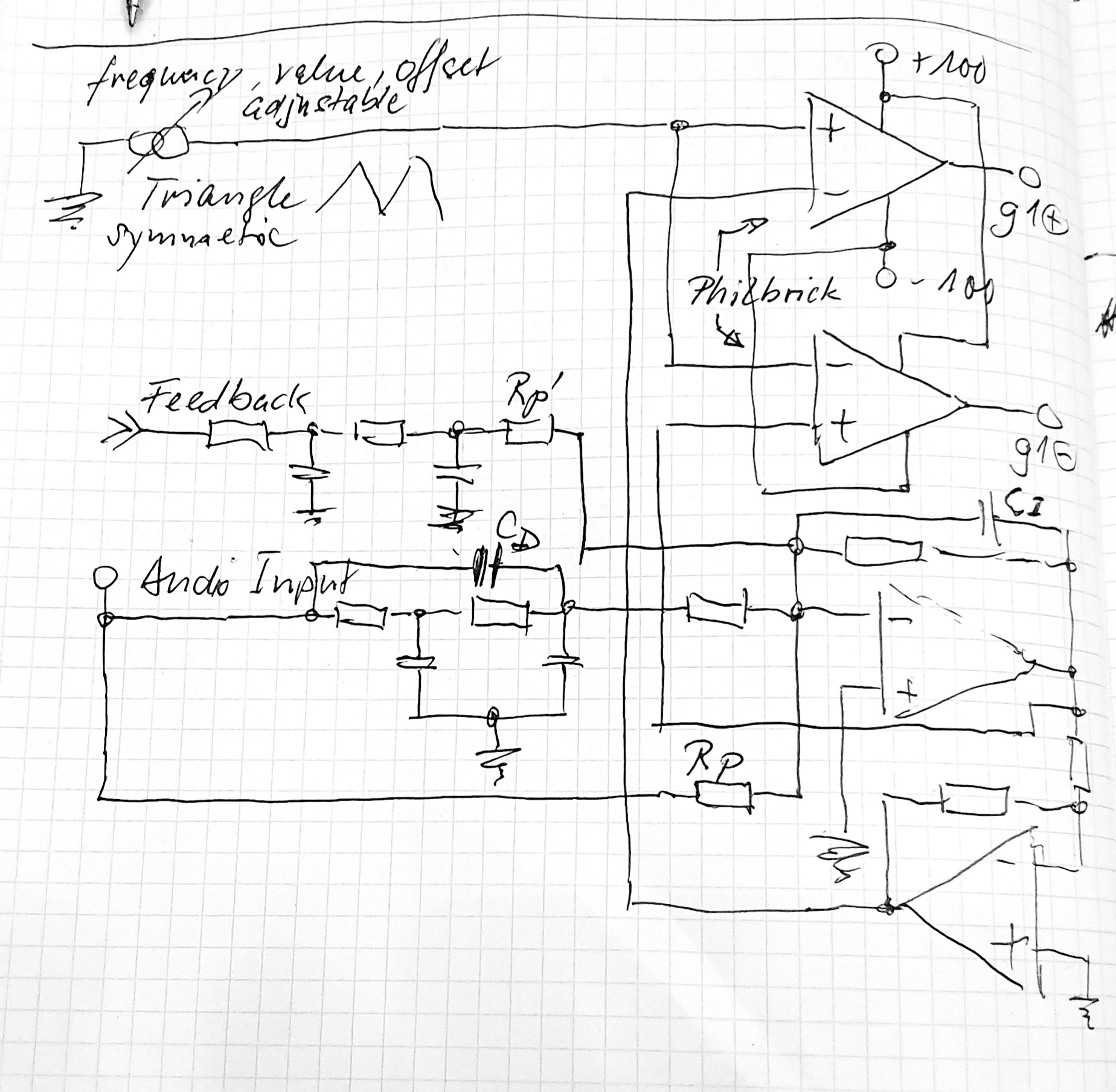

yesterday I did it wordy. Today I send a sketch. It is an awful drawing, but is probably near to usable.
I create 2 domains: Semiconductors for high speed circuits on low amplitudes. The other domain is tubed - including the conversion to high voltage swing OpAmp with 3 symmetrical stages of PCC89 triodes, summing up to 6 tubes PCC89. They drive the GU50 gate 1 between -80V to -50V and something around -5V to -1V ; off or fully open!
Why GU50 ? I have them in stock. And they are powerful, simple pentodes. Quite fast, low g1 capacitance and capable of around 300mA without too much wear.
With 4 of them, I might get around 250W output. A nice side parameter: it sustains 1500V anode voltage, while g1 is at -50V (minimum).
Why PCC89 ? They are very, very fast, normally used in UHF circuits of tube TV. And I have them.
Here is the drawing:
The lower part is new. There are simplified blocks. All parts with a star will be semiconductors. Just in order to avoid months of work and hundreds of bucks. The blocks are PID (proportional, integrated, differential) processing for generating a feedback, which is usable for this powerplant.
In the upper section of lower half, there are 2 opamps, built with symmetrical circuit, drawing from -100V and +100V (might be clipped later). 3 PCC89s will make up 1 opamp.
Wherever I rubbed out parts, you can see my thinking stages...
Finally, there must be some circuit, which makes the entire thing secure, in the sense of: does not destroy itself on powerup or power loss. I will think about that later.
I will use an adjustable triangle; frequency, offset, peak to peak. And I will have another offset, which will cause the 2 powertrains to overlap and make the diode blackout disappear. Most probably, there will be some chokes around to limit RF emission. between the diodes, there might be a double winding choke to catch the overlapping energy. We will see.

In the meantime I cleared up my awful drawing for gate driving circuits. I place it here again.
It is simplified, technically.
Two aspects: the opamp design and the feedback included signal processing, having the proportional, integrating and differential components included.
For my opinion: better, than before.
The right side is single ended. It will drive the the GU50 13pF g1 input. The PCC89 has 10mA drive for a 50V swing. Values are not calculated, nor proven. But a good orientation.
I use a high voltage zener instead of the ionised gas lamps (noise). I lowered voltages to stay within PCC89 specs. Precision will be lower, but speed higher. Which is, what I need. The function is a comparator.
The triangle generator circuit and PID section will be with very fast opamps from AD.
My target is not, to distort the signal in any way. The signal/noise figure shall be very good and the overall feedback is essential.
I will need to remove the lowest frequencies along with DC input - the whole thing would be capable of that! For audio, not the best idea.

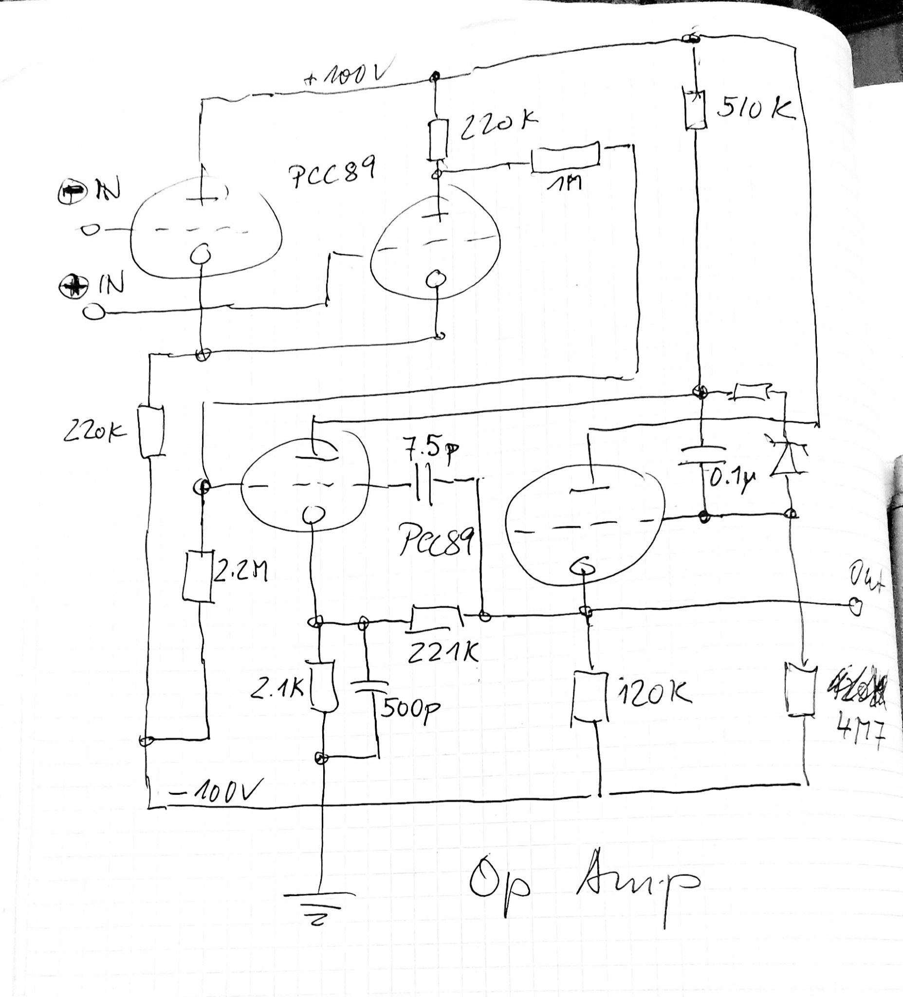

I comment, can't edit.And here the second part, the opamp itself. Simplified and direct related to a well known, proven design, known as philbrick opamp.
The original Philbrick design was very, very slow. Just because they tried to get high gain, they lowered currents and used high values for resistors. The gain bandwidth product was 100 kHz, which I will improve a lot. The circuit itself will allow this.

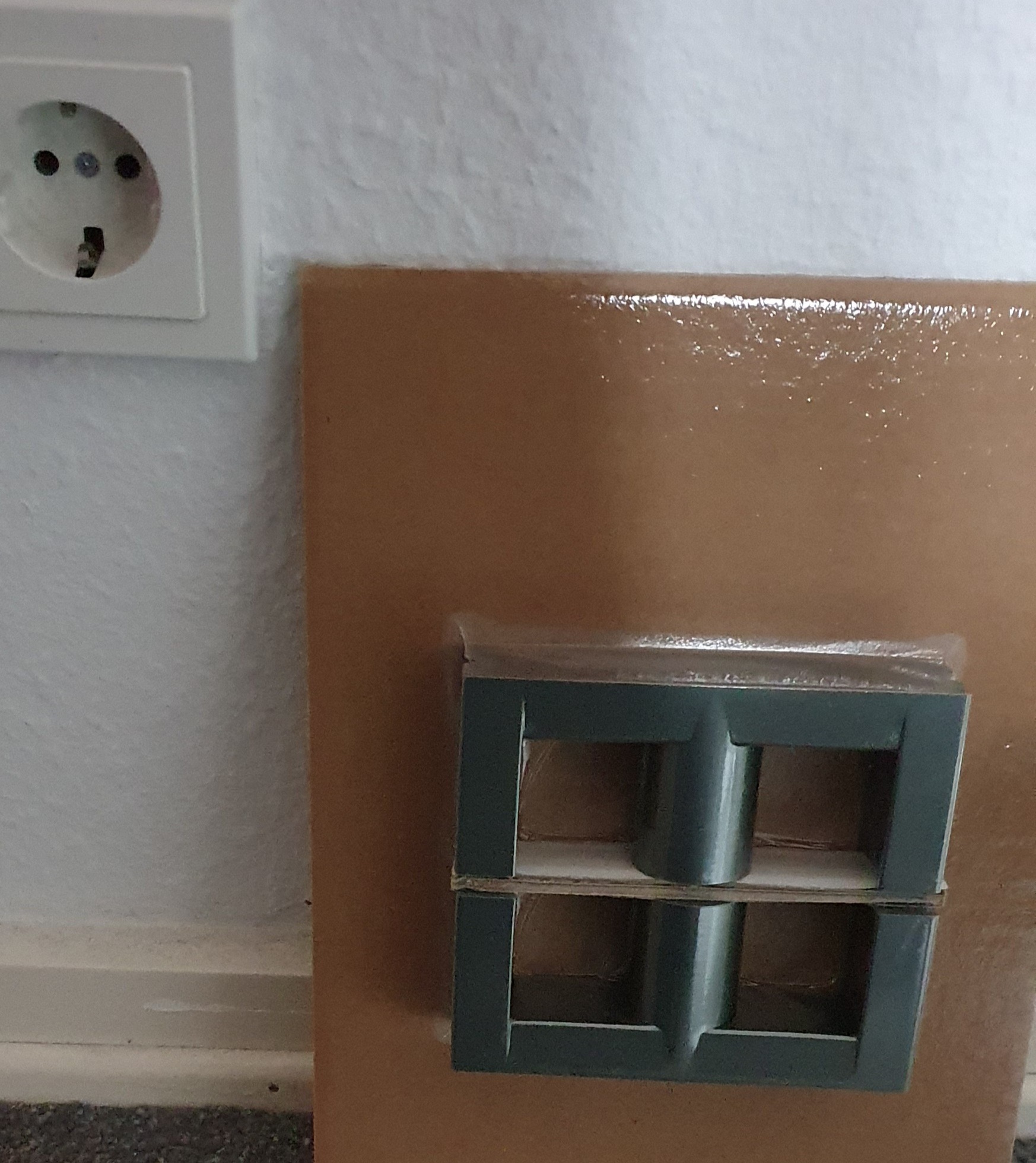

Today, the ferroxcube EC 102 cores arrived, which shall be heart of the tube class D amp.
Below is a photo, where you can see the dimensions. I am sure, this core is bigger then needed.
But capabilities must be there, while the entire project is of crazy dimensions and art of engineering. The making of, what is possible with tubes, is the target.
These cores are a standard component of electronic converters DC to AC in order to feed the AC lines with solar or wind energy. Swich Mode of course. The cores allow 100 kHz PWM, without significant losses at some 10kW.
The choice was done for easier design, less limits and to keep line at my understanding of technical artwork and beauty.
As size reference, there is a wall plug.
Remember, there will be 2 sets for one channel.
4 tubes GU50 will drive this couple.

Hello ,i see a problem with upper circuit . Lets say upper transformer produces positive voltage through upper diode ,but it will be shorted by another diode and output winding of bottom transformer. You need to design another method for output converting i think .Preprocess Audio to 2 PWM paths

Hello ximicas,Hello ,i see a problem with upper circuit . Lets say upper transformer produces positive voltage through upper diode ,but it will be shorted by another diode and output winding of bottom transformer. You need to design another method for output converting i think .
I see, what you see. I understand the problem and will invest time to solve that. I am pretty sure to find a way to keep the concept.
Thanks for pointing me to such a basic, simple mistake! I will come up with a solution soon!
