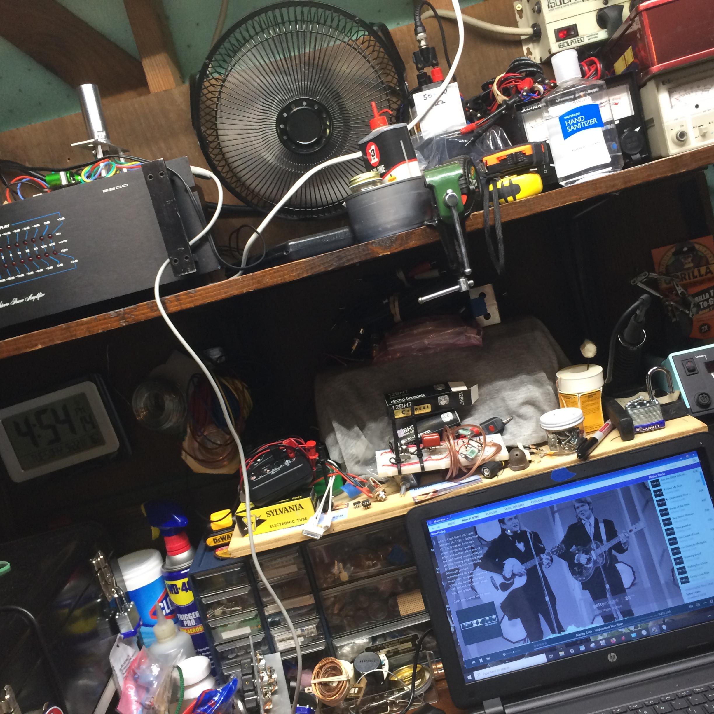

Tubes in an opamp feedback loop?

irfp240, irf240 outputs require NFB or 2A bias to eliminate crossover distortion. amplify the triode section with an NFB SS amp configured for unity gain.
Either discrete or opamp circuit the -3 to -.5 bias voltage does not cross zero.
The discrete tube/ss unity buffer is always in class A mode.
We cannot see inside the opamps but if always operating minus V then the opamp is probably operating in class B totem output.
