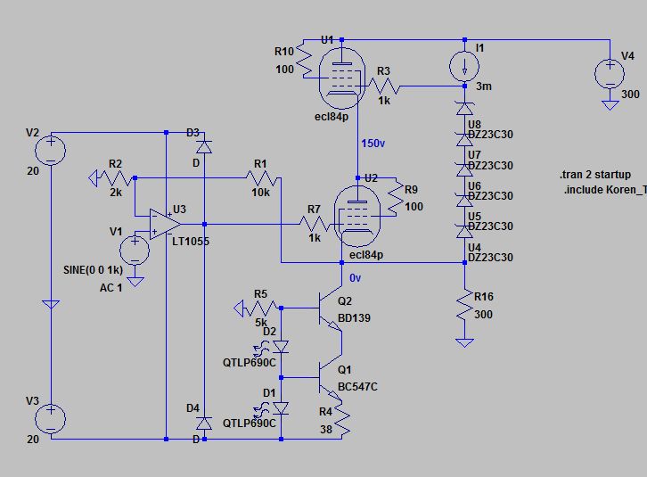

Tubes in an opamp feedback loop?
Disclaimer 1: I'm posting this in the tubes forum because I doubt it would receive much attention in the headphones forum (seems mostly ss over there). Sorry if it was a mistake.
Disclaimer 2: it involves opamps, don't :whip: me.

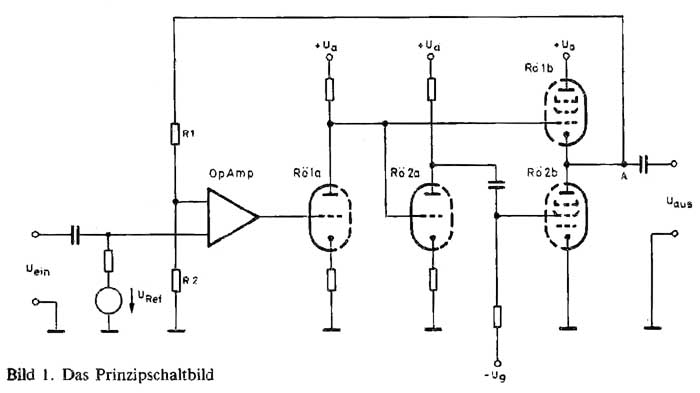

This said, I once had a nice headphones amplifier which made use of the following topology:
353077d1370560011-tubes-opamp-feedback-loop-prinzip-jpg
It was a kit by Helmut Becker from Audiovalve (see details here: PCL805-Roehren-Kopfhoererverstaerker_von_Helmut_Becker).
Of course, I could just clone it, I've got all the information needed. But it was in fact more powerful than needed (especially for the hd650 I've got now) and I was wondering if a simpler version couldn't be made, using ecl84 rather than ecl85.
Here are two ideas (see attached pics). They are determined by what I've got on hand (a good 300Vdc supply, a quad of ecl84) and the schematics are just concepts (lacking dc protection and the like).
The first one uses three supply (-20/+20/+300), is dc-coupled (which is stupid... output caps might be safer) and uses a cascoded cathode follower inside the opamp feedback loop. About 25ma standing current.
The second one uses a White cathode follower output inside an opamp feedback loop. Which means input and output caps and a floating PS for the opamp. Same standing current but can deliver a lot more current into the load.
Any of these looking like a worthwhile summer project ?

Done right, it should work. But... May I ask why?
By the way, compensation will probably be a nightmare. You've got a good chance of making an oscillator with that circuit. That's not to say that it will oscillate, but be sure to check for parasitic oscillations.
Ever since the original article was published in the German ELRAD magazine in 1984, I've always been scratching my head why one would need an output power of about 5 watts into his 600 ohms headphones :scratch1:
Nevertheless, Helmut Becker/Audiovalve appeared to be quite successful in marketing this amplifier as a complete built as well as a construction kit in those days.

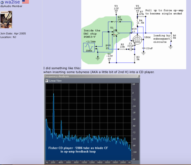

Should have made clear I was asking about the valve placement in feedback loop.wa2ise put it in the loop return to +input. It's of course in current mode. The opamp output is *the* output. I've been using a CF output ( fb loop) and buffering with another stage. Two very different ways of using tube in fb loop.
And other question is about the 47k, is it really working?
The power level not an issue for me.

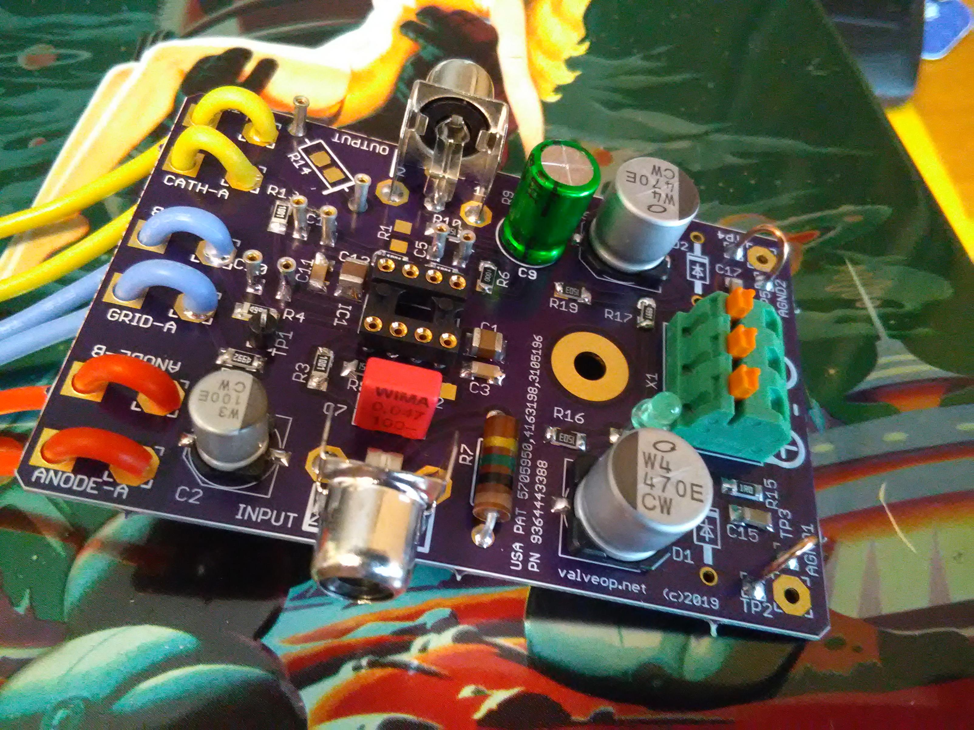

Test board stuffed and tested, going to try a nlr non-linear resistor. I have some, not mov or varistor or log semi diode etc. The non linearity is sort of programmable using dc bias.
A better name would be asymmetrical resistor. NLR sounds like non linear but symmetrical. If it looks promising going to add a .1" sip for potted device.

A vacuum tube in an NFB loop will give you the *opposite* result of what you are seeking, since the Op Amp will try HARD to compensate for it, so if you want to add "tubyness" it´s not the way.
I first found that, repairing Guitar oriented Ada Microtube Guitar amplifiers: basically a normal SS power amp (there were Bipolar versions, this one, and ADA Micro Fet , with MosFet outputs) which included a 12AX7 half inside the loop.
I was baffled because when I found the output clipped like a regular SS amp, flat top and all, I scoped tube plate to find what it was actually contributing and to my amazement found a "tit" or "nipple" shaped waveform instead of the smoothly rounded one I expected. WTF?
Until I realized that NFB tried to compensate for power transistor nonlinearity (which was starting to clip) and applied exact opposite error correcting signal.
Basic NFB behaviour.
IF you want tubyness, best is to use tube "raw", no correction applied, so you let it display all its glorious "flaws" ... and then faithfully amplify that.

That must have been your Eureka! moment! But yes you are absolutely right, including the tit on the anode voltage.
Jan
In looking at many op-amps , above 5vac out third and fifth harmonic visible then at 6-7vac they are extremely high. That must be why the op-amp line outs from 90s never exceeded specify 5vac. But I've already taken it into consideration with a simple compressor. So the tit never shows. From 0-5vac can't see second,third or fifth. 130db range.
