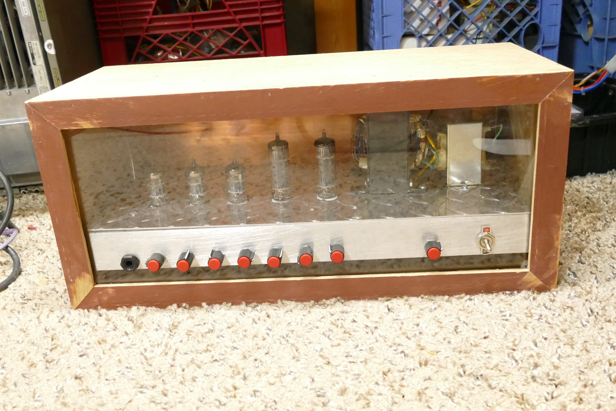

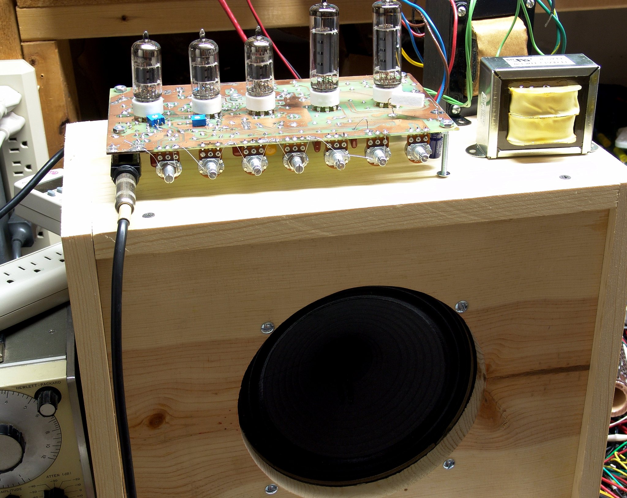

Back during the Hundred Buck Amp Challenge I knocked together a simple open back speaker cabinet with an 8 inch Jensen guitar speaker. It was used for comparative amp testing during the challenge and for casual guitar playing at bedroom friendly volume levels. When I had to leave Florida permanently on 3 weeks notice, the cabinet went into the trash and the speaker driver went into a box full of oddball speaker drivers and other "woodshop" stuff. The amp board seen on top of it survived the trip and is now in a cabinet and operational.
Last winter Sherri and I got a bunch of wood at a discount when a local "home improvement" store decided to clean out all the ugly stuff left in their bins. We used it to build the "wall of sounds" There was a considerable pile of lumber left from that project. Yesterday was a sunny day with the temperature hovering around 45 degrees F without the crazy wind we have had.......table saw time!
I decided to make a cabinet with some of the leftover wood that was similar to the discarded HBAC cabinet, but just big enough to house both a 12 inch Eminence guitar speaker and a 5 inch Jensen MOD speaker. I mocked it up in Visio, drew up a cut sheet list, and hit the saw. Unfortunately, when I brought the cut wood into the basement and began to arrange the stuff on the work table the speakers would not fit. It seems that all my cut wood pieces were about an inch too short. WTF? Could there be something wrong with my measurements?

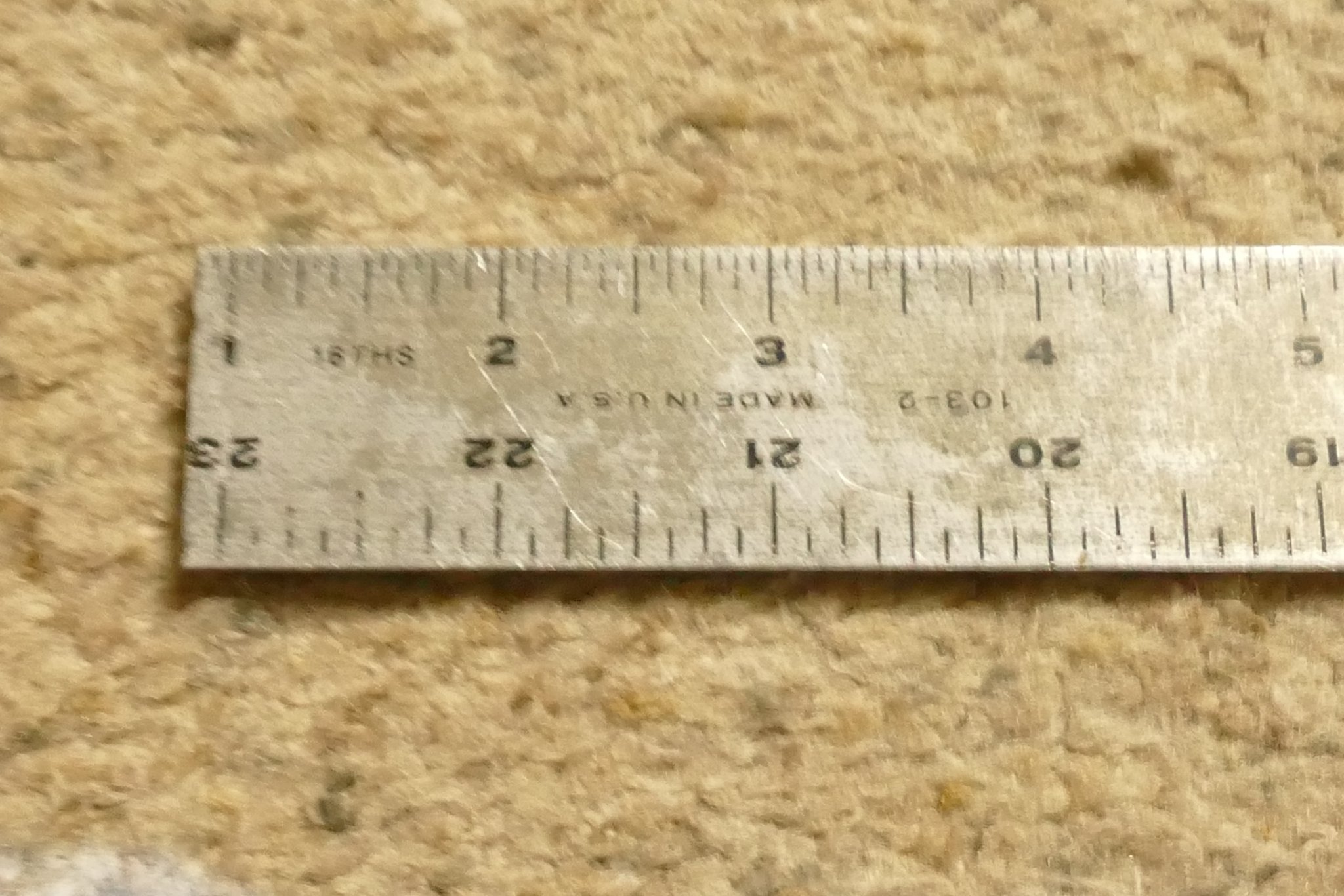

My 2 foot long ruler came out of the box full of oddball speaker drivers and guitar parts that had not been opened since I went to a weekly wood shop class in Florida over 10 years ago. I vaguely remember an incident with the metal shear..... I guess I'll be back at the saw today. I did find the body of the DIY guitar I made in that class along with a few other DIY guitar bodies. The neck is still MIA, but there is another box marked "woodshop guitar parts."
I may complete the "screw-up" box build any way and reuse the 8 inch Jensen, or some other drivers that I have.

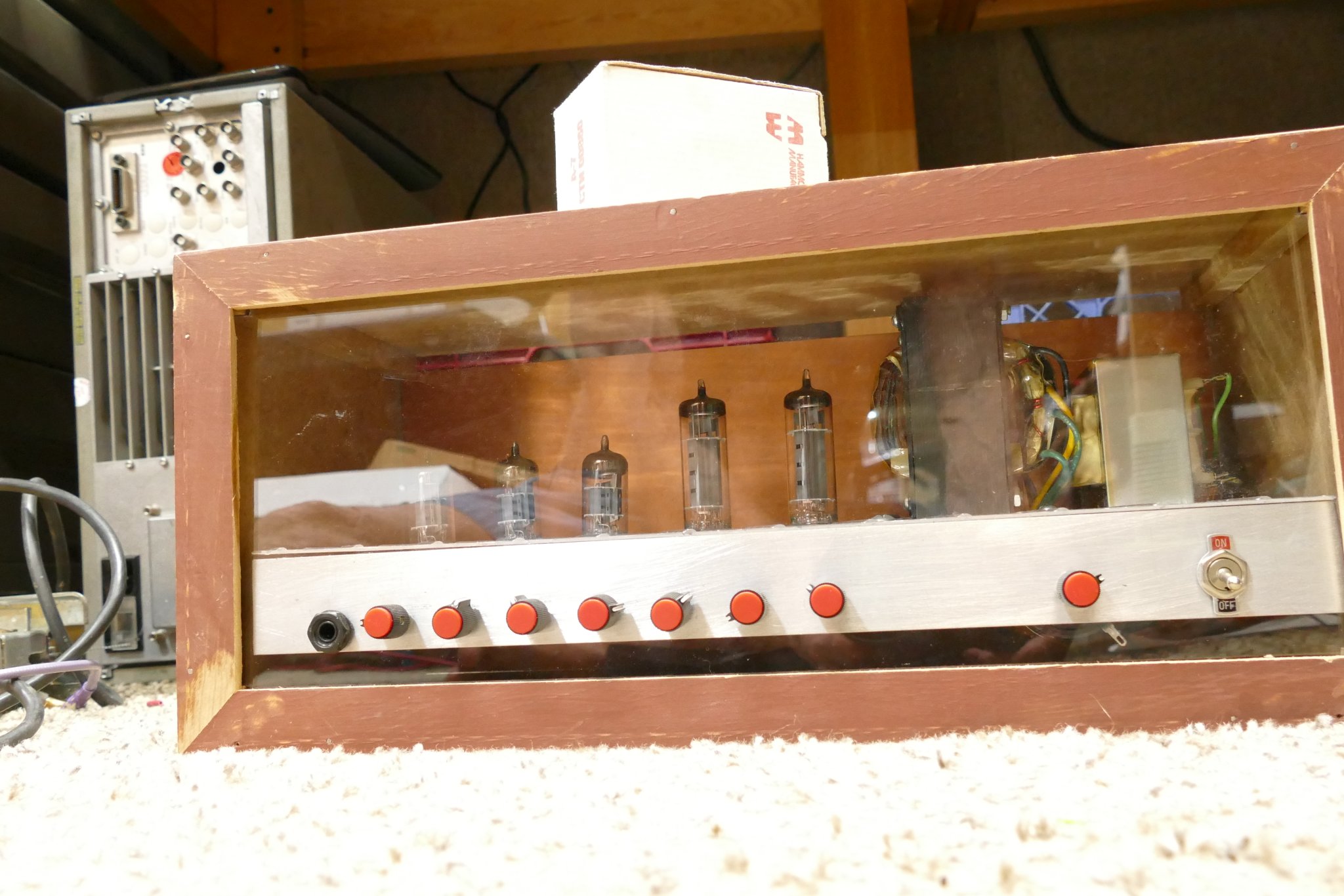

My first inclination was to destroy it, but it was stronger than I am, but it was a bit bent out of shape when it went into the trash bag.
Tone test already lives in a box. I had forgotten all about the tone test board which was built for the Hundred Buck Amp Challenge back in mid 2011. Turns out that I liked it enough back then to make a box for it. All that stuff got shoved into boxes when we had to get out of the house we lived in for 37 years on three weeks notice. The amp is now alive, and since Parts Express is having a 14% off sale that ends today,, I ordered a couple cheap speakers and some black Duratex speaker cabinet paint. Tone test will have a fresh coat of paint on that ugly box. I cut a lot of wood today. There may or may not be one or two new guitar speaker cabinets in my future, depending on how much I screwed up.

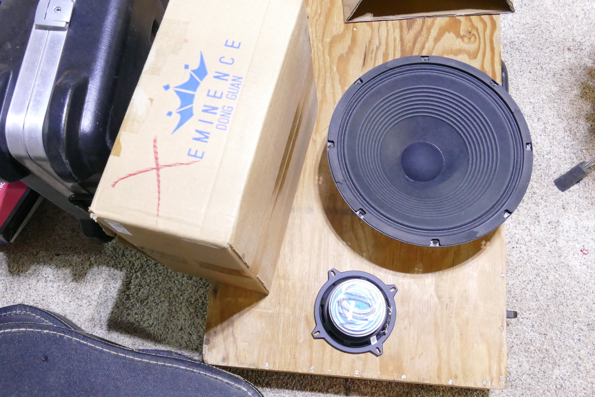

The speakers containing a pair of 6 inch drivers and a bullet tweater (disabled for guitar use) seen in the third picture in post #36 are Dayton PA165's. I built those cabinets 10 to 12 years ago and coated them in Duratex which has held up well. The drivers are Dayton PA165's and they have also eaten everything I throw at them, including rock group PA duty being fed with a 125 WPC version of Pete Milletts big red board. PE had a "restocked" PA 165 for $17, so hopefully it works.
Now that I have glued up the front baffle boards for two cabinets, it looks like a single 12 inch speaker will fit the "screw-up" cabinet and I have a pair of 12 inch Eminences that have been in their boxes for over 10 years. a single 12 inch guitar speaker, or the 10 inch and 6 inch pair that I will have when the USPS brings them. I need to look at the pile of leftover wood to see what's left, and what I can make with the remains, but the weather rules out table saw time for tomorrow. I use a folding job site table saw on my driveway and it's 100% chance of rain for tomorrow. Decisions, decisions, decisions.

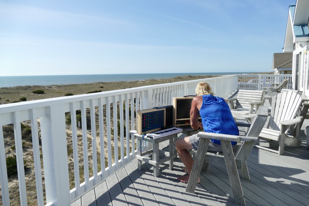

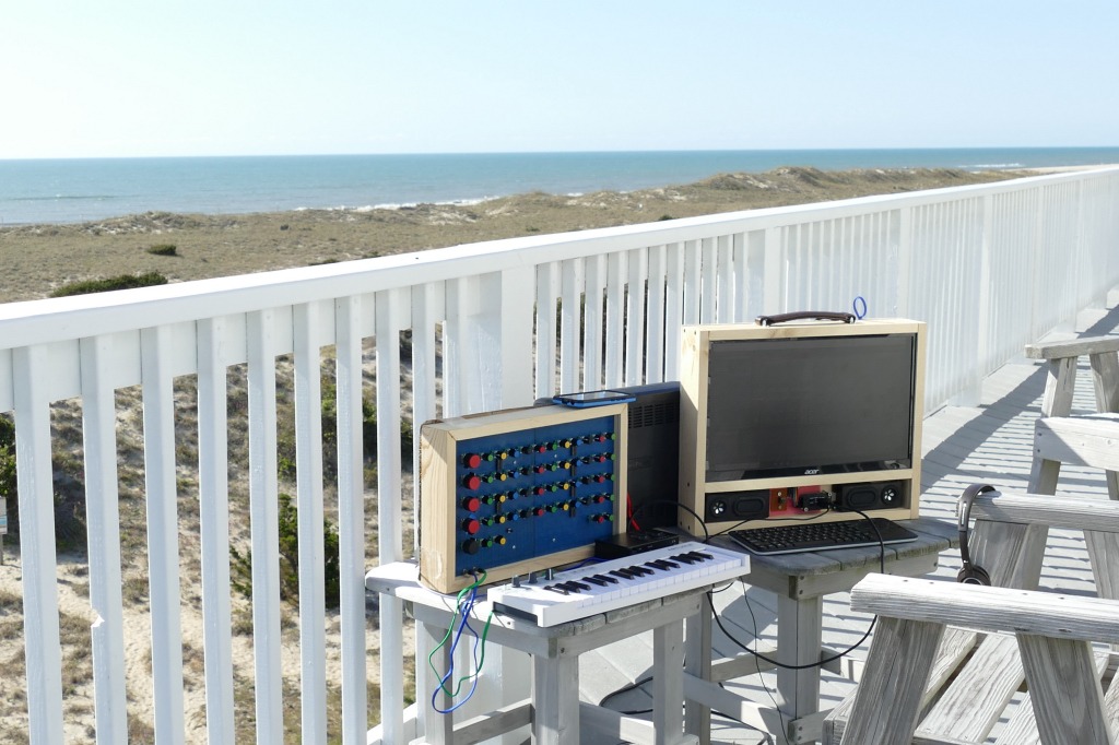

The picture shows something similar to, but much smaller than a rig that I built about six years ago. it's seen here on a vacation trip overlooking the Atlantic ocean and running on battery power, a rather heavy UPS. No wimpy Celeron chip in mine, I ran a Core i7-7700T (low power) CPU chip in a Mini ITX motherboard which fed a 19 inch 1920 X 1080 Dell monitor. Audio came from the motherboard outputs through a 10 WPC TI class D chipamp feeding speakers on the front of the unit. Audio input was done using a MOTU Micro Book II, which has a useful "guitar" input on the front as well as the typical XLR / 1/4 inch Mic jack. MIDI I/O was done in the Arturia Keystep which also does MIDI to CV/Gate to feed the virtual analog synth. The Core i7 CPU was powerful enough to run a serious DAW like Ableton live, or a virtual guitar rig like Overloud's TH-3. I dragged this thing around on several vacation trips for a couple of years.
A few years ago I got a laptop that was powerful enough to do the same stuff, so the "Box PC" was mined for parts. The nearly empty shell still resides under a workbench.

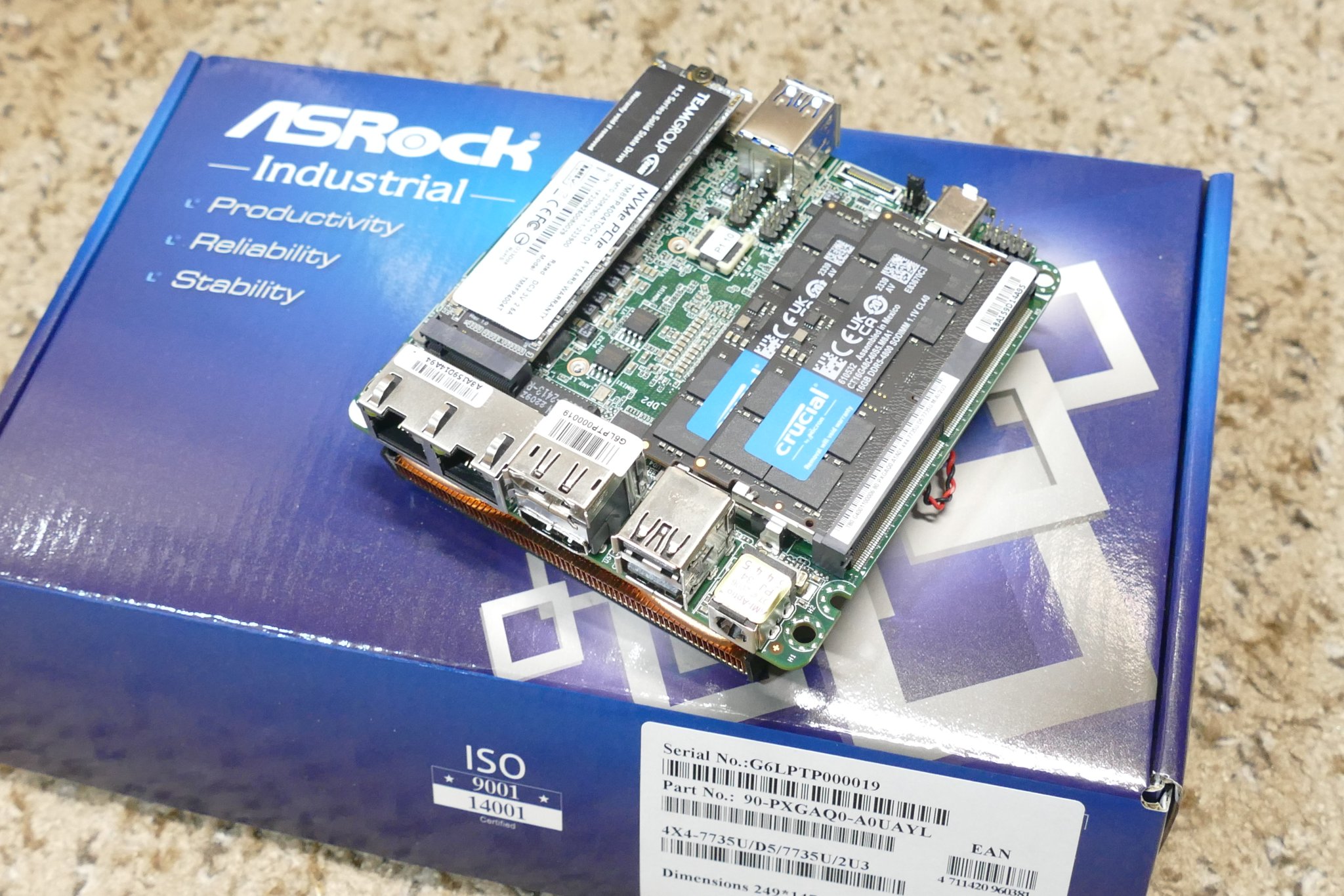

I used the word "again" in my first sentence. Why? Because Newegg decided to blow out their remaining stock of this AsRock Industrial motherboard with a Ryzen 7-7735 CPU installed for $150. I took that bait, installed a SSD that I robbed from another machine and some cheap Laptop memory from Amazon. This thing will run everything that I throw at it with a the exception of VCV Rack, the virtual modular synthesizer which requires a dedicated video card in the machine to avoid interrupt contention. VCV Rack does run good but I can't load a really complex patch without some occasional glitches. I did however load up TH-U and plugged in the MOTU and fed it's output to the same SPP board I have been using for some of these guitar amp experiments. It ROCKS and does 60's surf music pretty well too. I think that there will be another Box PC in my future, but it will be laid out differently and have a better audio and MIDI I/O, probably a Focusrite Scarlett 4i4, since there is one sitting idle on here at the moment.
https://www.newegg.com/asrock-industrial-4x4-7735u-d5/p/N82E16813301015

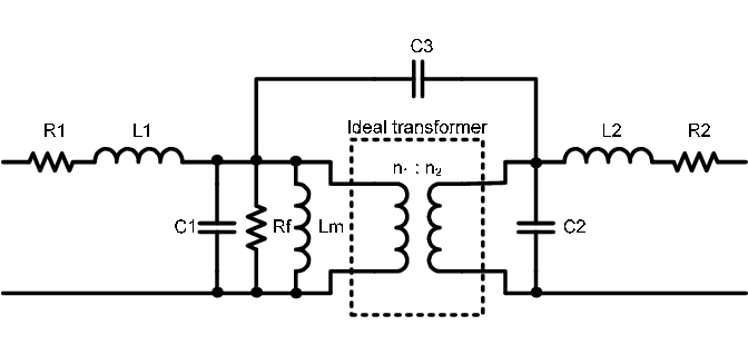

Edit: I forgot to mention how amusing that these software simulators seemingly have to begin to mix engineering and musicianship. "SchemAccurate" and such terms. I still take Dave Grohl's response to when he asked the designer of that board he pulled from Sound City "what makes it sound that way" as average.
Most musicians arent going to comprehend "leakage inductance"; heck I've never properly grasped that one and I'm an EE. Yet, the guy that deigned the board was explaining that property of the transformers he used is part of the board's sound. So maybe they'll have a leakage inductance property in the output transformer of a schematic based amp simulation one day, if not already.
Leakage inductance in lumped equivalent transformer models has been there for ages. It represents the flux which is not mutually linked through both the primary and secondary windings. The linked flux gives rise to the magnetizing/mutual inductance. In the lumped equivalent model below L1 is the primary leakage inductance, and Lm is the magnetizing/mutual inductance. L2 is the secondary leakage inductance.So maybe they'll have a leakage inductance property in the output transformer of a schematic based amp simulation one day, if not already.
Thanks Mark. How that relates to the sound of a channel using transformer coupling? Apparently whatever it does is a desired effect.It represents the flux which is not mutually linked through both the primary and secondary windings.
I suppose the schematic Mark posted could be made available to a user of such a schematic based simulation. With the "wild" limits on component values to give sounds perhaps not possible using real hardware components.He meant the simulator inside a schematic modelling guitar amp.
Some of the leakage flux passes through some of the iron in the core and some of it passes though surrounding air and other materials. It acts more like an typical inductor, but it may have some of iron sound of core (hysteresis distortion, B-H nonlinearity, eddy losses, etc.).
