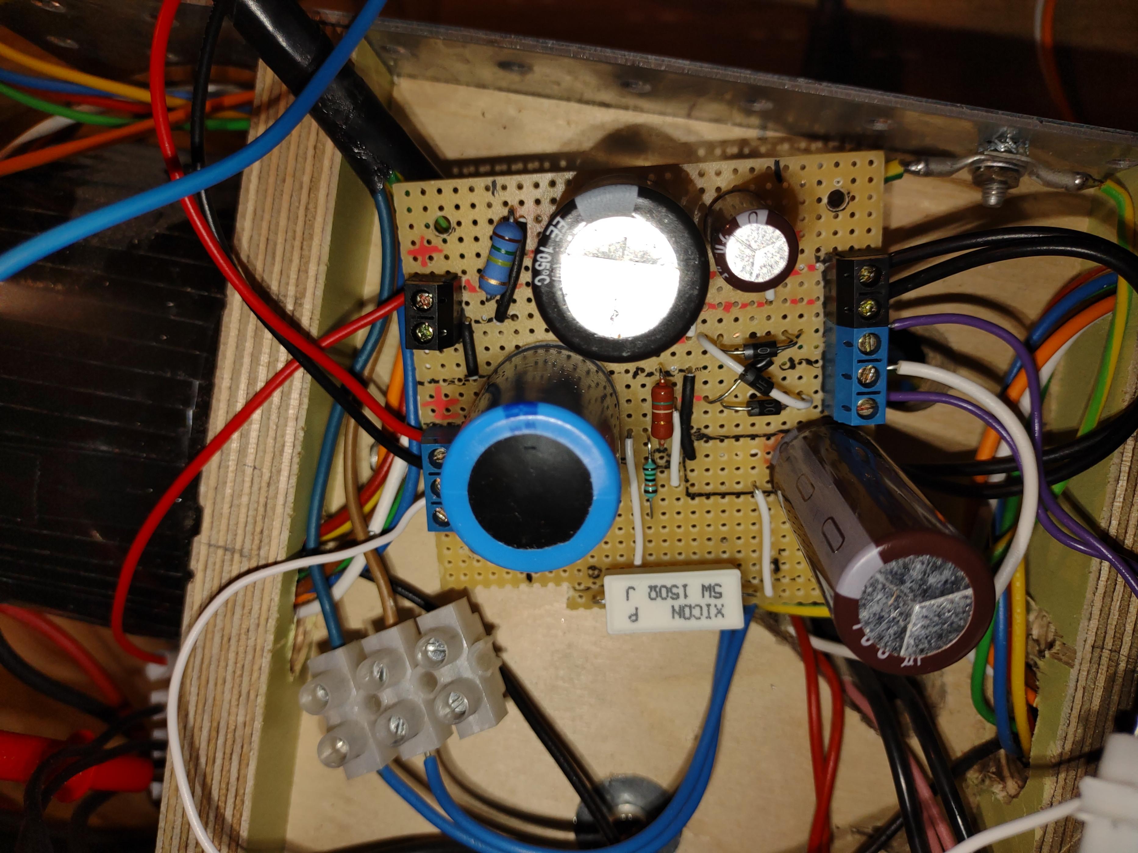

The power supply has been adapted, and the voltages are as predicted, so that is a step forward. The plate voltage on the PL84 is still 216V, and now the ECC81 B+ is 275V, the plate has increased by 30%, 175V and 95v on the two anodes. I think this has filled out the sound a bit.
The next step is connecting the feedback. I tried a 5.1K resistor in series with a 390pF for starters, similar to the standard SPP, but I ended up with a mild hum, scratchy volume control, and some sort of crackling, or oscillation. The scratchy volume control is a sign of some grid voltage, so that probably means I need to calculate the resistor value a bit more smartly.
I am fairly confident it is not the wiring of the OPT - I have experienced the howling that can result from the OPT being wired out of phase, and it is not that type of noise.
Getting closer!
I could not get the feedback to work at all with the normal FB resistor value (5.1k). I'm a long way from understanding this. The FB resistor injects a proportion of the AC voltage from output signal to the cathode of the driver, and I would have thought that the ratio was related to the operating point of the driver tube and the output to the loudspeaker, which in my build should be more or less the same as a standard SPP.
In the end I used a 100k potentiometer and selected a point where the sound seemed nicest. This turned out to be around 43k, so I ended up fitting a 47k resistor just so I can move on to another project, and enjoy using the amp in the mean time.
The sound now does feel more precise, crisper, and the range is bit fuller, but it feels a little bit like designing using chicken entrails; it would have been nice to have been able to derive a value by simulation or calculation. Not having my oscilloscope does hamper things a bit.
I have a 490pF mica capacitor to fit at some point, but I wanted to listen to a variety of stuff first before trying that.

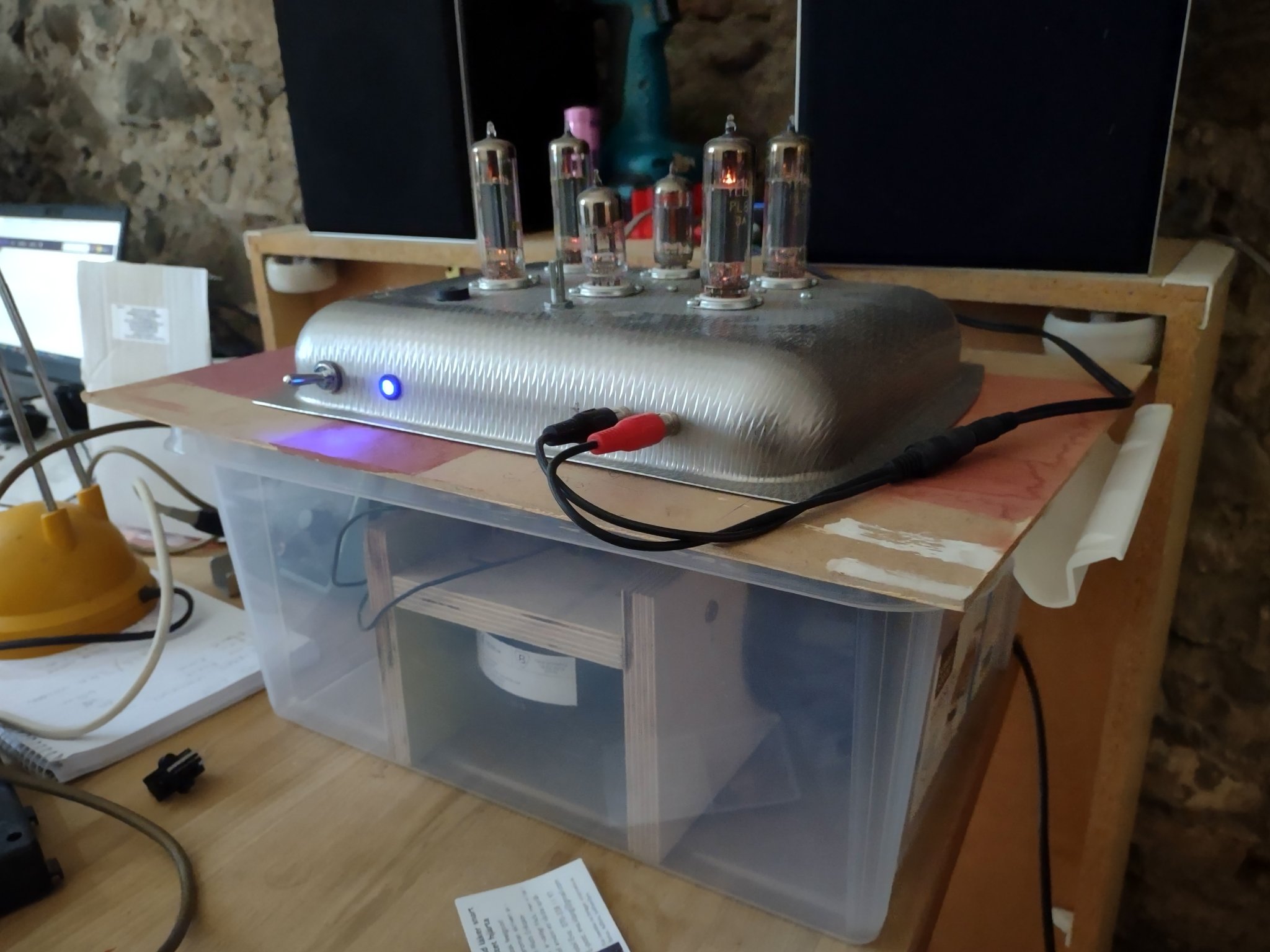

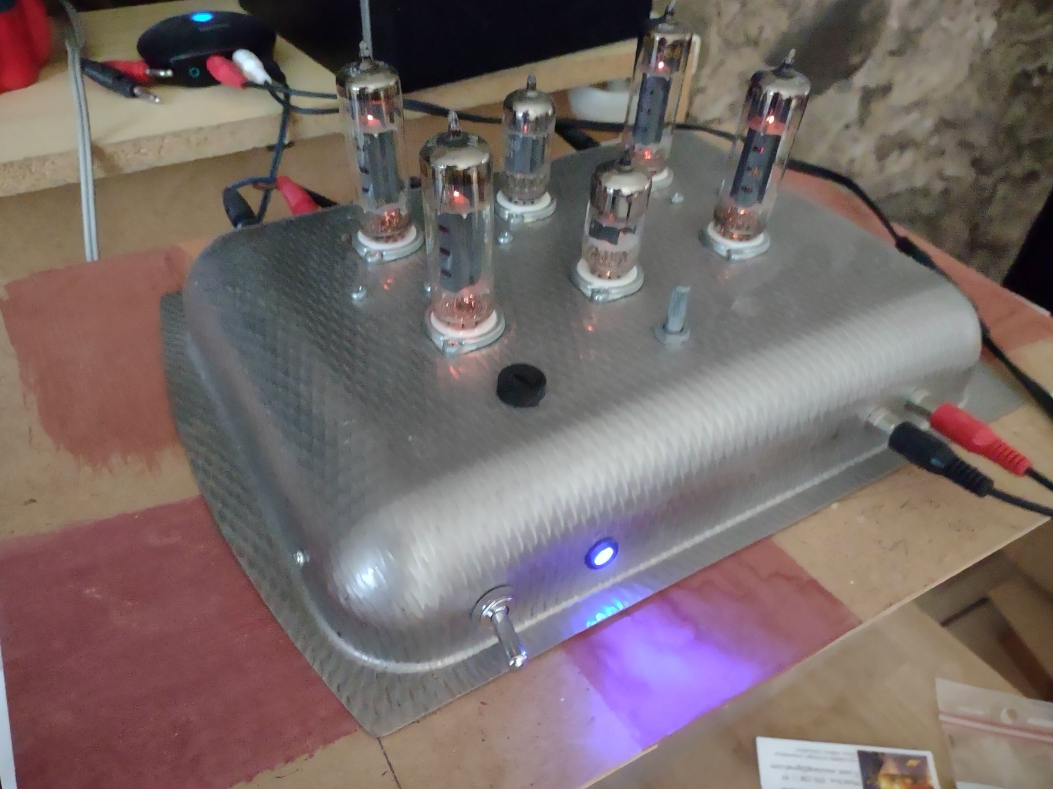

Here it is in all of its glory, and it is now used daily and I am very pleased with it. As you can see the box leaves a lot to be desired, but the high voltage stuff is safely contained, and it fits nicely next to my desk so I can listen via bluetooth during the day.
I could not get the NFB to work properly with the suggested resistor, so in the end I added a 100k pot temporarily, and since I did not have an oscilloscope here (I am working abroad for a while) I adjusted it by ear. I think it is around 40k if I remember correctly. (I can check later).
I think if I was going to start it over again I would have another solution for the power supply, although the circuit I have used does seem to work fine. Perhaps there should be a bit higher B+ than I have for the driver/splitter - I would really ave liked to match the settings in a standard SPP.
The EL86/PL84 requires a bit more drive than an EL84, so I think if I was to take another look at it I would see how to increase the drive signal. It is loud enough for my speakers and appartment, but the overall volume is less than it could be.
Interestingly, I looked at a data sheet for EL86 and came up with this one ...
EL86 frank.pocnet
... where there are figures quoted for 250V A and G2 - so I am fairly sure there are some differences between PL84 and EL86, where not all PL84s are as strong as EL86s, although they share characteristics up to 200V.
I built my version point-to-point, because I wanted the experience ad I had an SPP with EL84s as a reference. Looking at the SPP PCB, it is not too difficult to adapt it so that it satisfies both designs, assuming the operating points need to be adjusted.
Ideally:
  1. Seperate heater supplies for 12AT7 and output tubes. That way PL84s can be used which make for a cheap amp (apart from the OPTs).
  2. Split the B+ for output tubes and driver/splitter (it is just one track I think).
  3. I used a 1k screen grid resistor for the PL84, but that was because my OPTs were UL, and was before I had rejigged the power supply. I should perhaps look to reduce that since it could create distortion. With 200V B+ I don't think the screen dissipation is likely to be an issue now (before I had glowing screens and red plates).
  4. Would be interested if you have any thoughts on the driver and splitter operating points. I did simulate what I have so I could experiment with different options, but I don't think I changed anything apart fron the cathode and screen resistors on the output tubes, and the feedback one.
Cheers, Richard

That’s the best kind of amplifier! One the fits where you would like it and could be used all day, every day. Your cake pan chassis looks kind of cute!
Thanks for your nice overview and very useful suggestions of how you would do it if you were doing it over again. That will be very helpful when I start building. I forgot to mention my Za-a = 3400 Output transformers do not have a UL tap, so it it will be easier with my adjustable screen regulator to tame the screen behavior of my EL86/xL84 tubes.
I will be using George’s SPP PCB, and I think all the changes I wanted to make are easily accomplished, including your points 1&2 above. My HV supply to the front 12AT7 will be about 320Vdc. I’m planning for B+ of 250 V and Screen supply of 200 V. The output stage is run with fixed bias in my mod, so almost the entire 250V will be across anode to cathode. We shall see if that works well; if not I will adapt. If you have the LTSpice ready to through these numbers in I shall appreciate it - I will keep the file as tutorial for my learning LTSpice.
