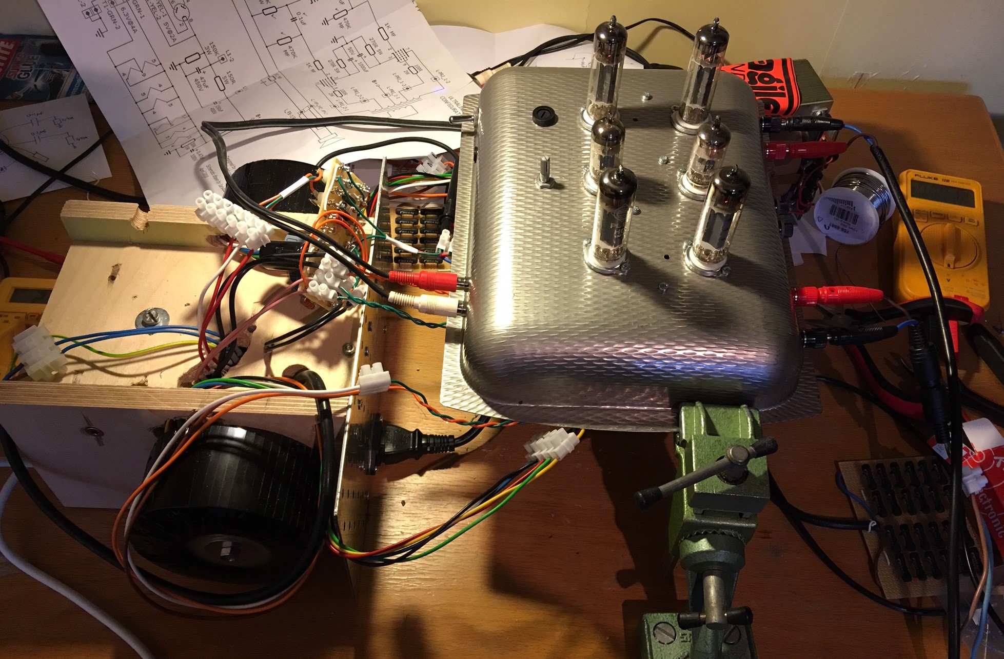

Thank you for the update. 🙂Thank you for you inquiry into my little experiment. Unfortunately I have not done the study of operating points for the EL86 tube yet.
I am simply seeing if an EL86 work, rather not red plate it.If I understand correctly you are looking for a more optimal operating point than what you have now.

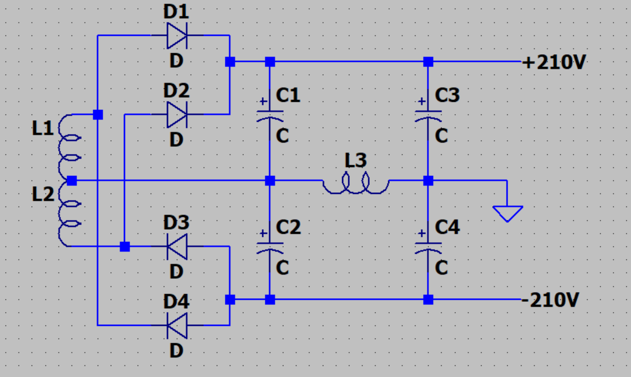

Richard been trying to get me to, but I been very stubborn about the lack of at least distortion figures (did ask) and fell in love with this Elektor Labs amp, which I modified. Still not bought components, getting generous amount of help on designing a power supply first. Plan is a 8k OPT with 43 percent UL.If you tell me more about your amp, B+ and output transformer (impedance, UL) I might be able to give you an opinion that might be helpful. You are using the Tubelab SPP PCB?
