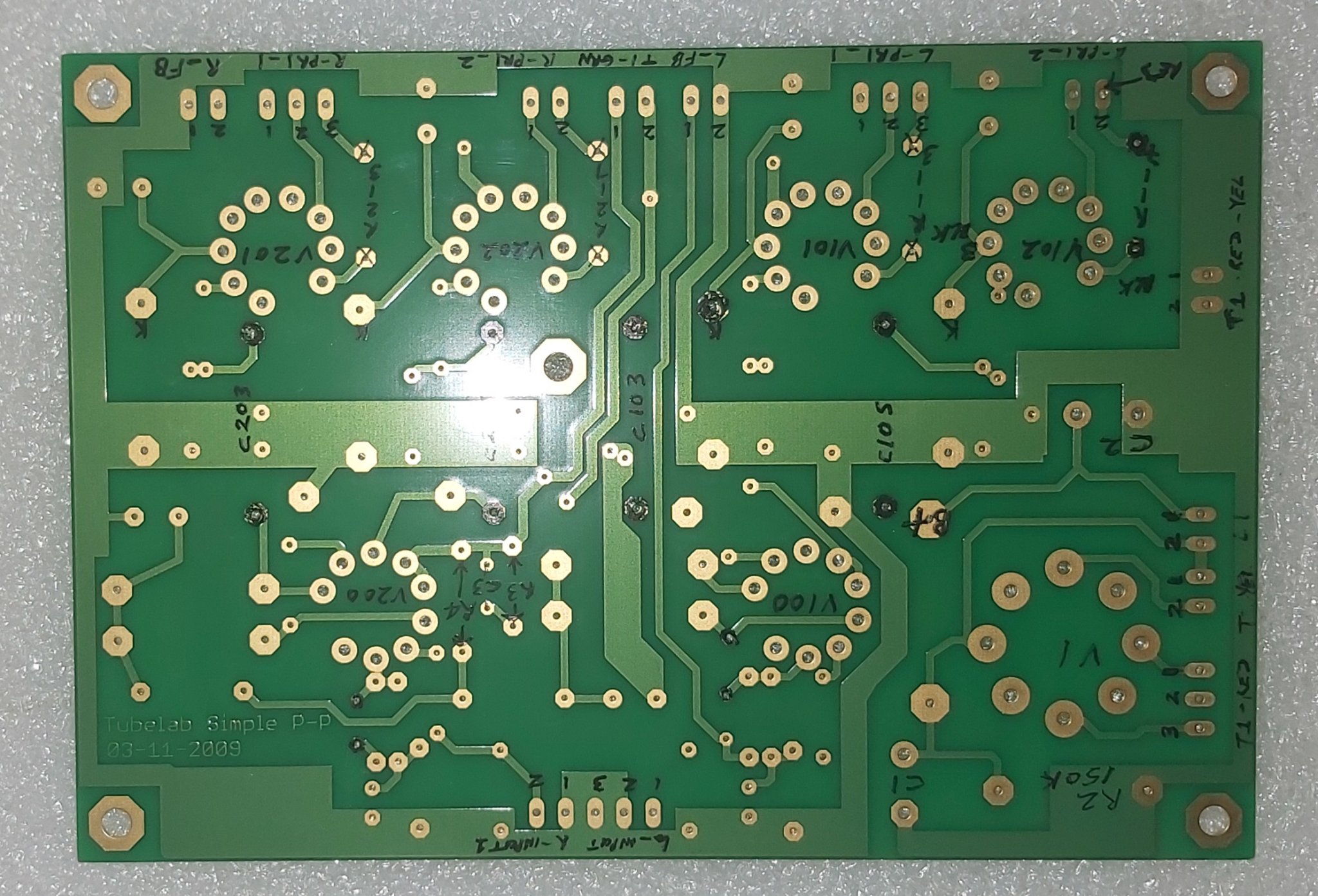

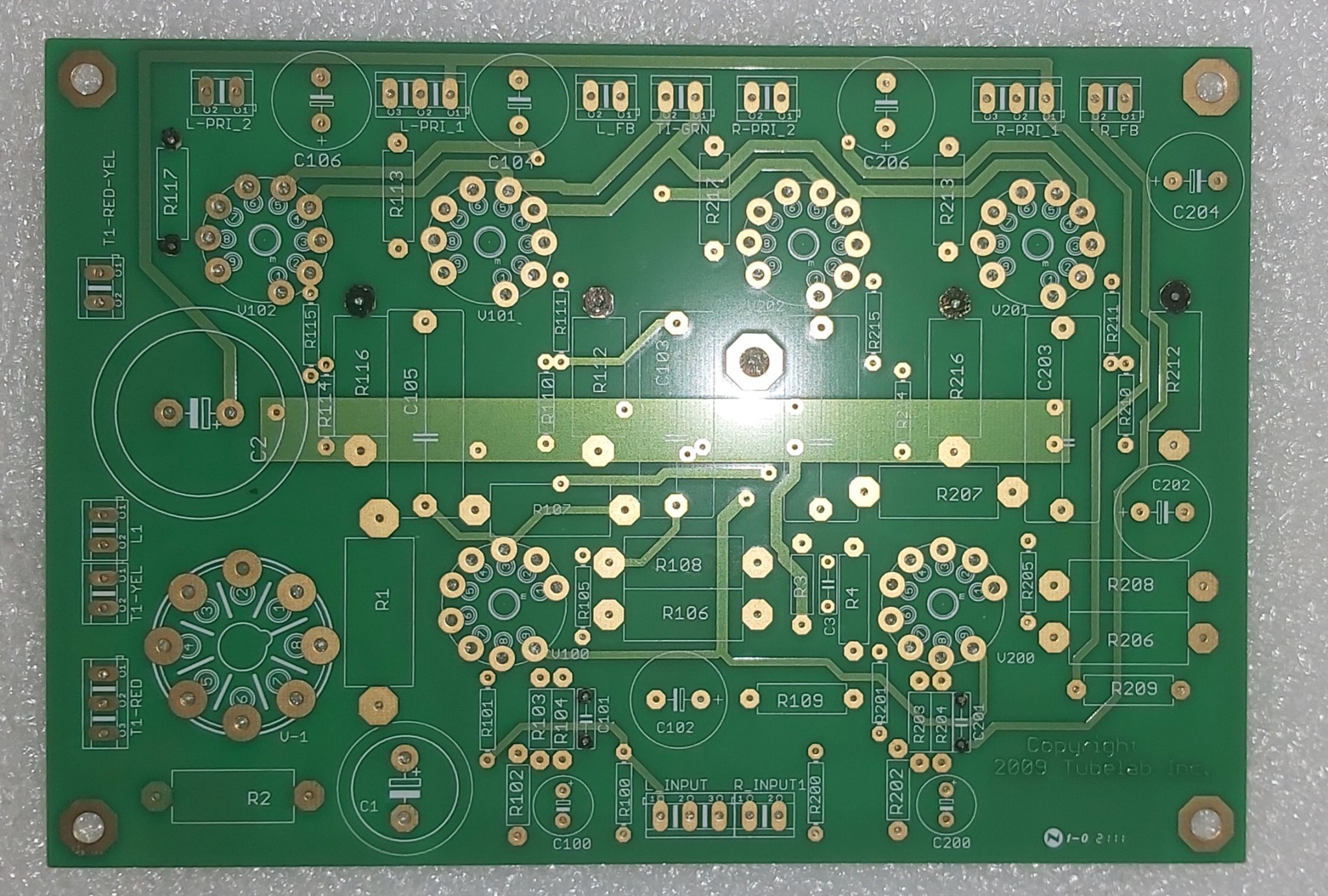

1 x Spare TubeLab SPP PCB.
Never used, only has black markings that can be easily wiped off

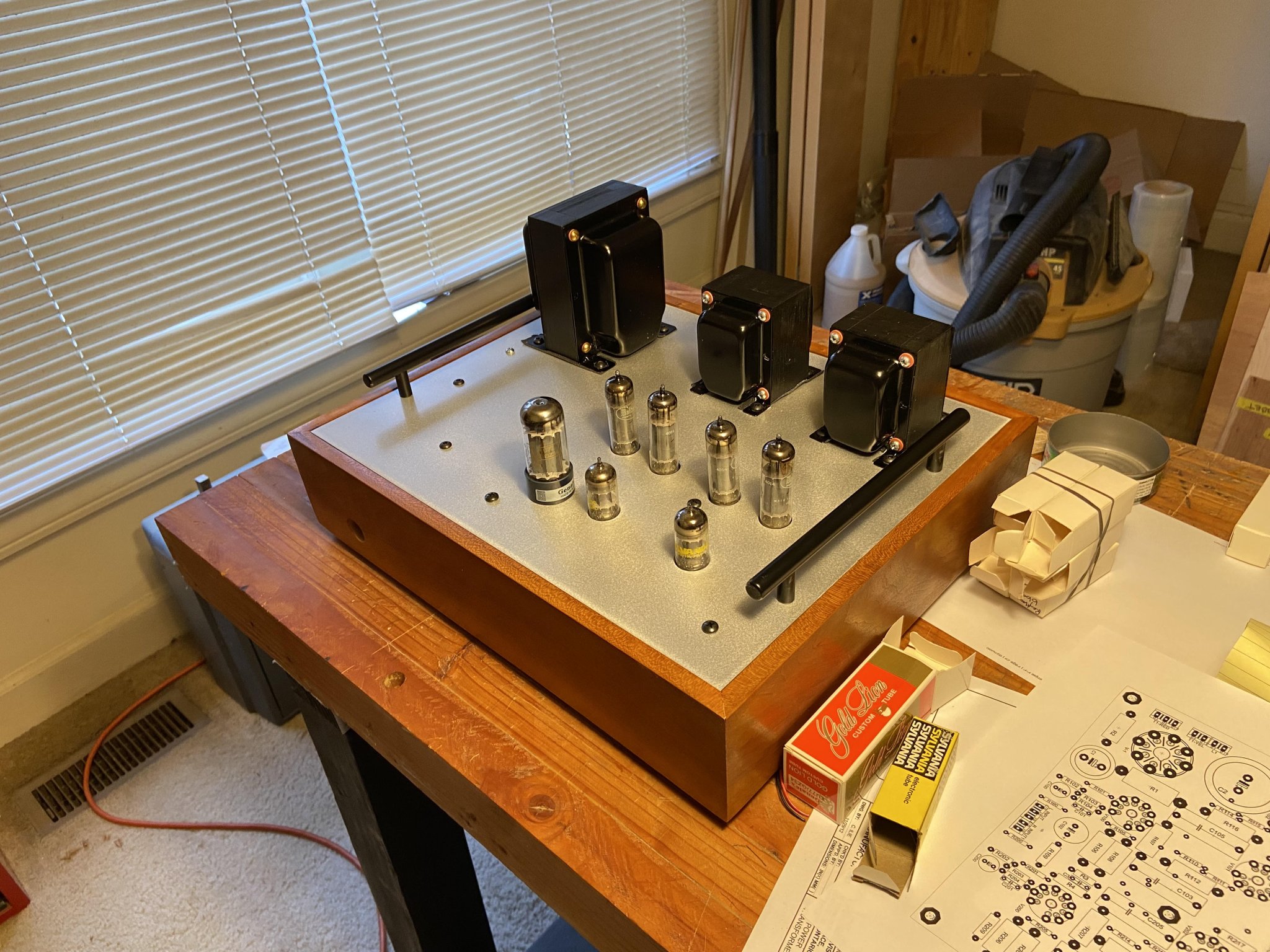

Hello Folks! I am wiring the SPP board and I have a couple of quick questions:
-the feedback connection from the 16ohm tap of the OPT, not the speaker 8 ohm tap, right? Its not specified on the schematic that is floating around.
-my power trans has 3x 6.3V 2.5A secondaries but the SPP takes a single 4A 6.3V, can I parallel the secondaries and feed it in like that? The secondaries should be very evenly matched in voltage.
thanks!

Well, things did not go super😢, one channel seems to work, the other starts to buzz as soon as the voltage gets over 300V (I connected some crap driver I have around).
Reading Steve's reply I have some suspicions that it is the feedback instability. I have 100pF cap in the feedback. I will take NFB that out after the break here. I measured a couple of things in between the two channels and everything checks out thus far. B+ is 331VDC with the two channel operational, I have to measure the bias current.
Yes, disconnect the FB from the OPTs. Put shorting plugs in the input. Measure voltages at identical points in both channels and compare. Check all of your solder joints., reflow any that look vaguely suspicious . Make sure you have connected the OPTs primaries to the correct terminals.
No joy, yet. The one channel starts to 'motor boat' at 300v B+ as I raise the voltage with variac. It happens with or without NFB onnected.
I checked all resistors and found no mistakes in the PCB the output tubes are biased correctly 33ma 330v B+. So the B+ works, the output tubes work. it produces sound. I ohmed out the OPT everything seems fine. I have swapped the input tube on the affected channel: nothing. I could swap the OPT but the dcr are the same so I don't see the value. I need to swap the output tubes just in case.
Nothing. Rechecked everything all resistors values, soldering joints, reconnected everything, replaced output tubes, the one channel is still motorboating above a certain voltage. It is making sound on both channels before that and one channel is quiet.
Will try swapping OPT but I am out of ideas.
Unbelievable! Found the problem! So embarassing. I had the feedback and the ground wiring swapped on one channel. 👎The labeling on the PCB is consistent throughout except for the o1 o2 swap on the last terminal block. I guess George wanted to make sure diyers are really paying attention and I wasn't ! 😎
