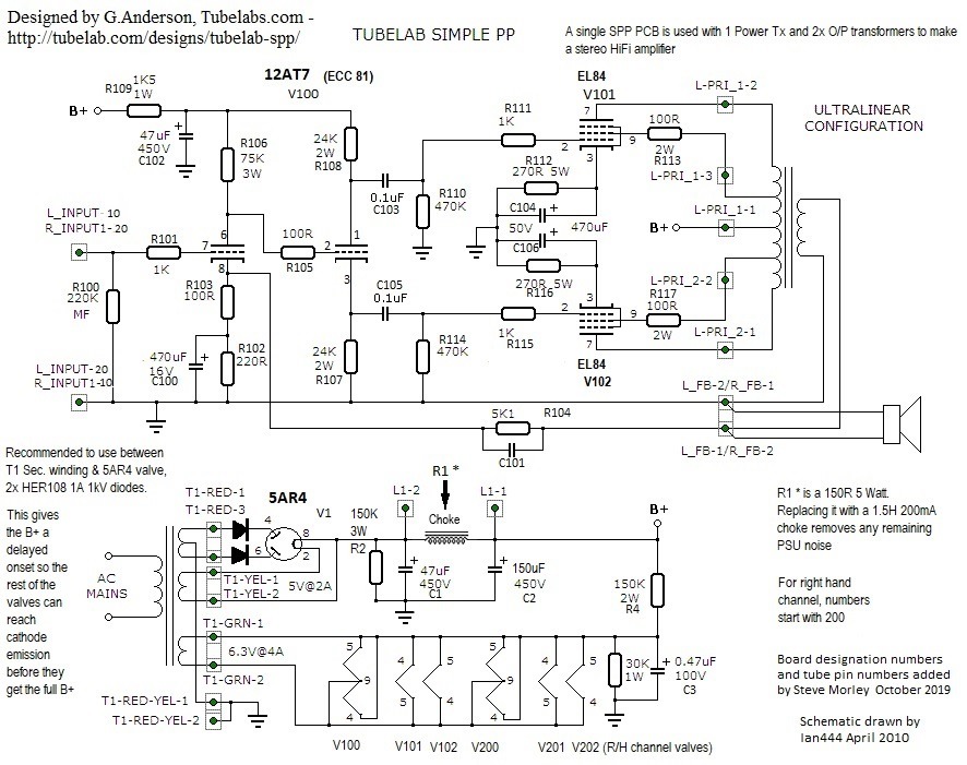

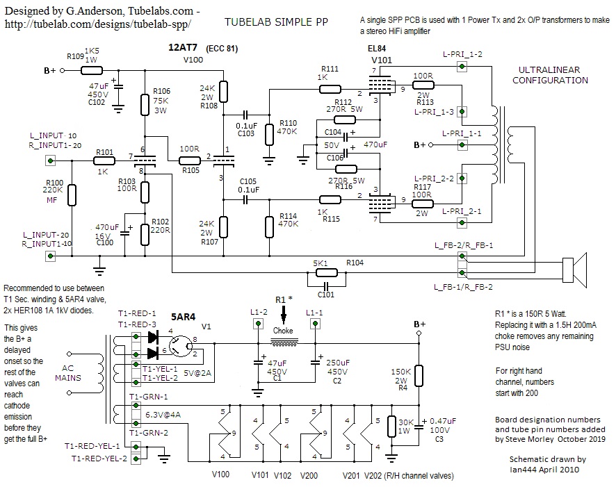

Just thought i'd post the Tubelab SSP schematic along with notes i've come across.
As we known if the Tubelab SPP pcb if to be used, and i'll probably take road now, it's for a stereo build.
i.e. One Mains Transformer and Two output transformers.
May i mention as George has done already in his web site, it is extremely important to read his complete write up about the build.

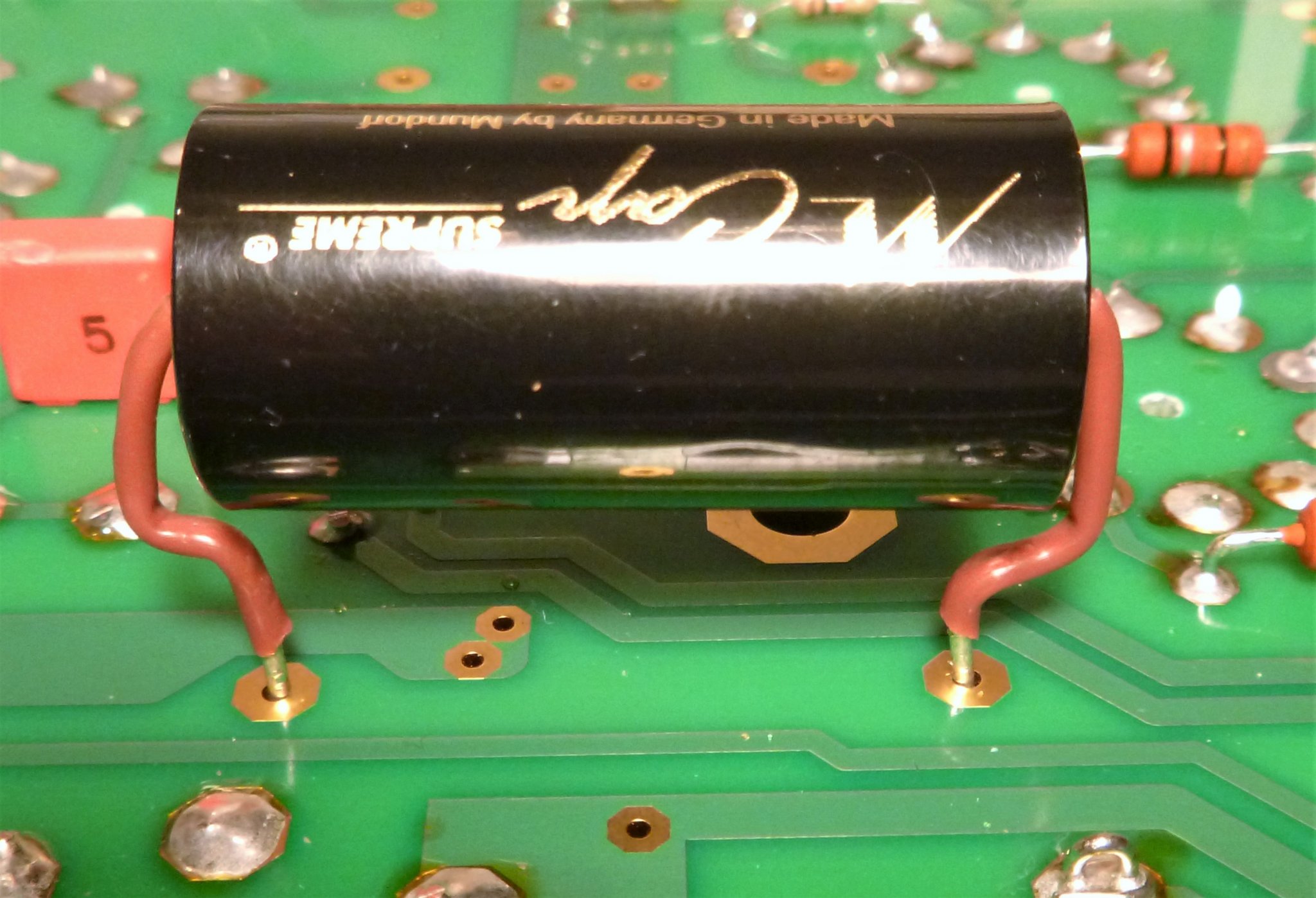

IIRC, the major things that George mentioned was that caps 103 and 105 could be upgraded and he suggested not cheaping-out but using decent OPTs right from the start. He suggested Auricaps as a possibility, if memory serves. As far as OPTs go, he wasn't suggesting the purchase of exotic mega-buck trannies, just not selecting too-small transformers that would inhibit power and bass extension. George please correct me if I'm wrong.
One of my builds used Cornell-Dublier 940C caps, the other used Mundorf Supremes, the basic, no fancy metals or oils variety, about 16 USD each. Both the C-Ds and the Mundorfs required some fancy lead bending.
The diodes shown before the rectifier were, I think, a John Broskie recommendation because modern GZ34s are not as rugged as tubes from the valve heyday. There isn't a place for the diodes on the board so you'd have to hack it.
If using the PS choke it actually connects to L1-1 and L1-2.

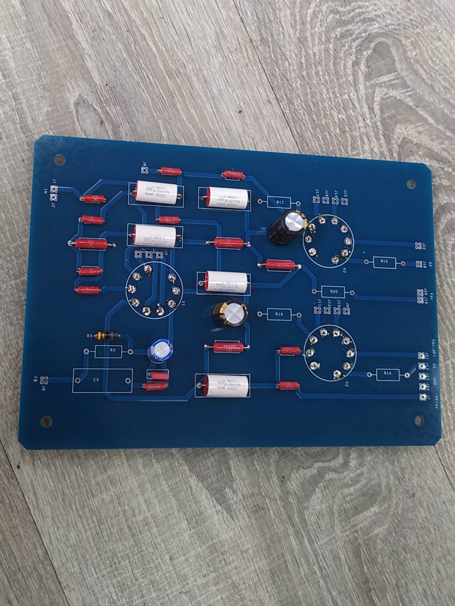

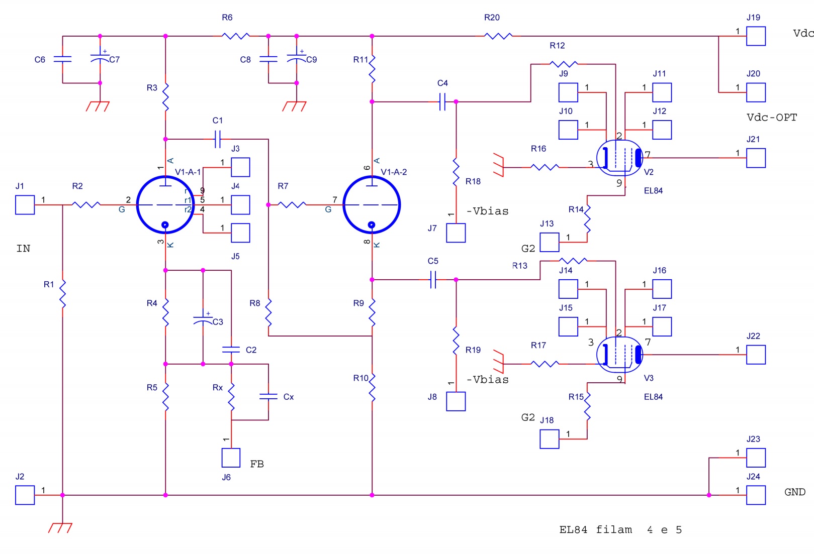

This is a pp the I made time ago with pcb
And the one finished.

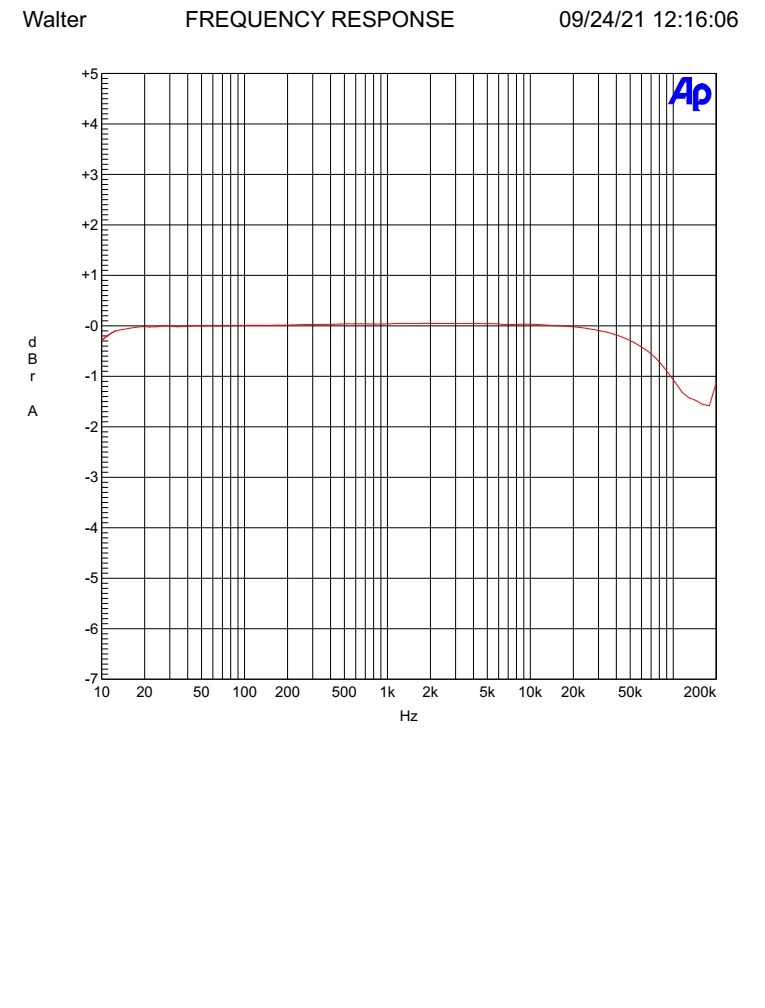

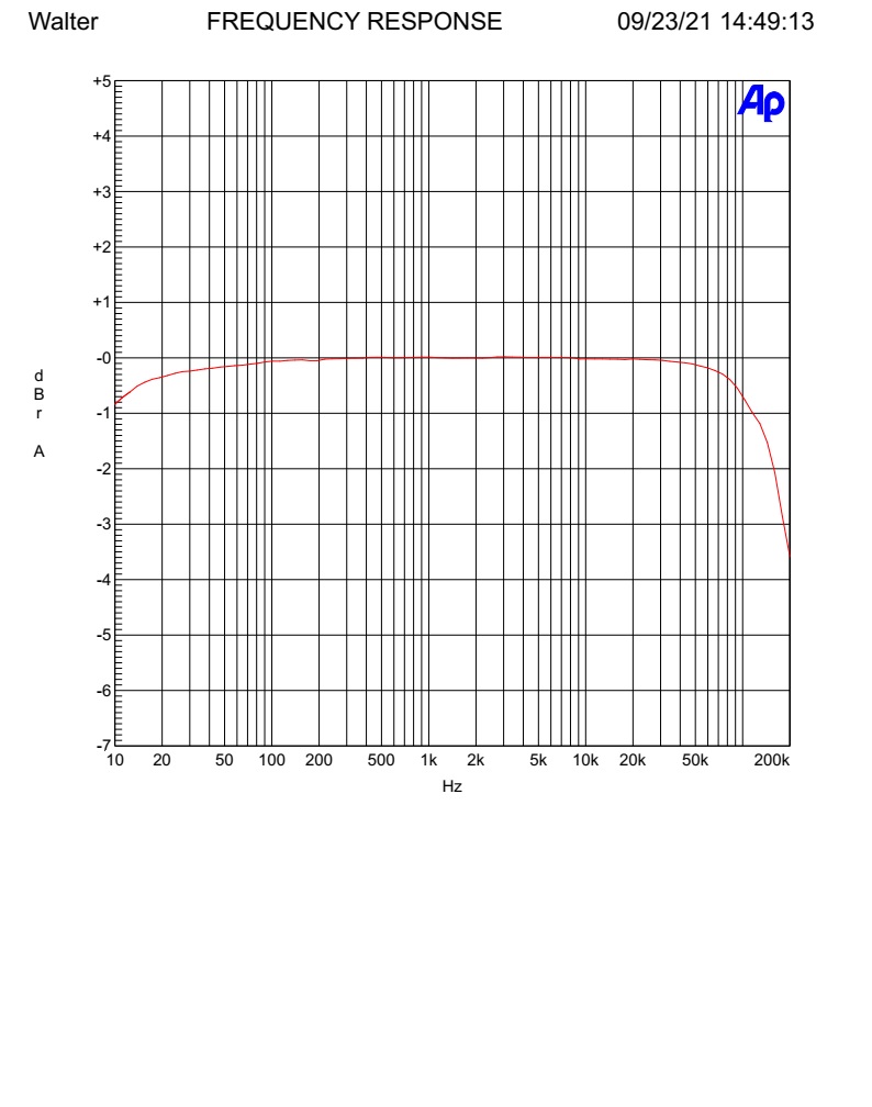

In attach also the frequency answer on 8 ohm 1 watt and same with 0,2uF in parallel
The OT are cistom made, C nucleus. Fedback is around 9 dB
The amp run at around 12 watt rms where the classs A is around the 80 % of total power

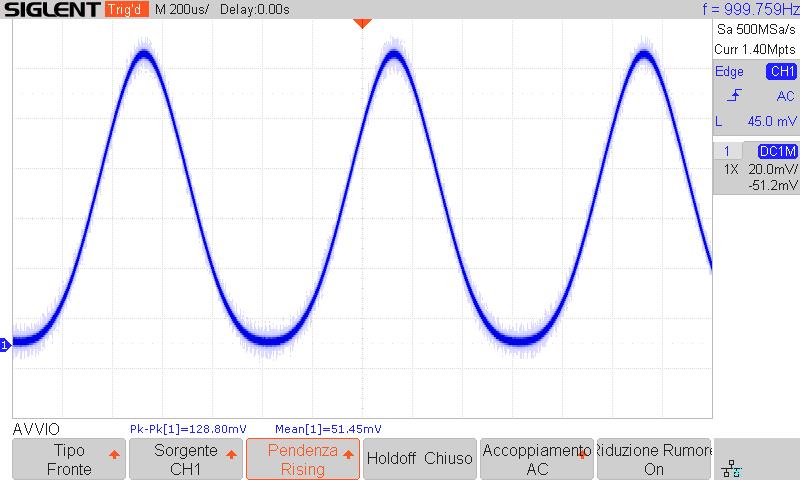

In the last diagram the manitor of the cathode current at 10 wrms on 8 ohm, class A

Steve (or George) C103 & 105 = 0.1uF 450V or 630V are to upgrade to what and why?
https://www.digikey.co.uk/en/products/detail/cornell-dubilier-electronics-cde/715P10458MD3/3906641.
https://www.mouser.co.uk/ProductDet...DE/715P10458MD3?qs=SfuicISz1S%2BpSOchpYj8bg==
Tubelabs have an explanation about the rectifier diodes.
As for R1 being replaced for a Choke, to filter out any remaining noise. It's a 1.5H 200mA?

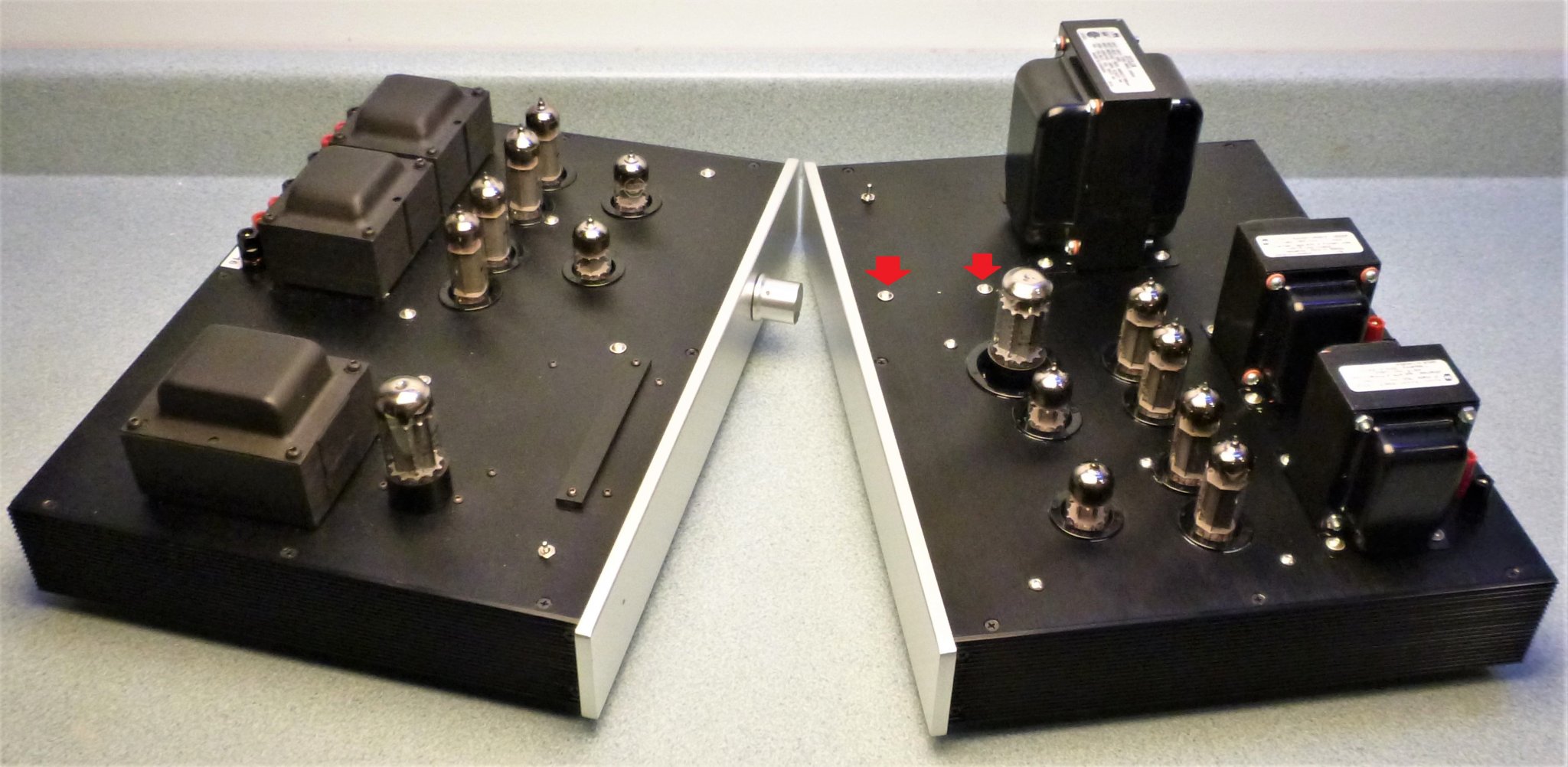

See picture attached. The one on the left used recycled "Iron" from an old EL84 amp. The one on the right has new Hammonds. The red arrows are pointing to the attachment screws that secure the PS choke to the underside of the chassis. The one on the left has the rectifier tube mounted off-board. The one on the right is the standard SPP with the GZ34 on the board. The board is secured to the chassis top plate with, IIRC, 19 or 20mm threaded spacers.
All of the components, except the tube sockets, can be mounted on either side of the board. On my two builds the tube sockets and couple of low wattage resistors were mounted on the top of the board. All other components were mounted on the bottom.
As you can see, the tubes are out front, OPRs behind and the speaker connectors behind the OPTs. Note how the orientation of the OPTs is rotated 90 degrees relative to the power trans. This is to prevent magnetic coupling leading to hum in the amp. Also the Choke is orientated 90 degrees to the power trans.
As mentioned previously, you might want to purchase a chassis with a slightly larger internal height. You will be less restricted on parts choices, especially the larger electrolytic caps.

Some further questions please.
C101 (no value given) in the circuit diagram is the feedback compensation capacitor.
Tubelab tells us: -
'It is not installed at this time. The value is highly dependent on the type of output transformers that are used. The value can be determined by measurement or listening tests. It may not be needed at all in some builds'.
What sort of value/types/voltage might be suggested?
If possible can some detail be given about the Upgrades and this includes C103 & C105 = 0.1uF 450V / 630V ?
Also from where could i find the things that would be fitted into the holes drilled for the valves, so as to cover up the space between the valve and drilled holes?
Tubelab tells us: -
To determine the value of C101 you need a square wave generator with about 10kHz.
You have to look at the result with an oscilloscope.
The value will be between 100pF to 800pF.
You can also determine the value with your ears.
Look here:
https://www.diyaudio.com/community/...ensation-capacitor-on-the-tubelab-spp.201612/
https://www.diyaudio.com/community/threads/tubelab-simple-p-p.148694/post-6492730
Look here:
