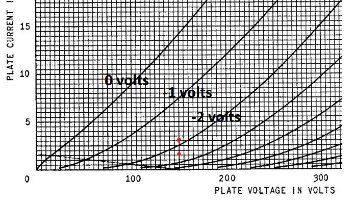

To first approximation, the first stage anode voltage = phase splitter grid voltage ~= phase splitter cathode voltage = Vk. The current through the phase splitter I is then calculated by ohms law as Vk/R where R = phase splitter load resistance. The phase splitter anode voltage Va then = B+ minus I x R, again by ohms law. The voltage across the phase splitter triode (Va - Vk) can be calculated as B+ minus 2Vk. So its practically constant and independent of the load resistance, whereas the current reduces as load resistance increases. If you then go and look at the 12at7 curves and draw a vertical line representing the constant voltage, you will see that as current decreases (by increasing the load resistance) you require more negative bias.Thanks, too, tikaroo, for your suggestion yesterday. I'm still trying to digest and understand how it works, so please accept this as a holding response for the moment. But meanwhile, is it easily explained why increasing the two load resistances and reducing the current makes the bias more negative?
Simon
So say first stage anode is 75V, Vk is close to 75V and B+ is 300V, the Va-Vk is 300 - 2x75 = about 150V. With a 24K load resistor, current is 75/24000 = 3.125 mA. From the curves, bias required for 150V and ~3 mA is about -1.95V (although your actual tubes don't follow the curves well). If you doubled resistance to 48K, current is 75/48000 = ~1.6 mA. Va - Vk is still about 150V. Bias from the curves is then about -2.5V = more negative.
There are no "actual voltages", even with tubes of the same make. You can only say "with this particular tube I get...".No need to eliminate the direct coupled circuit , maybe Tubelab or others can give you the actual voltages so you could tweak your components for those values . Or simply buy tubes that are known to work OK in those conditions
By principle a cathodyne PI is self-biasing via cathode degeneration/NFB, no matter if it's DC coupled or if the grid voltage is povided by a voltage divider.
Means that the cathode voltage always self-adjusts to the grid voltage + the positive value of the Vgk necessary for the plate current.
According to tube specs a real 12AT7 should have a plate current around 8mA when Vgk is positive.
The cathode voltage measured by the OP indicates a plate current of only 4mA.
In other words the tube used doesn't conform to the 12AT7 datasheet and shouldn't be marketed as a 12AT7.

tikiroo - thank you so much for this!! This explains it in simple terms and provides a theoretical basis for some experimentation now. To reflect it back, when we increase the load resistors R107 & R108, the voltage across the tube (Va - Vk) does not change significantly (I'd wondered about that) and with the reduced current, the tube now operates around the lower of the red dots on the Plate Characteristics as curve pictured below, rather than the higher red dot as before:...... So say first stage anode is 75V, Vk is close to 75V and B+ is 300V, the Va-Vk is 300 - 2x75 = about 150V. With a 24K load resistor, current is 75/24000 = 3.125 mA. From the curves, bias required for 150V and ~3 mA is about -1.95V (although your actual tubes don't follow the curves well). If you doubled resistance to 48K, current is 75/48000 = ~1.6 mA. Va - Vk is still about 150V. Bias from the curves is then about -2.5V = more negative.

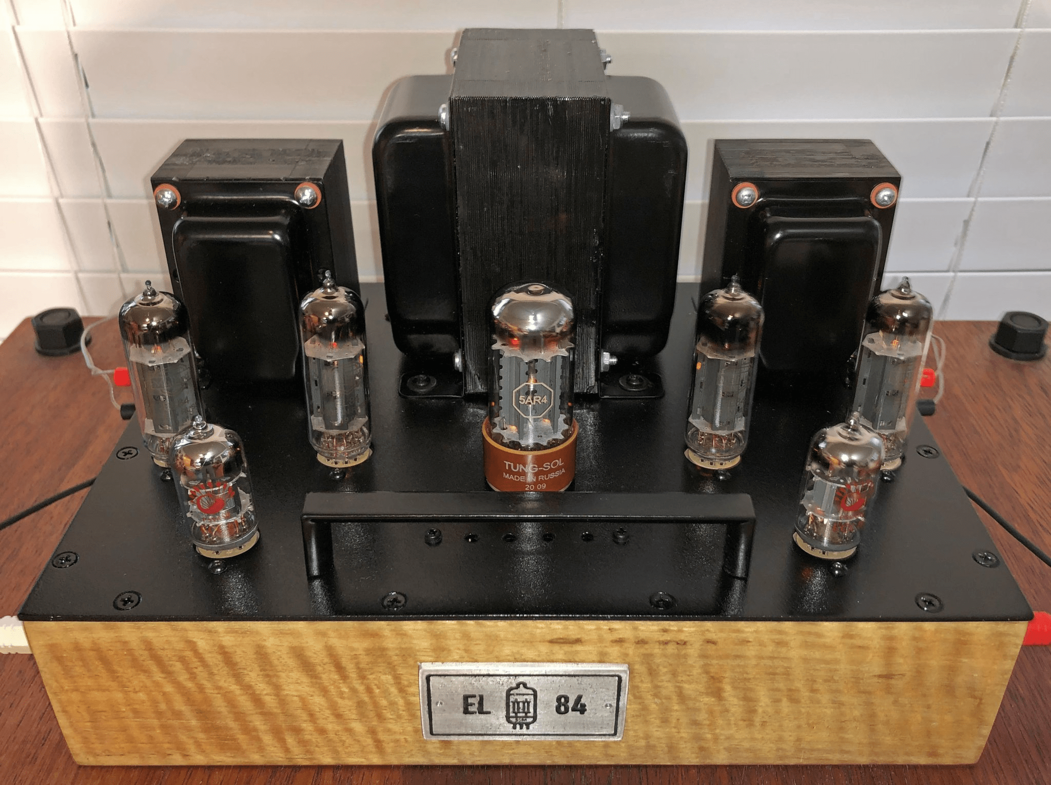

Final Update - I rebuilt the now-beautifully-performing Tubelab SPP into a more compact format. Still no detectable hum or bad behaviour, it easily drives any reasonable speakers, and it makes my F-18 open baffles absolutely rock - seen here listening to Jay McShann Rockin' in Rhythm 🙂.
Thanks for all the support to get me here!
