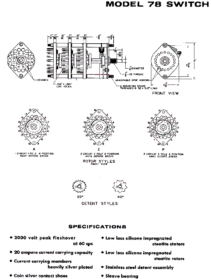

Russ, I have a question on your rotary switch design - you have it set up so that there is a minimum resistance always present so you can switch it on the fly.
What is the harm of letting the switch go open in between "clicks" on the dial? The resistor essentially goes infinite and shuts off bias current... does this make a "pop" on the output or is it bad for the tubes? or is it more insidious - say the bias voltage could approach the screen voltage and the screen tries to draw current - and then something else I'm not seeing happens...

oldmanStrat said:Russ, I have a question on your rotary switch design - you have it set up so that there is a minimum resistance always present so you can switch it on the fly.
My main concern was the bypass cap across the resistor. If the resistor went away, the only thing left to pass current to the cathode is the cap. It will charge-up quickly and probably will keep going past its rated voltage.
Multi-position switches have a designation on them regarding contact logic.
The most prevalent is the "Make before break" or...making both contacts (Parallel load) before the 'intended' goal load (Next contact).
The other designation is of course "Break before make" which is the designation that you are fearfull of because of its momentary "open" contact.

I considered the option of a "make before break" or "shorting" switch, but I don't like to rely on switch contacts to be the only line of defense between joy and an exploding capacitor.
In theory the cathode voltage would rise until the voltage gets high enough to cut off the output tube. A pop may be heard when the resistor is then switched back in. This is what USUALLY happens. It is possible for the voltage to rise above the voltage rating of the cathode cap causing it to leak some current. This current turns on the output tube, causing more current to flow through the cap. A runaway condition occurs leading to a big stinky mess of exploded capacitor. It CAN and does happen. I did it!
The simplest way to avoid this is to put a fairly large resistor in the board (820 or 1000 ohm) and switch resistors in parallel with it. If the switch fails, the tube defaults to its lowest current. Any switch can then be used.

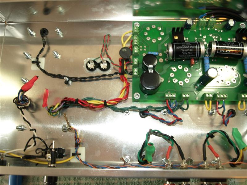

Fired up my SE today for testing. First with rectifier not in place, all filaments lit. After 5 minutes with no smoke coming out, I placed the rectifier in its socket and turn it on again. Again, no problems whatsoever. Then.....
I proceed on measuring hum in both channels. Input were shorted and started measuring the right channel......1 to 2 mv. Great! left channel............57mv!! What is wrong?
I checked and re-checked grounding according to the manual. Input connector common (R-channel) connected to the MAIN grounding lug. Common on both OPT secondaries connected to the MAIN grounding lug. Cases of OPT, Choke, and Power Tranny ALL connected to the Main grounding lug and the Main grounding lug is connected to the IEC ground lug.
Please help me if this is not correct. I'm confused!

60 hz humm?
are all of your input, OPT and AC wire pairs twisted?
Are you using an optional motor start cap? choke?
can you post a picture of your setup?

Hi oldmanStrat,
Yes, I'm using a choke and a filter cap. All OPT wires and choke as well as power wires twisted. My input wires are not twisted but they are shielded. I'll post picture of the inside in a bit. Thanks.

hmm looks like a nice tight build.
input jacks on the left? output on the right?
can't really tell what you have done with the inputs. Looks like a connector that I've not used before.. the pointy section goes to something on the top plate and the lug attach goes to a bundle that seems to exit the top too... oh, and a wire that is wrapped in a circle is also an inductor - but probably not your problem.
Where is your main ground?
I also see a bundle of wires - orange brown blue that may or may not be grounds or other things. What are these?
A single point of contact for grounds is the best way to avoid loops - if you didn't already know that.
Lots of wires are tied off with heat shrink. I'm especially interested in the ones on the OPTs, which I assume are bottom left. UL taps?

OldmanStrat,
Thanks for your comments. The OPT wires are the black(common) and green (8 ohms). The single yellow wire on the left is the circuit ground connected to the ground lug of the IEC. The orenge wire in the bottom is the input ground and the brown wires are the speaker post ground. The blue wires are for the OPT ground. No UL tap.
Anyway, No more hum!!!Yippeeeee!! I forgot to remove the contact from the lug to the bolt of the main power tranny. This caused the loop with the opt grounds and the single star point at the IEC. All music now. Hum measurement on both channels read.......tadaaaa......0mv! i'll roll EL34s, 6550s, kt88s and 6l6s tonight. Godspeed.
