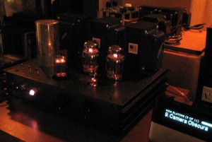

Well I am just finishing up my build. Seeing how neat and tidy your wires are have me already thinking about building a new chassis. I really could use a bit more room for wire management.

A little different approach on my chassis. I got the 17"x10" plate drilled all the holes and bent a 90` 2 " from either end. But...... I may have messed up the bends. Ended up having to beat it with a hammer. My brother in-law the retired plumber just got rid of all his sheet metal bending equipt. Now to see if the hammertone paint will cover the hammering.

The lowest setting is about 564 ohms. B+ is around 460 with this arrangement.
Thanks!
HEADinaJAR said:A little different approach on my chassis. I got the 17"x10" plate drilled all the holes and bent a 90` 2 " from either end. But...... I may have messed up the bends. Ended up having to beat it with a hammer. My brother in-law the retired plumber just got rid of all his sheet metal bending equipt. Now to see if the hammertone paint will cover the hammering.
It will to a certain extent. I'd try to get it as flat as possible. How it turns out depends a lot on how it is applied and the humidity and all that. It looks like what it is is two types of paint that are not quite compatible, so the upper layer fish-eye's on the lower layer and you get a pitted effect.
