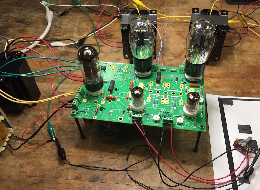

She's all checked out and ready for assembly into a chassis! Sounds really good on my bts, highly used and abused Boston Acoustics speakers and 18 gage wire interconnects. I also removed the potentiometer and connect directly to a 3.5mm jack on the iPod and RCA jacks connected to the amp inputs. B+/- voltages are stable, bias amps are stable. I'll start working on the chassis this weekend, hope to finish next week.
Thank you to Tubelab for all the time and effort to design, manufacture and post information about the Tubelab amps. This is what DIY is all about!

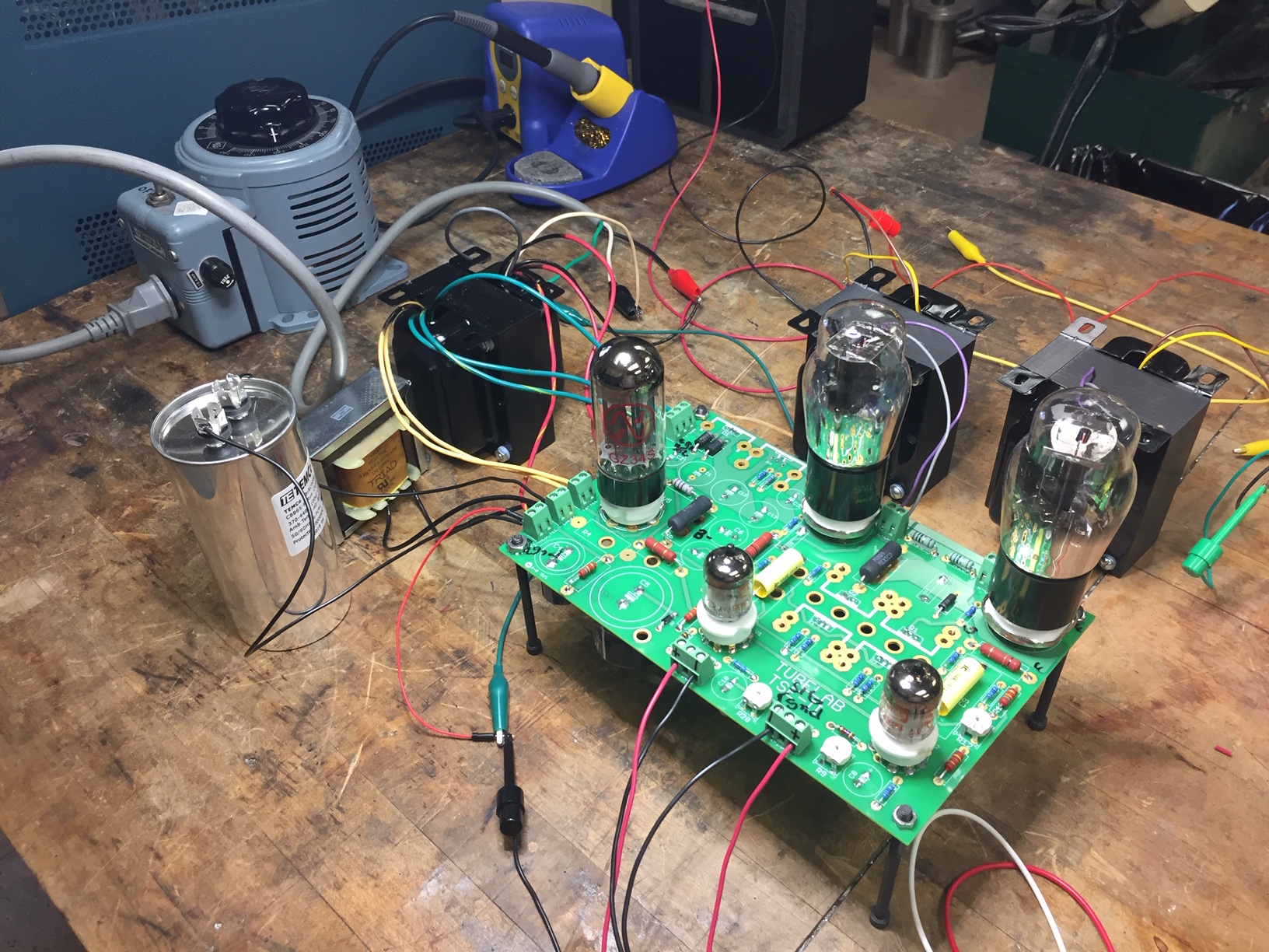

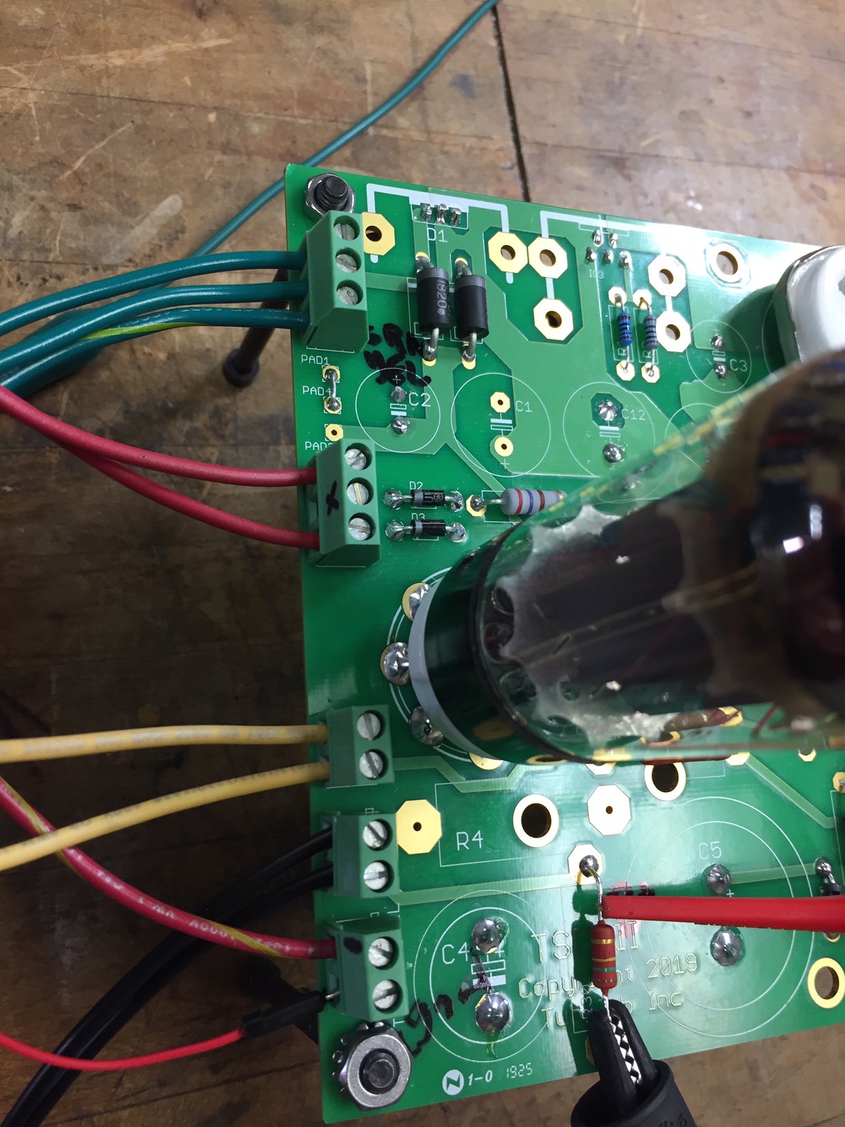

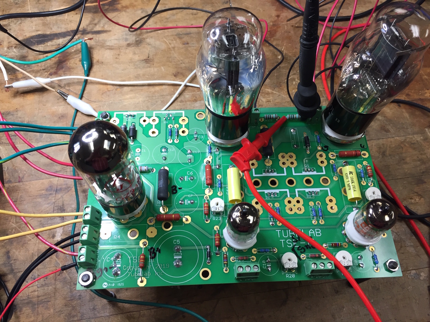

Inserted the 5842 tubes into their sockets and put a positive meter lead on the coupling cap nearest the 5842 tube, (C9 and C11), and the negative lead to ground. Adjusting R9 and R20 to around 175 Vdc.
Powered down and a few minutes later connected some bts crummy speakers to the OPT connectors: L-OPT-1 is red and L-OPT-2 is black. R-OPT-2 is black and R-OPT-1 is red. Installed the 45 tubes and leads across R18 and R29. Adjusted R12 and R23 to 27mA.
With all tubes installed, B+=339 Vdc, B-=-161.4 Vdc.

Measuring at the output tube pins, B+ = ~323.8 V dc, B- = -78.4.
The measurements listed with all tubes installed were measured at R30 for B+ and R6 for B- without output tubes installed.

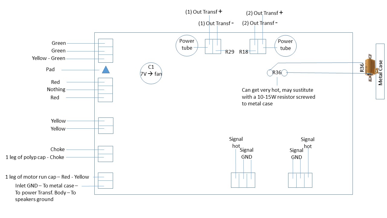

Hi folks need some help, I don't find specific information on how to wire output tranformers.
Reading this useful thread but no luck.
Will read again TSE wiring instruction, any help appreciated.

Everything looks right.
The Center Tap of the HV secondary goes to the connector in the lower left of your drawing. You have this labeled red-green. On most transformers that use the standard colors this is a red-yellow wire. Yours may be different.
Tubelab : The Center Tap of the HV secondary goes to the connector in the lower left of your drawing. You have this labeled red-green
gmonno : my error -- THANKS - error and image corrected.
