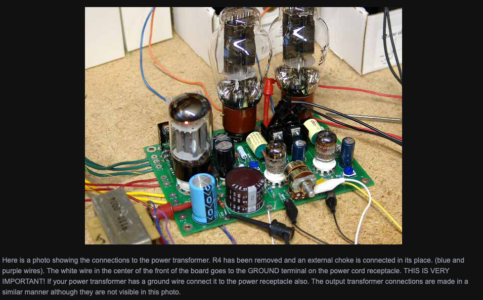

Here's a couple more photos if anyone is interested.

This brings up a question- the checkout procedure says to hook the speakers directly to the board and then connect a source and play music after the initial checkout.
It says "Connect a load to the amp, speakers or resistor." It says this after you have hooked up all three transformers, and a choke if used. You would connect your speakers or load resistor to the appropriate secondary of your OPT's.
If I can play music directly off the board, why do I need output transformers?
You can't play music on most tube amps without an output transformer. The tubes work at high voltages and low currents. The speakers work at much lower voltages and fairly high current. The output transformer uses a fixed ratio conversion raising the Current and lowering the Voltage while keeping the Power constant (Watts).
It would be like trying to make a car without a transmission. The engine runs at thousands of RPM with a few hundred Ft/Lbs of torque. The wheels need hundreds of RPM and thousands of Ft/Lbs of torque. The gears in the transmission and differential perform a similar conversion raising the Torque and reducing the RPM while keeping the power constant.
Note that it's not a coincidence that 1 Horsepower = 746 watts.

She's all checked out and ready for assembly into a chassis! Sounds really good on my bts, highly used and abused Boston Acoustics speakers and 18 gage wire interconnects. I also removed the potentiometer and connect directly to a 3.5mm jack on the iPod and RCA jacks connected to the amp inputs. B+/- voltages are stable, bias amps are stable. I'll start working on the chassis this weekend, hope to finish next week.
Thank you to Tubelab for all the time and effort to design, manufacture and post information about the Tubelab amps. This is what DIY is all about!

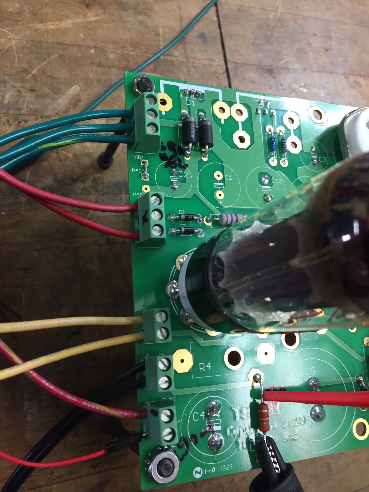

Inserted the 5842 tubes into their sockets and put a positive meter lead on the coupling cap nearest the 5842 tube, (C9 and C11), and the negative lead to ground. Adjusting R9 and R20 to around 175 Vdc.
Powered down and a few minutes later connected some bts crummy speakers to the OPT connectors: L-OPT-1 is red and L-OPT-2 is black. R-OPT-2 is black and R-OPT-1 is red. Installed the 45 tubes and leads across R18 and R29. Adjusted R12 and R23 to 27mA.
With all tubes installed, B+=339 Vdc, B-=-161.4 Vdc.
Measuring at the output tube pins, B+ = ~323.8 V dc, B- = -78.4.
The measurements listed with all tubes installed were measured at R30 for B+ and R6 for B- without output tubes installed.

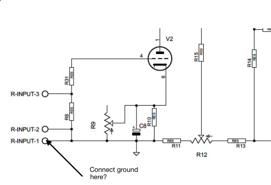

Tubelab : The Center Tap of the HV secondary goes to the connector in the lower left of your drawing. You have this labeled red-green
gmonno : my error -- THANKS - error and image corrected.

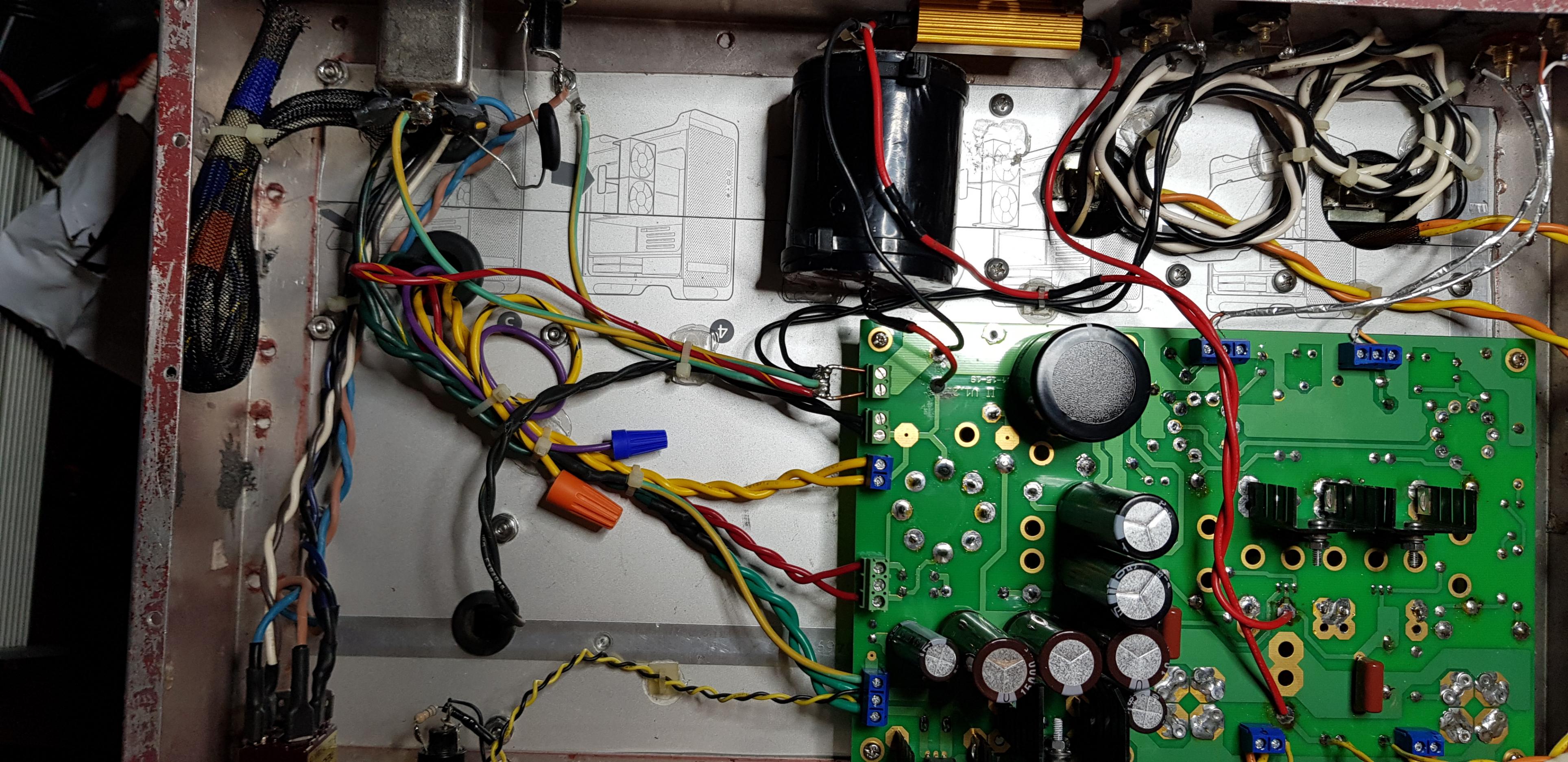

Duke58 and all : thanks for sharing your work.

I see people have capacitors across the power switches in some photos. Anyone have insight into what values, and how to wire? I see a lot of conflicting info about wiring across the switch vs. parallel with the load (how would I do this) vs. adding a resister as well, etc. . . I have a .001uf little cermaic cap rated for 3000V -- would this work?
