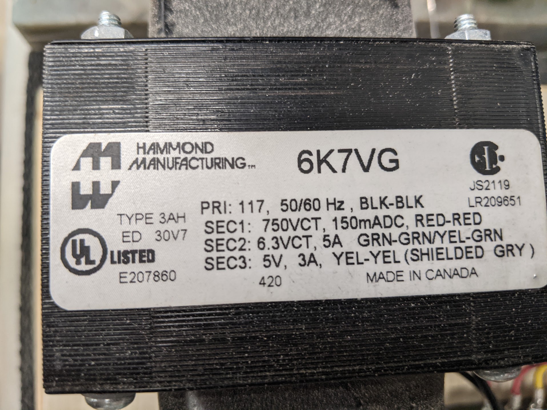

Some transformers have a bias tap or additional filament windings. These are not used and must not be connected to anything. Some transformers have a shield or ground wire. It should be connected to the ground lug on the power connector. This is a thin grey wire on an Allied transformer.
George
I was just getting ready to start a post about this grey shield wire on my Hammond (Allied?) power transformer, part # 6K7VG. The grey wire is listed as part of the SEC3 on the PT (see photo) ... so I wasn't sure if I should attach it to the ground lug or not. I was unsure if the shield was only to be used with the SEC3 output. Is it actually the 'equipment' ground for the transformer? Thanks!

When in doubt, look at the data sheet

Yes, I took a look at that. To me, the layperson, that looks like the shield wire has to do with the secondary side of the transformer... versus providing an equipment ground to the entire PT.

Yes, the grey wire *is* the one you should ground, as per George's quote you noted.
It's the shield, not part of the actual secondary.

Should I also run a ground wire (with a ring terminal on one end) between one of the bolts holding the transformer in place and the main/star ground? Or is that redundant?
Note, my bench setup is all mounted to a piece of plywood.
