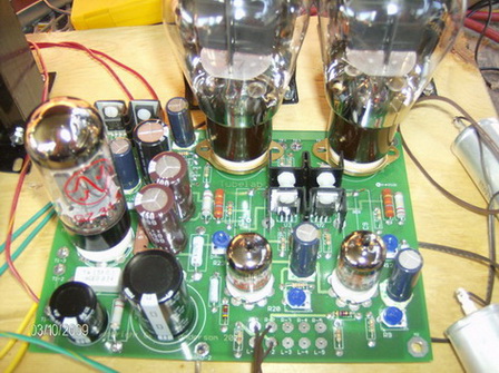

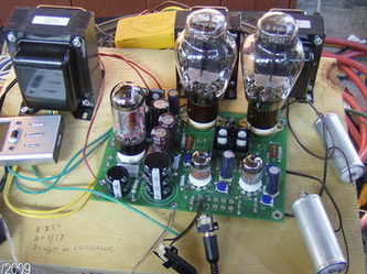

It may help if you take a photo of your board and post it. It is hard to troubleshoot what we can not see.
i tested my amp
i tested my amp my b- is -255v, b+ without tubes 430 with tube verys
with 260v +/- i listened 2 my amp for minute and 30 seconds then it shut down with one output tube it seem fine with 2 it shuts down looses filiments power left and right shunt loose current

Yeah, that totally sounds like the filament regulator is overheating. It has built-in thermal protection and will shut down until power is removed. That little heat sink can't dissipate all the heat generated by supplying the current requirements of the 300B. Mine would shut down after a minute or two. For 45s, it works fine. To move on with testing, all I did was clamp my Squangle (an adjustable aluminum square) to the heat sink and then it worked fine. There is only a few volts on the heatsink, so you don't have to worry about it. Just don't ever touch the CCS heatsink!
As Russ stated you need to add some heat sinking to the regulator. The regulator is likely shutting down from heat. After the amp shuts down you will find the regulator too hot to touch. You may be able to test the amp with a strong fan blowing on the existing heat sink.
I usually use heat sinks collected from old computers the ones from 486's and Pentium 1's work great. One can be seen inside the Lexan amp on my home page. It is the green thing behind the 5AR4. I will post a better picture to this thread tonight or tomorrow.
