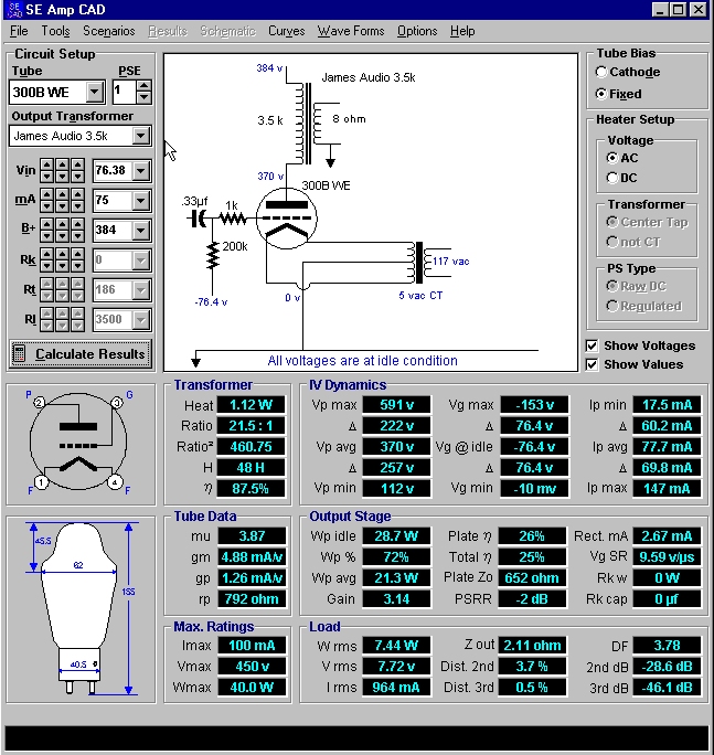

SE Amp CAD says that in order to bias the 300B to 75mA @ 384V, you need -76V of B-. So -150V seems like plenty for the MOSFET to draw from. Raising the B+ requires slightly more B-. Lowering the plate idle current also requires more B-.
The only problem with raising R6 to 40K is that the second cap in the filter takes longer to charge but I don't know if there are any transients that the cap is required to fill since this is Class A. Maybe someone can answer?
