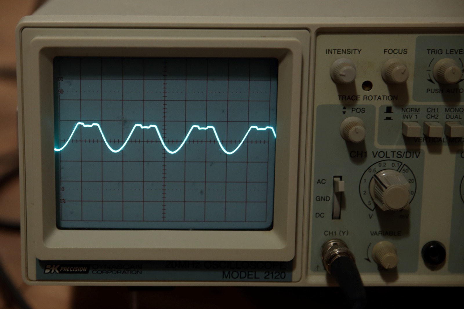

Please help... stumped
I built a working 300B Tubelab SE with ~405V B+ @ ~85mA. 5842's were biased to about 170V. Everything sounded good and I listened to it for hours.
I decided to look at square wave output so I hooked it up to the generator and everything looked about as I expected it look and sine looked perfect. The next day I went to re-bias the amp to make sure everything was still in spec and I noticed the output tube current was high so I bumped it down but when I did, the oscope displayed a funky shaped wave:
I immediately thought that the DC offset on the generator was off so I tried to adjust it only it didn't change... I quickly realized that you have to pull the knob out to adjust. Well, I pulled it out and instantly it put a 8-10V negative DC into the input of the amp and fried what I assumed were the CCS's.
I replaced both the CCS's and the MOSFET's, inspected the board for visual failures of other components, and tested nearly every passive component in the board. Everything is up to spec. Except now, every time I power it on, the bias current of the output tube goes right past 200mA within a few seconds (no matter where the trimmers are set) before it goes outside the meter's range and I have to turn the amp off. I have no idea what's going on since I haven't changed anything and all components seem to be perfectly fine.
The one thing that concerns me is there's a near -300V bias voltage... but I figured that's only until the B+ comes up (I'm using the Hammond 273BX - 700V). But the B+ can't get to where it's supposed to be though because the plate current goes so high.
Could the 300B's be bad?
I appreciate your help,
Kevin
I didn't check the grid resistors (duh), they are both open.
But that funky o scope shot was prior to the damage?
If I looked at your picture correctly, it shows 0.75 volts peak to peak which would only be 9 milliwatts into an 8 ohm load, if that waveform is at the speaker terminals.
What part of the amp was being measured?
Thanks for responding, yes prior to damage.
The probe I was using is a x10 at the speaker outs across 8-ohm resistor. It's old so there could be some noise but it should be 5V/div.
After I find some resistors to replace those, I'll hook it back up and look at the wave again. Could a DC offset (a little one) cause that top peak to invert like that?

It is strange but I have been having some of the same problems as you with my SE amp. My latest try resulted in burned up grid resistors too. It did not happen until I dropped the needle of my turntable and it saw signal. Someone said I may not be measuring the bias correctly across the plate resistors. I have set them for 62 ma a number of times. I have actually put this build on hold until I give it some more thought. I have checked and rechecked most everything on the board for mistakes and I have found no problem even though I replaced some parts just for the heck of it. This is not my first tube build, more like my 6th or 7th but all the ones before were point to point builds. Very frustrating that I cannot get this one to work. It has made me wonder about my output tubes as well. I am building another 300B without CCS or transistors so I should see shortly if my tubes are still OK of which I think they are.
After I replaced the grid resistors on the output tubes everything is back to working fine. This time I used 1/2 watt resistors. George recommended 1/4 watt (which is probably fine, I'm pretty sure it was negative DC that fried them) but with a significantly higher current and B+, I went ahead and upgraded.
Remember that there's no cap on the input of this amp so any DC can have a catastrophic effect on the semiconductors.
The best way is to have the 10ohm 1% (R18 and R29) installed and measure the voltage across it. On a meter set to 2V, centi-volts should be equal to milli-amps. In other words, .700 on the meter should equal 70mA.
