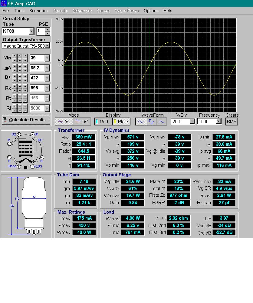

I am playing now with KT88 amp. I did the one with 6n1p and kt88 and the simpleSE from tubelab. I'd like to optimize cathode resistance, B+, and load to have minimum distorsion. The optimum would be to have a FTT Analyser, but it's far too expensive.
At the moment I have the standard configuration Cathode 560 ohm, B+ 422, load 5000ohm.
Does tubecad estimate distorsion ?

Here is a run with it at near maximum input.
Note that it took less than 5 min to do.
