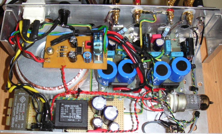

Hi
This is my first posting, out of Switzerland.
I successfully built my first tube buffered gainclone, based on the schematics from Joe Rasmussen (Thanks, Joe!).
The main differences in my implementation are:
- 2x18V 160VA
- startup delay with NE555 (to avoid startup transient from the tube)
- ECC82, AC filament
- no filter at the chip input
- Cc 4,3uF, Ri 2.2K, Rf 56K
- different psu-bypass (2x1000uF, 2x1uF, 2x0,1uF, 100uF)
- zobel network at the output (0,1uF / 10R)
It is a great amp and for some music (for example Pink Floyd) I prefer it over my 300B.
Franz
P.S.
Next time, I would design the pcb different and use both sides of it.

My real first tube GC
This was my real first tube-gc: an ECC82 as cathode grounded
system for the voltage gain, little voltage gain from the chip.
Actually, I reduce the gain from the valve by two resistors by the anode, because the overall gain is too high.
I want to try unity gain or feedback to the cathode.
The layout inside is not as flexible, as I used some experimental board and attached 1M feedback resistors in a very hidden place
This amp sounds very nearby a very good tube amp, but I have some Bias on the output (<20mV).
