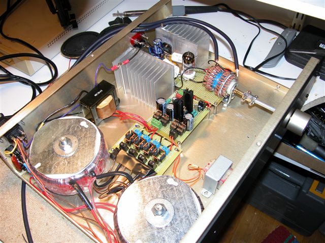

That's what I built mostly basing on Joe Rasmussen scheme.
As you see I used 2 toroidal transformers for LM3785 TF. 150-200 VA each. Two rectifier bridges per channel. I've got about 32V going to chips. There is only one tube Reflector 6922 working as buffer. Separate transformers for filament 6.2V and plates 45V. Attenuator 10K. This is of course LM3875 inverted topology with 1n6 cap filter. Ground point is beetwen the chips connected to chassis. Most of the parts are a little better than Radioshack type. It worked right away. I was suprised by very low offset only 2mV and 5mV. There is no hum or hiss and total silence with no signal. Filament transformer is funny small but that's what I had. I built power supply stage and realized that I don't have right transformer. Later I found nice 3A 7v-0-7v transformer but I'm not quite sure how to implement it. 14V+ is killing 7808 even with that heatsink. Some help appreciated.
Need to get RCA jacks, maybe better signal wires.

I built many Gainclones: inverted, non-inverted, buffered with buf634 and tube buffered is the best at least to my taste. That little addition of tube magic works excellent.
Thank You Joe Rasmussen for the scheme and others for being on the forum I couldn't build that amp without.

Hey, this is the best part, just great! Bet this is your first tube project? If so, welcome to the club.
Joe R.
Damn Joe. You got me.
That's my first tube project. I'm complete greenhorn in that field but I'd like to explore more and more. To my satisfaction my first project works really well, maybe too well because I feel audio tube desease growing inside me.
By the way..... Can I somehow, safely implement that 3A 7-0-7V transformer for the heater ?
You can: 7 * 1.41 = 9.87 > 7806 = 6V out or LM317 adj. to 6.3VDC or low voltage drop reg.with 6V out.

And that was the whole idea. We have created a new bunch of tube DIY heads out there and now they may well be emboldened to reach further. They now have a handle on such mysteries as filament supplies (that is what makes to tube glow). This is us older tube heads handing on the baton.

Certainly enough current, but maybe treat as a AC 14V secondary? Converting that to DC and getting down to 6.3V DC could mean a lot of heat to dissipate?
Anyone else got any ideas? This is always about issues of implementation.

True but he doesn't have to use the full secondary winding:
0-7VAC would be just about O.K. with a 78xx but a low voltage drop type would be better.
If you use the full secondary, full wave bridge rectified you end up with about 19 VDC, add a reg and use a 12DJ8 iso a 6DJ8 for instance.
Also using the entire secondary winding full wave (not Graetz bridge) into a capacitive load again, you'd have about 9.5 VDC, add the reg and you're done.

OK. I threw the values into Duncan's PSU Designer 2 program, with 4007 bridge and 10,000uF (you need a lot of capacitance at low V). Got 7.8V but the ripple dips down to 6.6V - and up to 9V.
Have you tried this little piece of software?
Joe R.
Joe R.
Oops! I take that back. The 10,000uF ESR was set to 2 Ohm, reset it to 0.2 Ohm - still got 7.8V but ripple from 7.6V and 8.2V - but still not good enough IMO. If using a 7806 (most 6922 will do OK on that), is 1.6V enough to prevent the 6V DC coming out not having little negative going dips 100 times per second?
I tried 9V AC, 2200uF w/bridge. Got 10.4V and ripple 9.7V to 11V - I reckon that is what it needs. The key thing is to look at the bottom of the ripple and take that as being the true voltage pre reg. The DC voltmeter only measures the 'average' volts. Now set the meter to DC and measure the ripple. Multiply that by 1.4 times and take away from the average DC measurement. Now take away the 78xx value and you have the clean DC across the regulator. What does this need according to the specs? 2V? 3V? Or whatever. Does that make sense?
I used 310mA to simulate the filament load. BTW, in our VSE FVP Phono preamp, the filament supply, it has 18V AC, bridge and 2200uF. The average volts never reach 1.41 times (25.3v). The load is 650mA @ 15V (reg'd) and we get about 22V and 0.7V RMS ripple. I put that into Duncan's simulator and got the same result as in the real world. Not a bad program.

I tried that 7-0-7 transformer for filament. I used only one half of windings so needed to add lot of capacitance and then LM317 to regulate voltage 6.3v. However I feel a little discomfort or in other words, lack of knowledge. The tube draws enough current so the measured voltage acros regulator drops a "bit". Instead of 6.3v I set there is about 5.5v. Shouldn't I set voltage while tube works ?

Yes, you should have the load in place.
Just put the tube in and try to set the voltage for 6V or 6.3V if possible.
Cheers,😉
