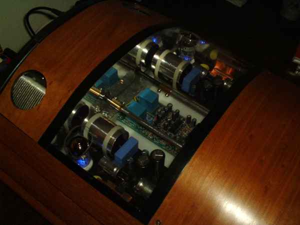

LPF cap value
OK, after nearly a week and trying both 680pF and 1nF caps for the LPF, I couldn't really decide which I liked best.
Anyway, I have brought the VBIGC downstairs from my testing room and put it in the 'main' system so that I can better audition the LPF alternatives.
For those interested, it is now playing, fed by a modified Philips CD723 into open-baffle speakers containing rebuilt/modified Goodmans 201 drivers with piezo tweeters and it sounds $%&*$£"%^& gorgeous (that's with the 1nF cap).
The amp is on a shelf under the CD player so I don't get that view through the 'window' in the lid but there is a beautiful blue glow visible when I have the room lights low! Purrrrr.......![hypno2 :hypno2: :hypno2:](https://files.diyaudio.com/forums/images/smilies/hypno2.gif)

Hi
Nuuk
I am using 1000pF but having change speaker cables I may try the 680 again,I be honest the soldering iron has had a break something of a record for me.
Your amp looks great and I echo your sentiments on the sound. I know won't mind me putting it on show here.
Peter

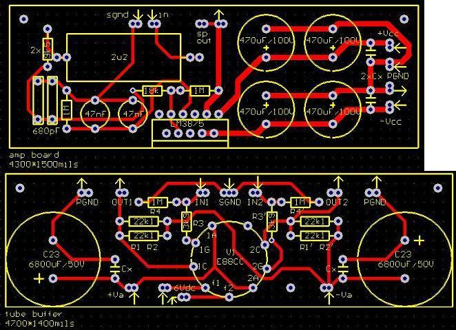

Re: GC Valve PCB wanted
Here are the corrected schematics of my TGC, and PCBs (four) in an old Protel version.
Maybe it helps.
Regards
colin.hepburn2 said:guys out there can some one help use with a Pcb and post one up using PCB express or some thing as this would be a great help to us guys
Maybe it helps.
Regards
