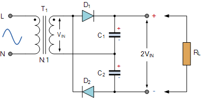

Costs go way up, if balanced I/Ps and O/Ps are wanted. Magnetics never come cheap!
6.3 VAC heating should be OK, especially if you use Sovtek 12AX7LPS tubes. The New Sensor offering contains a hum bucking, spiral wound, heater.
The 12AX7 is a wimp and is not good at driving loads.

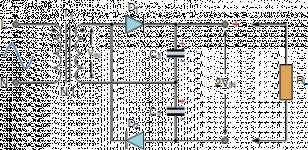

If you "full wave" voltage double the O/P of a Triad N-68X, you obtain "feedstock" for a voltage regulator. 100 or so mA. of B+ is plenty, for small signal circuitry.
Please could you explain me better, in some noobie language? Hehehe Sorry for this, im studing, but still a long way to understand those circuits well.

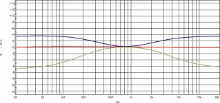

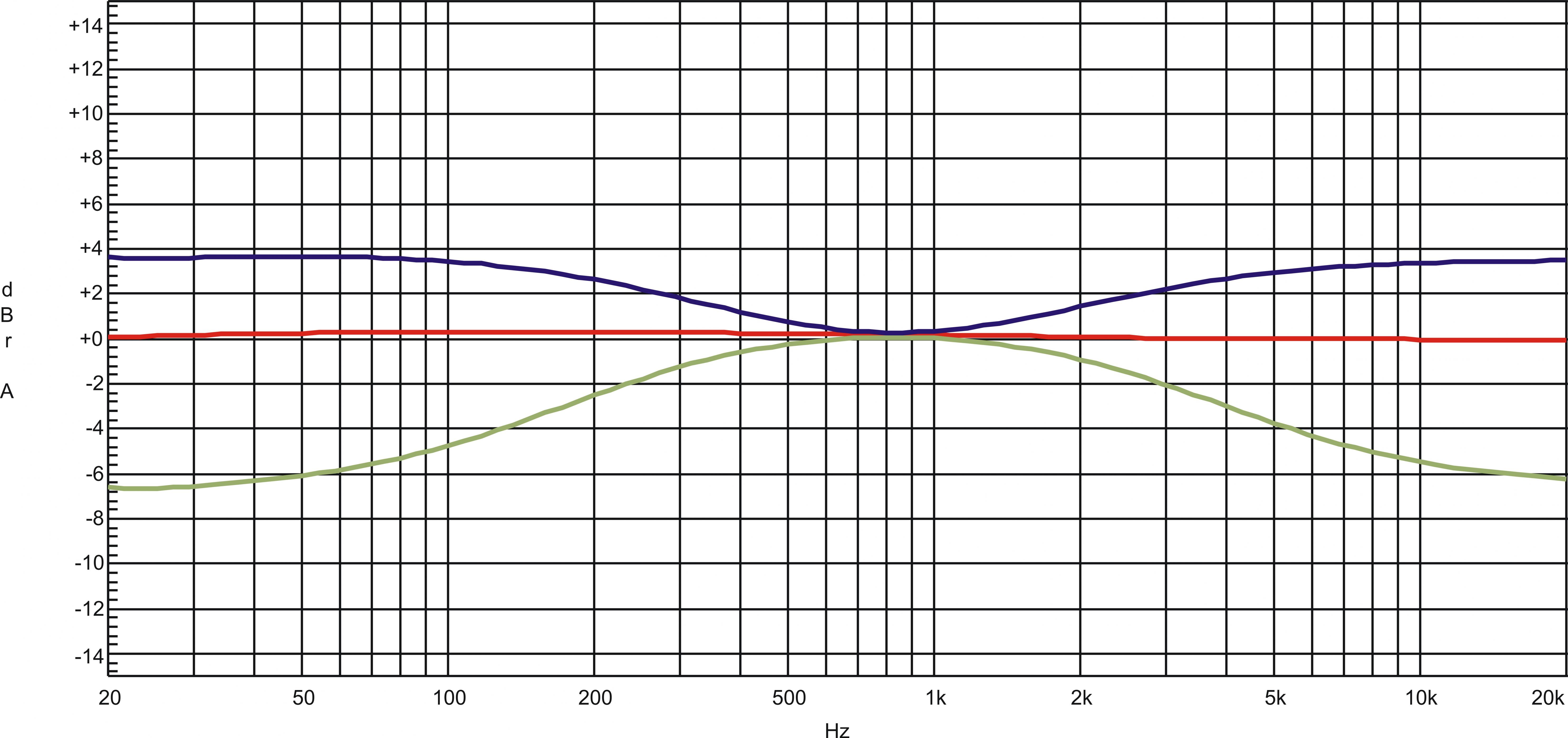

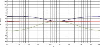

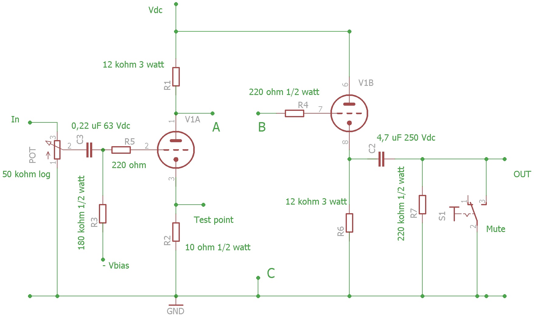

Hi
in attach a diagram of a line preamp with 6N6 double triode.
In Fig.2 the complete circuit with three point where you can connect the tone control in Fig. 3
It works great and the gain with 6N6 is 15 dB (5,5 times), with ECC88 we get 21 dB without any changes on circuit.
Connecting A with B you have a simply line preamp.
Inserting the circuit of Fig. 3 you can have the tone control.
You can see also the response of the tone control with two tubes.

The "full wave" voltage doubler is, in fact, 2X half wave rectifiers wired back to back. Some characteristics of true full wave rectification are present: the entire sine wave is used, no "standing" DC is applied to the power transformer's rectifier winding, and the ripple frequency is 2X the power line frequency.
Hi
This circuit was presented by me on Audioreview in Italy.
I am preparing the boards also.
Walter, thank you so much! This project looks really interesting!
Will you sell the PCBs? Or can share the layout?
Do you think would be a good ideia to build It point-to-point without pcb? Seems to be not so difficult.
As long as I understand the circuit It is a mono tube preamp, and the figure 3 is a passive low and high shelf baxandall, is that right? I have to build two of these for a stereo version.
The tube preamp has only the input gain stage pot. and can be used with a pair of 6n6 or ECC88 (which is a tube I enjoy Very much!)
