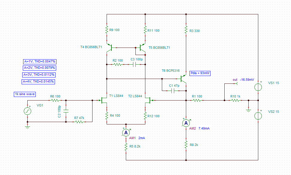

I am looking to design a low parts count tube sound simulating circuit using JFETs.
From what I understand, the idea is to inject 2nd order harmonics into the original signal. And from my research JFETs are the best alternative as they behave similarly in distortion profile to a tube, but don't require all of the tube circuitry overhead.
I am not doing EE as a profession so looking for a second opinion on the circuit that I have came up.

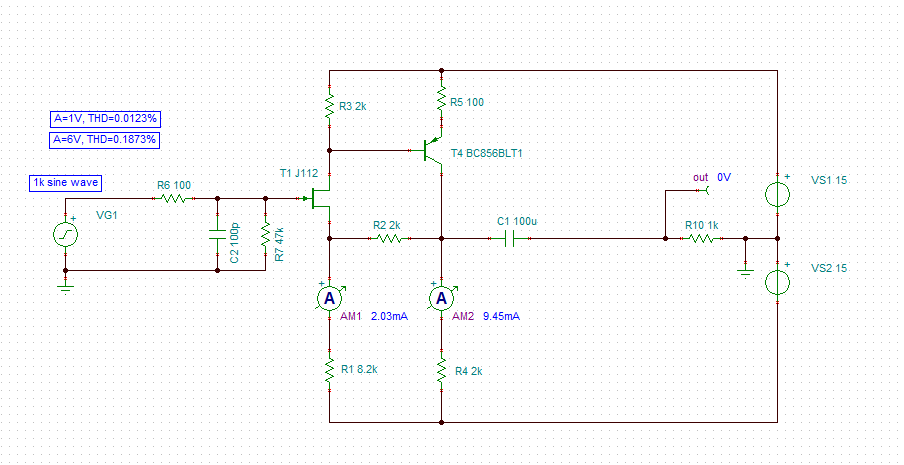

As a basis I took circuit from ESP article - https://sound-au.com/articles/followers.html

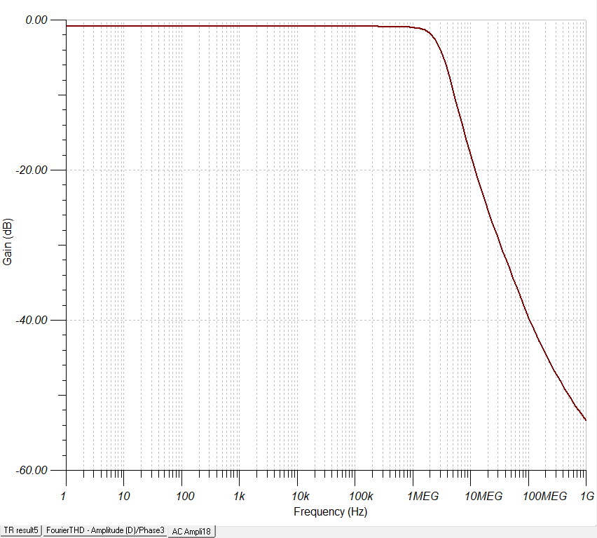

It is long tail pair of JFETs with pnp BJT providing feedback. I added current mirror to fix the offset. Also added compensation components. It runs fine in simulator but I wonder if there is something that needs to be accounted for that cannot be simulated.

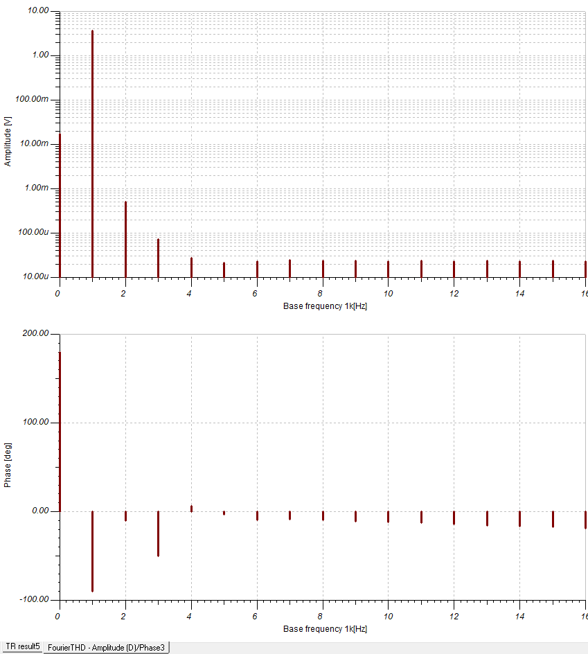

I was shooting for a distortion of 0.01% with full voltage swing at the input of 2Vrms (or 2.82Vp). For that I added 330R resistor to the emitter of the feedback transistor and I assume it will reduce the "extent" of the feedback, thus allow for more nonlinear behavior (more distortion).
Tubes produce around 0.1% 2nd harmonic distortion so I am wondering if I should come up with circuit that makes that much? Or 0.01% is enough lol?
Attached are simulation files.
Any comments are welcome! 🙂

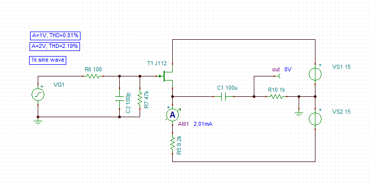

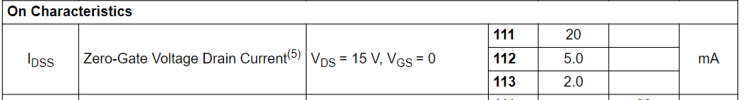

I attempted to use a simple J112 jfet voltage follower, but it does not swing below negative 2.smth volts. It also produces too much distortion.
It all depends on the Id-Vgs plot for this jfet, in this circuit. With 2mA, it can be close to Idss, so clipping/reverse bias can occur... mostly occuring at positive volt?
Add a complete datasheet for the J112 to avoid annoyances (I have it somewhere, searching, things... include, instead of guesses).
What is "2.smth volts"?
Well, of course, 2mA into 1k is 2V. If you want 15V into 1k then you need 15mA. Tube amps rarely use cathode followers. The sound you want comes from common cathode (source) stages. To avoid gain, you just use a small drain load resistor. If you want to drive 1K, since most JFET Idss is less than 15mA you will need to buffer it.

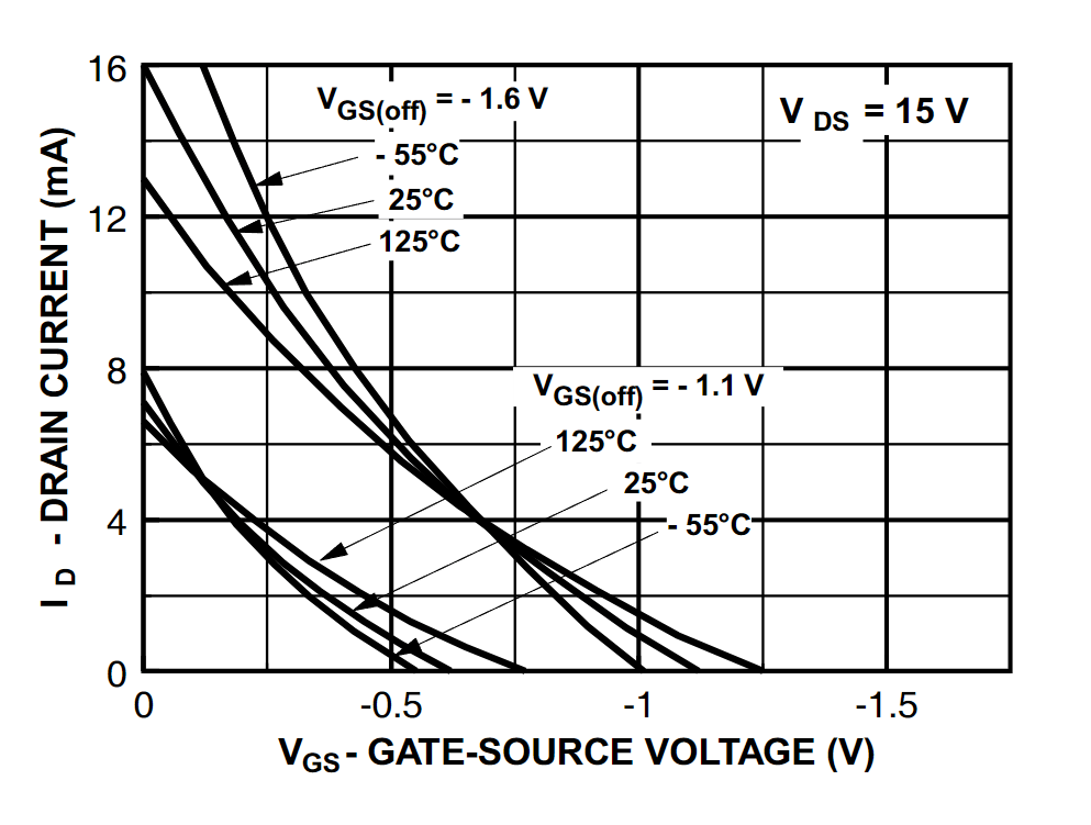

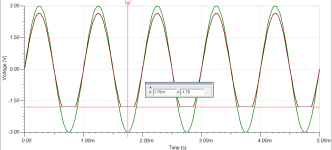

Here:
J112 graphs + clips at -1.72V actually. Need it to go to at least 2.82V.

Here:
Be careful with the minus symbol when addressing junction field effect transistors!
You need to go to (minus =) -2.82V?
And given the spread of these 'qube-formula' components, that's only a meager factor 1.6 off.
Those graphs show also an Idss of 8-16mA and a 20-40mA in the Vpo range between -1.1 to -3.0V (3/1.1≈ 2.7)--((Notice √2.7 ≈ 1.6!)).
In the circuit of #5, limitations are depending on the given model (when simulating with defined parameters), or on the actual specifications per unit. A very dreadfull route and rarely used in the industry. The #6 circuit is very widely used as a reliable solution. There's much to find about this in the Siliconix & Teledyne handbooks (era 1978-1981).
