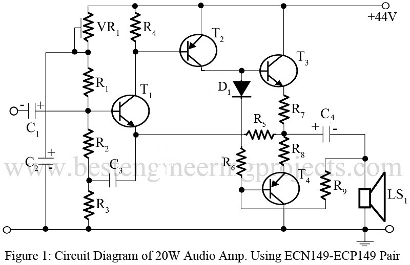

I think this is it. I remember the single diode bias on the output stage. My thinking was that the NPN was silicon and the PNP was germanium.
Reactions: CFT and cumbb
I once built such a simple circuit - even simpler - for someone who claimed that it sounded like his 300B SE;-)

As for schematic request.
Curious as well.
It is actually rather easy to make .1% to .01%
" tube" distortion amplifier with solid state.
Including asymmetrical clipping.
Nothing special.

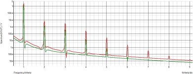

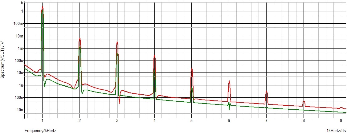

One can take an amp with ppm level THD and insert a preamp stage that will emulate the desired
distorsion profile, FI this the Ibanez EQ 100 guitar amp preamp output signal when driven through its high gain input,
the output levels are 1V pk and 2V pk, see how the THD rise by 15-20db while the output level rise by only 6dB
all while producing the same harmonic profile.

It is a multiband / peak cut EQ
So yes is useful for med to high distortion guitar.
Being most the magic to good distortion.
Is pre and post filters. And with distortion=
Cutting certain frequencies.
Multiband is usually wide boost and narrow cut.
That is most the magic to good " guitar" or instrument distortion.
Is narrow cuts. Your either cutting harsh harmonics from the instrument.
Or in the end cutting the harsh frequencies of typical guitar speakers.

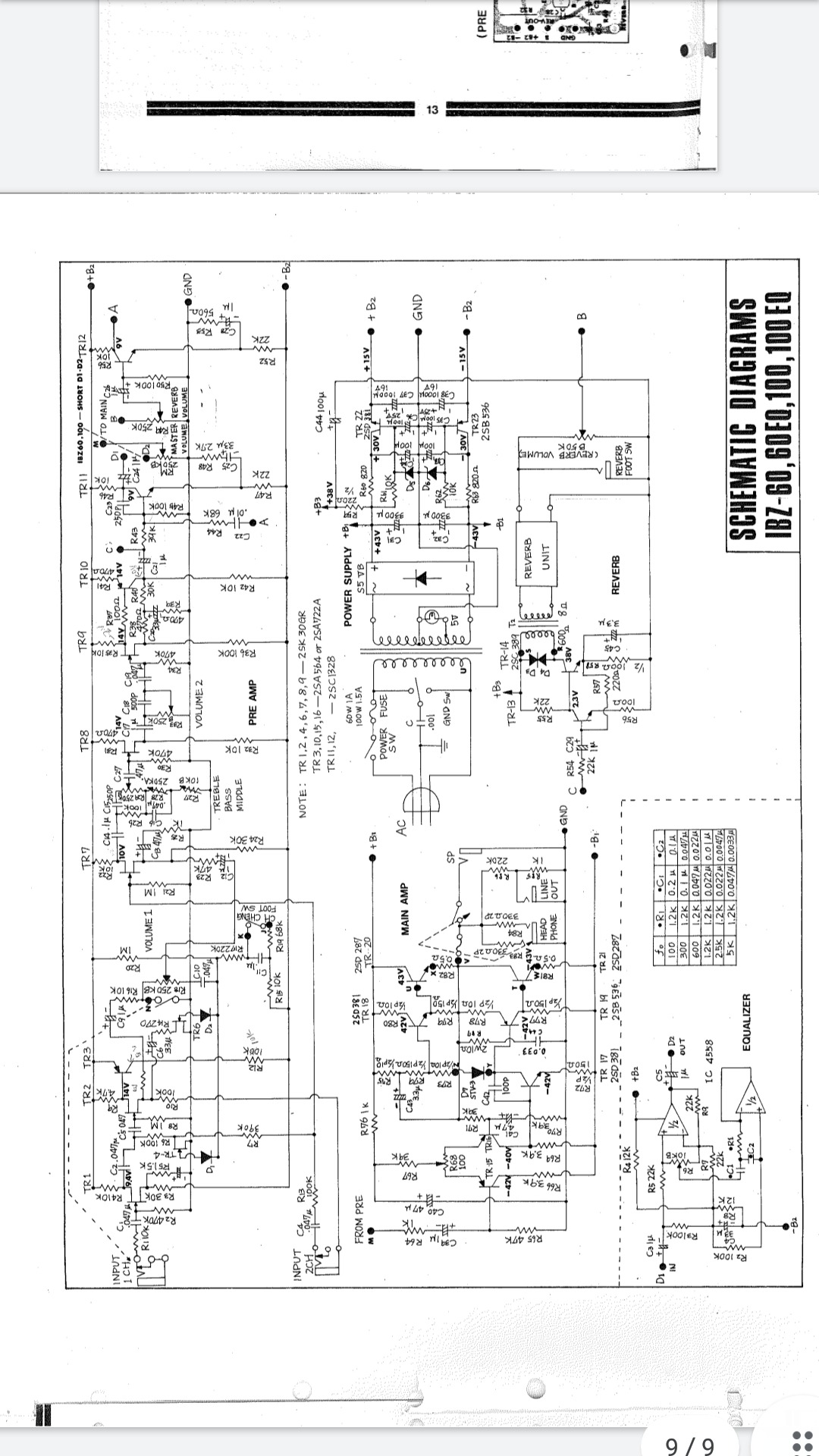

That s a hell of a preamp, i bought this amp in the late 80s from a friend to be used in a cultural centre,
i serviced it from day one as it was noisy and needed all cables to be shortened and eventualy shielded, the output transistors
were previously replaced by a pair of 2N3773, after wich it was used by both amateurs and pro guitarists, one of the latter told me
that it kind sounded like a Mesaboogie, wich is certainly due to the 6 bands equalizer as the distorsion itself is more like Ibanez s famed Tube Screamer.
@CFT, i wouldnt engage in building part of the preamp circuitry, the THD profile can easily be emulated by two transistors
connected in serial with both as common emitters, or eventually two fets in common source, or why not, a combination
of a fet and a bipolar, and using two devices in serial and common emitter/source will keep the phase unchanged.
Reactions: CFT

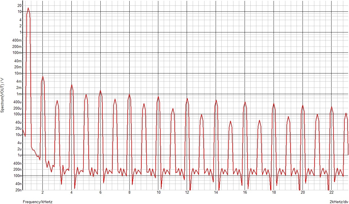

Dunno if that can be called a distinctive sound since with relatively low THD there s not much to hear,
although this one has quite high ratio compared to HiFi amps, but QCs have this property to produce even
harmonics with higher amplitude than the odd ones.
Of course this will apply as long as the OS is not gain starved at higher power, at wich point H3 will be dominant
like with any complementary OS that is also Hfe limited.
FTR that s the kind of harmonic profile of this Ibanez at 15V pk output level, the x axis is left linear so the respective
harmonics amplitudes up to 20Khz are better visible.

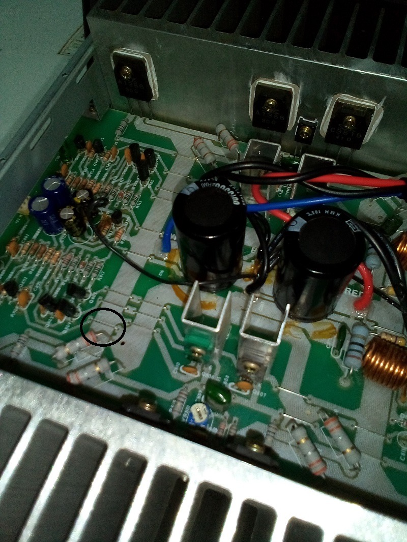

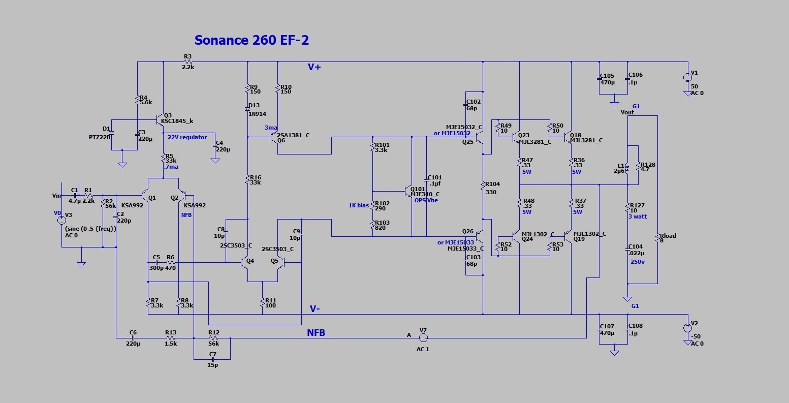

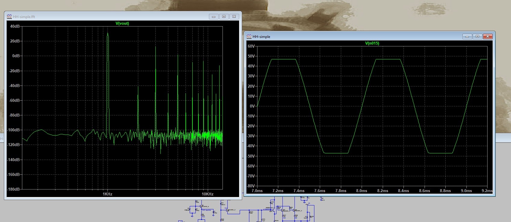

The Ibenez also bootstraps the VAS. VAS is directly fed OS LCR/speaker interactions. Like my present experiment (Sonance amp) , it feeds HF
(lead capacitor) back to the IPS. Strange it has such a pleasant sound for such a simple high(er) THD circuit (below).
I have a Wolverine pair that doesn't do too much better (brushes).... even at it's over-rated PPM spec !
PS - sonance does not take NFB right at the output (circled in pix) , will add two yellow wires to feed right from the actual outputs. Ceramics will
be silver mica , all new caps , as well. This amp is not as clear with brushes and other HF. Built for 34 years of service - NOT super Hi-fi...
I also increased the OL gain and tweaked the lead/lag - C5+7 values to give better phase response.
I most likely will be blasting my synth through this thing...

There is ONE factor we are forgetting .... Tube amps have a output trafo !
The valves can saturate the core which also has inductance.
Without that big block of steel , the typical EF-X stage will clip with "gobs" of odd order distortion.
That is , even if the circuit is even order dominant short of overload. (below)
The only application I've seen of a BJT running through a output trafo is in those 70V PA commercial
systems. They are robust , you can clip and distort all day though a School intercom setup !
OS

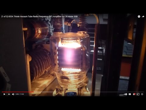

I have read of 200W tube amps made with 3-4KV plates (833A tubes) and a special toroid that can match the headroom
of a 3-4 pair EF3 BJT amp.
I has NFB but still needs a output trafo , so NO PPM tube amp. maybe .1- .5% @ 180W/8R.
Edit , .5% H2 will still sound like a BIG tube amp.
