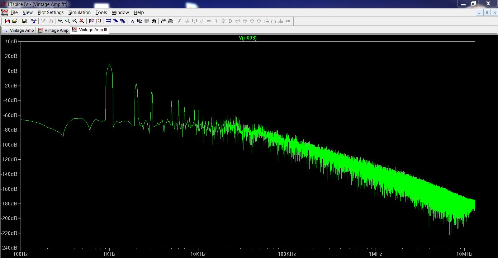

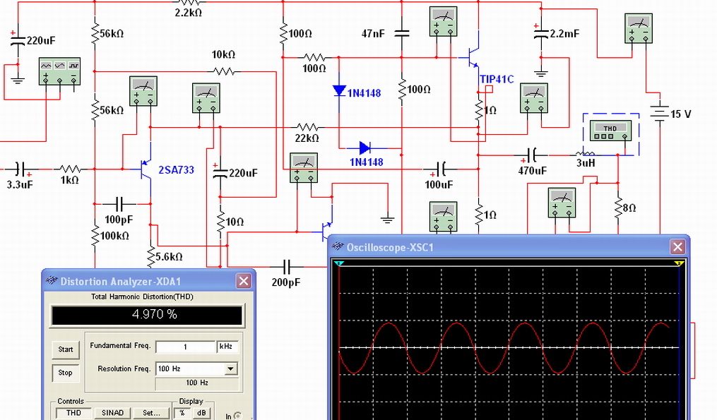

It is not promising into the simulator.
to me this is enough...biasing is wrong...i had to tweak a lot, fourier analises result in a tragedy......3.5 volts in the output..too much sensitive in the input...well...i give up about this one.
But i do like to listen...set a movie camera and make a recording..then post it in Youtube.

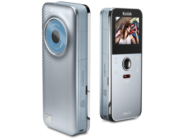

You see...it is possible to make reasonable recordings if you use 1 watt and 1 meter from the speaker....have to use matresses and all absorbing material around...it is not that easy..also have to enter a digital processor to remove noise from the recording....hissing noise.
Camera was Kodak Playfull Ze1, one meter distance and microphone sensitivity reduced to the maximum i could.... a fifty dollar camera did this job..imagine a good one what can do.
