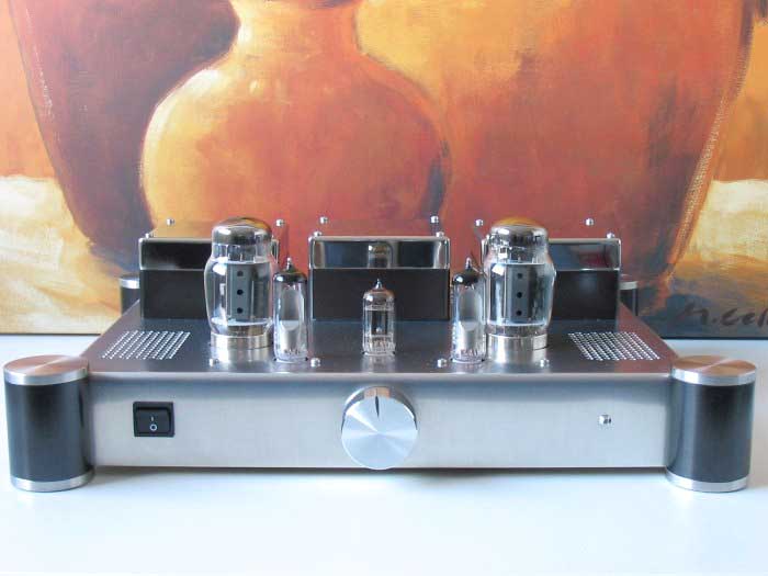

As a last project I would like to build a SE tube amplifier.
I built several Solid S. amplifiers over the last 20 years.. So I would like to finish all my project and enjoy listening music.
I need some advise which amplifier to choose between the two project.

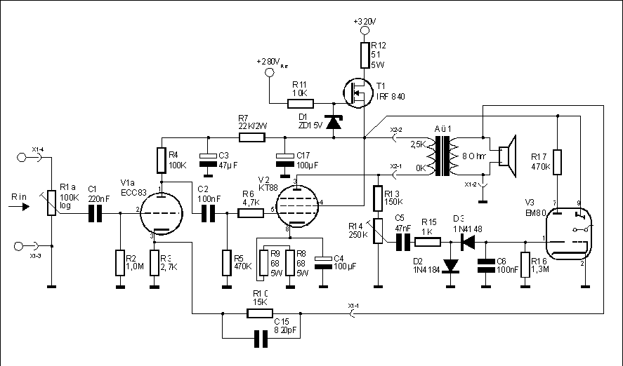

The KT88 has PC board lay out, I can make the PC board, I have only one question can I drive with a half ECC83 these amplifier
These project from a Germany website..The owner of the amp wrote he more than happy with the result!
KT88SE Roehrenverstaerker, von Michael Dieckmann
Also I think I can use here 6550 and other tubes??

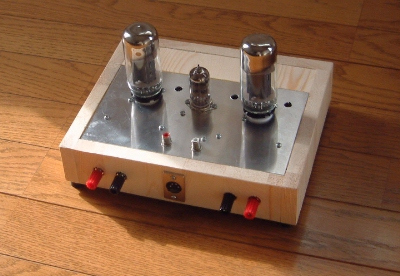

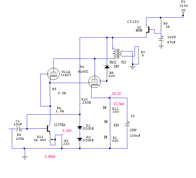

The another project from a Japanese Website
These is a Super triode mode also half 12AX7 driver stage and 6L6GC power tube.
Also I don't know if the power tube can be replaced by EL34 or KT88 with out any modification on the circuit to get more power.
I would like to get 7 to 10W power but most important the quality of those watts..
Any advise welcome.

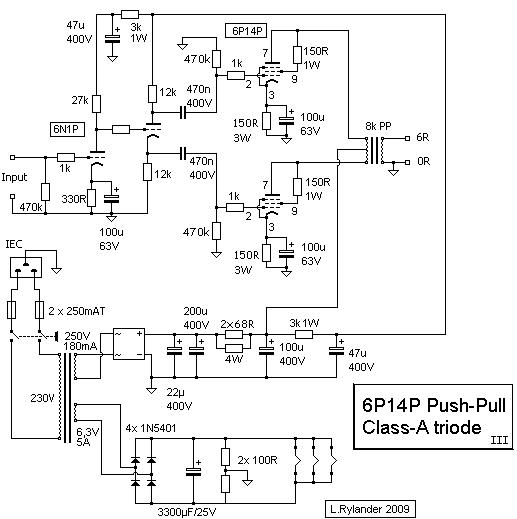

If you want quality of watts 6L6 clones are not the right choice. For 7 to 10 watt of output pair I would prefer something like 4 of 6P15P in parallel, in triode mode.
Hi, If you are going to spend serious money on iron, might as well get
Tango U808 or SE20 don't know if I got the last one right .Both with multiple
taps then you would not be restricted by choice of tubes.
I'm with him.
Triode mode is the real deal.
6p15p are cheap.

Like the 6L6 and all of its higher Pa-max clones, the EL84 weren't designed for triode SE use either. The best triode curves has IMHO the KT66. But today people even use line-output-switching tubes as linear amplifiers (as people use IRF530 switching MOSFETS) or transmitting tubes etc. Paralleling tubes will add distortion, too just because of different dynamical parameters of each valve.
I don't want to discuss about "sound", but you can certainly build a excellent sounding KT88 SE amp for example.
Getting 10W out of in SE is as pentode is easy, as triode it isn't that easy.
You just have to know what you want. Why not EL34 SE. they're very cheap, reliable and everywhere available.
Depends. I get 13 W out of my JJ 300B's using something akin to George/tubelab's PowerDrive. 400 V on the anode of the 300B, 90~95 mA quiescent current, 5 kOhm primary impedance on the OPT. Yes. 95 mA, 400 V is hot but within the original WE spec. With current production tubes, I have no issues.

The KT88 amplifier from german site has a few flaws. The main problem is, that driving a KT88 to full output and using a good amount of feedback, requires lots of signal amplitude, thus gain from the driver. A single small signal triode is on its limit with this purpose. Especially in this circuit, where the ECC83 has no cathode bypass capacitor which means current-feedback and reduced gain in the driver stage I would rather suggest this amplifier: KT 88 SE-Amp, von Franz Wichlas. The cascode stage gives plenty of gain. But the Power stage is IMHO driven by too low voltage. I would give a KT88 at least 350-400V to gain max. output power.

You can easily select them using power supply, tube socket, and one cathode resistor. Swap them and write down voltage you measured on the cathode resistor when screen grid and anode connected to B+, control grid to ground.

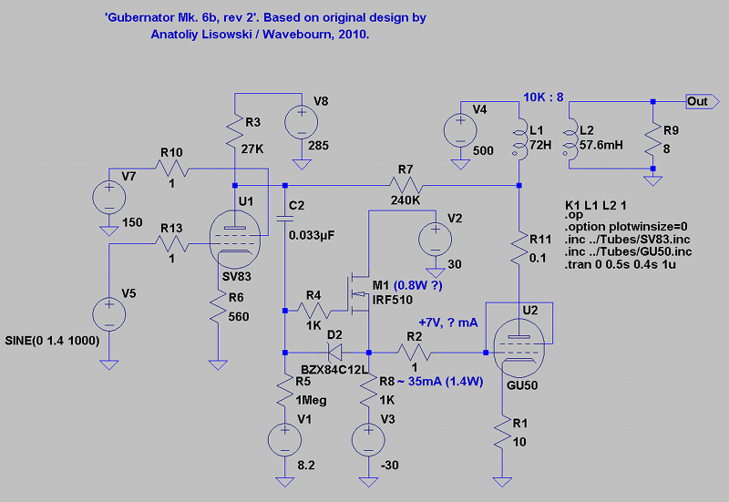

Another alternative is to use huge and linear tubes like GK-71, GM-70, GU-13.
If you want smaller tubes you may use GU-50 in pentode mode with local feedback around it. But be prepared to pay more attention to the driver stage.
It is up to you. Even 6L6 clones like KT-66 or KT-88 can sound well, but with significant local feedback around them, in pentode mode. In triode mode, oor pentode mode without feedback, their linear mode means such power dissipation they would melt down, or driver would be needed too good, to drive them in triode mode with local feedback. You can use nested feedbacks (local and global) to ease requirements to the driver stage, but people believe it is not kosher. 😉

I try to avoid to use 3-4 or more power tubes in parallel! Simple because mostly every tube behave different.
If I go with 2 power tube ad rather chose PP.. I read PP not need to be matched so well like parallel tubes.
Yes you right one large linear tube it would be useful. 7-8W in triode mode it would be nice!
I have to search for schematic, I'm unable to design or modify tube staff with out help.

Here is the thread where we discussed several variations:
GU-50 Single Ended Amplifier Design
Here is one particular version that I like:

Wavebourn thank you, I will check the site. I cant see your picture.

Here is a PP in triode , uses cheap (not expensive) Russian tubes (I have good experience with those power tubes)
To tell the truth I will have several great sounding SS amp.
Sometimes I would like to listening good tube sound!
If it sound bad com pare to the Pass amps and Krell ,Musical F. I would never turn it on. Or if I get only 2-3W I will have the same problem I had with the Philips.
I want to spend that money wisely or better not to spend it if I cant get the result..
