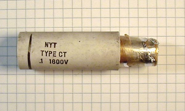

never assume that a capacitor is discharged
never assume that the unit you are working with is unplugged

Jhovis said:Discharging caps was my main concern. I have to figure out how to do that.
A resistor, of sufficiently high resistance and power rating, attached across the capacitor with a well insulated tool in one hand and the other in your back pocket.
Too low a resistance (like a pair of pliers 😱 ) and sparks, explosions, and arc-welding may occur.
And also make sure your arm isn't resting on the chassis!
Never use no matter how tempting; A SCREWDRIVER!
I use a dedicated 18k 1000V 3W resistor test lead combination just for that purpose. Works very well for me. For voltages over 400V I use a 39k 1000V 7W resistor, salvaged from a tube TV. Of course you have to take into account voltage/capacity = current!
