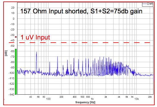

Here is an actual measurement showing the spectrum of rectifier switching noise before being corrected. It's band limited because it's being electromagnetically picked up by a shielded input transformer from an unshielded toroid power transformer some 10 inches away.
This is below the noise floor of a lot of sources (it's a microphone preamp) i.e. not usually audible but 10 dB above the noise spec. for the gear.
PS Other plots using this setup reveal that all samples of D3a ring at about 15 KHz... It's excited by lightly brushing the smooth aluminum case of the prototype unit.

? not sure if this is in reference to my FFT plot but it's not CFLs that produced this but a 60 Hz full wave rectifier using UF4007 diodes and a relatively high DCR toroid with 3 inch leads from the toroid to the rectifier. It's powering 2 D3a filaments and about 50 mA of B+ at ~250V.
The 120 Hz pulse train produces a series of harmonics from 120 Hz on out. There is also some 60 Hz from the transformer leakage.
The noise is transmitted electromagnetically from the mains toroid to the input transformer of the mic preamp about 10 inches away. Diode snubbing, transformer relocation, and shielding were all helpful in eliminating the noise.

This is a signal picked up by a shielded transformer 10 inches away from a power transformer radiating the diode rectifier switching noise? That looks like plain old 60Hz tranny hum like the stuff my phono cartriges pick up when they are within 2 feet of an amp.
