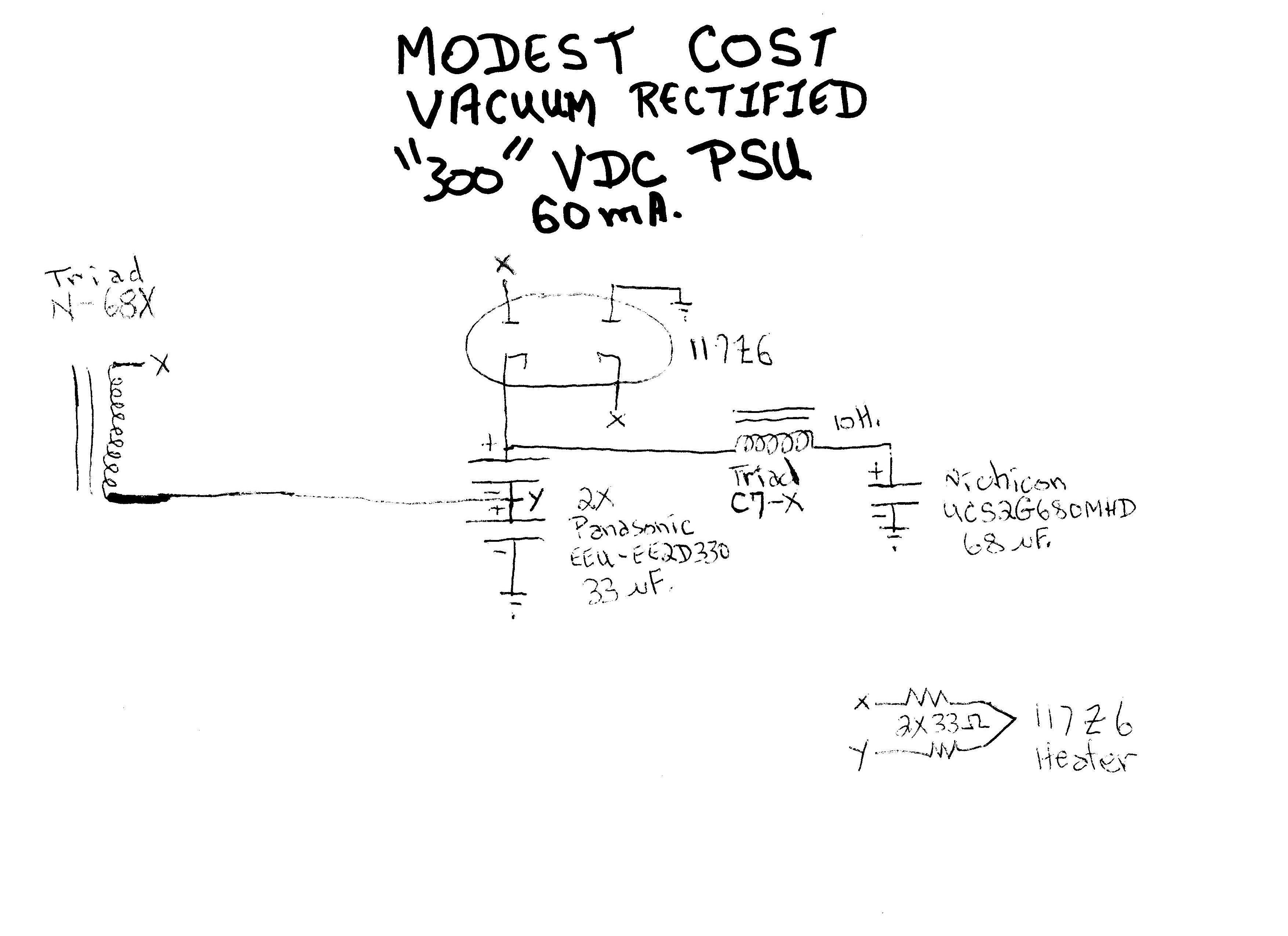

I think in the small signal situation, a place still exists for "hollow state" rectification. Cheapskate that I am, moving off the beaten path appeals to me. A low cost vacuum rectified "300" VDC preamp supply is provided.
