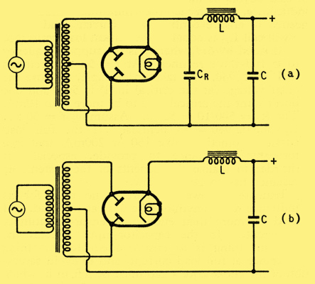

Hi guys,
Need some help. I'm gonna custom wind a transformer for a pair of 01A's.
The circuit requires 235v DC. Am gonna use 5AR4 rectifier for this, yes am
aware that it's an overkill but I already have them on hand. The idea is a single
supple to feed the pair of 01As via 30H 40ma choke per tube with a DCR of 615 ohms. Question, what is the AC HV voltage that is to be wound on the transformer ? Downloaded PSUD2 but am unable to get the results. Perhaps it's my ignorance
Many thanks in advance

02GF74
2010-07-13 1:38 pm
Choke, also called inductor is in simplest form a wire coil whose purpose is to make it difficult for ac signals. I cant imagine there will be voltage drop across it to worry about.
How exact is the requirement for 235v. Are you able to tweak component values to use lower dc supply, say 200v?
How much total current do you need?
Do you intend to use a capacitor-input rectifier (a), or a choke-input rectifier (b)?
Perhaps a pseudo choke I/P filter will help, in this situation. Hybrid bridge rectify the O/P of an isolation transformer with 2X Cree C3D02060F Schottky diodes in the ground legs and a 5AR4/GZ34 in the "hot" legs.
Set the filter up as cLC. The I/P ("fudge factor") cap. needs to be held below 1 muF., in order to maintain critical current behavior. The "fudge factor" cap. tweaks the rail voltage upwards and, quite important, protects the SS diodes from inductive kick back spikes.
Don't forget a 30 Kohm bleeder resistor across each of the reservoir capacitors.

Yes Merlind I do intend to use circuit A. In reality each tube only consumes around
4 ma. From pass experience of course under higher cuurent loads, the choke does
lower voltage quite a fair bit. For this application though tube current is minimal,
the DCR of the choke that Im using will definately lower the voltage. Hence the need
for help to calculate actual voltage drop under load.
Circuit is optimize for 235 volts 02GF74.
thanks guys for the advice
Thanks Merlinb. Sorry for AC to DC using tube rectifier, is the conversion 1 : 1 ?
Also 02GF74 suggestion of making it an isolation trans does sound nice not 1 to 1 but
maybe slightly higher, would appreciate your thoughts
Thanks again
The conversion from AC to DC value depends on the filter type used and the losses associated with the rectifier(s), regardless of their technology.
For cap. I/P filters, the DC voltage = (VRMS) (21/2) less losses
Forward drop in 5AR4s is comparatively small, especially when the draw is well below the 250 mA. allowable maximum.
