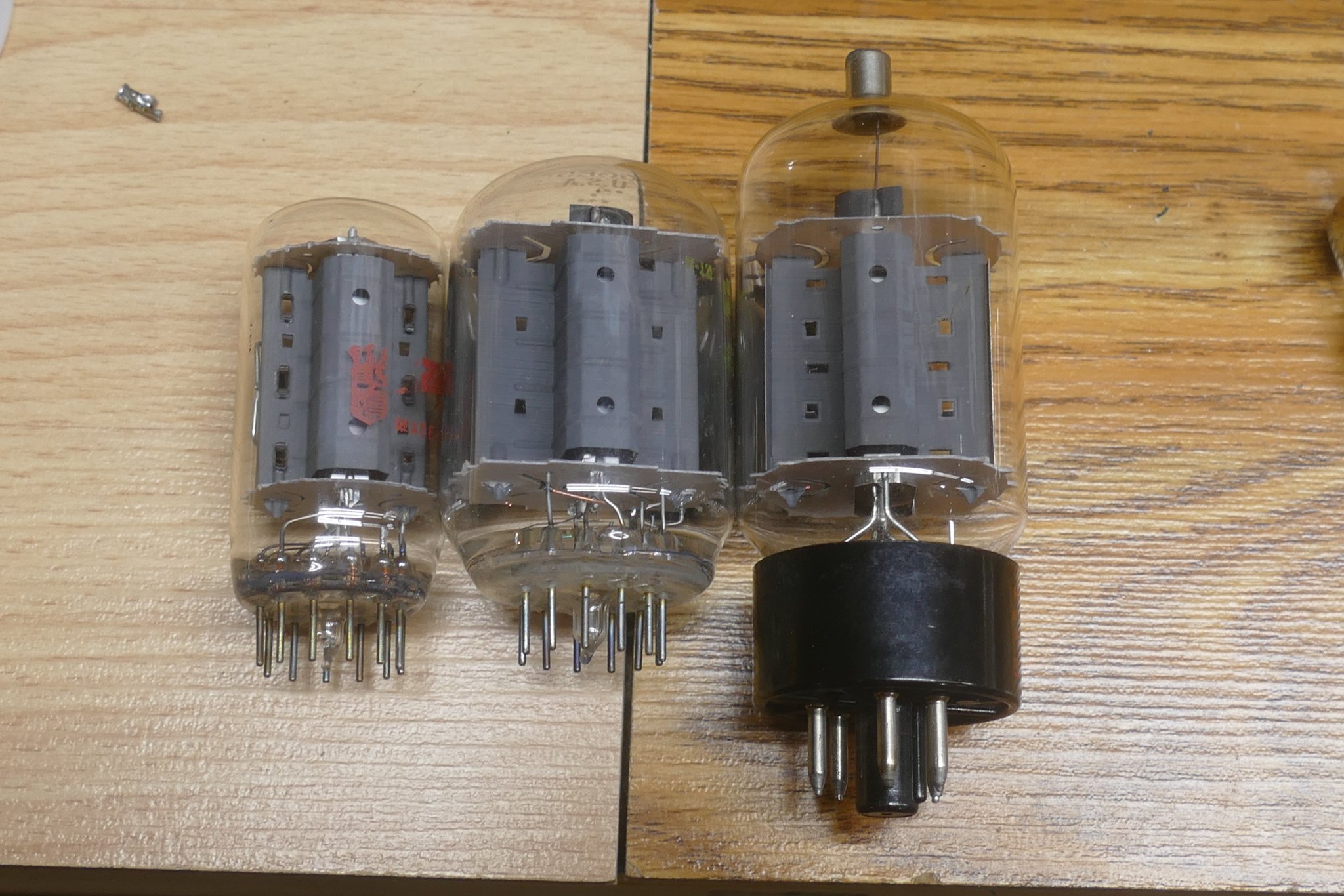

One day while wandering through the ESRC warehouse I discovered a tiny sweep tube called the 6GF5. It looks like a 6GE5 with its plate wings clipped, stuffed into a skinny bottle. The 6GE5 is simply a 6DQ6B in a compactron bottle without a plate cap. Stan had never sold any, so I got a BIG box full cheap. I eventually found a data sheet that leads me to believe that it is a shrunken 6GE5. I have seen 80 watts from a pair at under 3% THD without any glow. The picture shows a 6GF5 on the left, a 6GE5 and a 6DQ6B. the board uses 6GF5's in UNSET push pull.

I seem to recall one 6GF5 "shaking in it's boots" next to some of the "big bad boys" on the bench some while back. (35LR6, 6HJ5, 26LW6, ....) The 6GF5s have done well. They curve trace very much like the 6GE5 and 6DQ6B.
I tried some 6GC5 tubes next to each other on the 9 pin "tube rails" here ( 1-5/16" spacing ) and they almost touch each other. Like 3/16" gap. 6GF5 is the same 1-1/8" diameter, but a Compactron base. The regular 9 pin tubes have 1/2" spacing ( 13/16" diam. tubes ). If I make some similar ( from 22" long 2" wide Aluminum angle ) rails for 1.5" diam. Compactrons, there will be room for only 10 tubes. But then a 240 Watt 6HJ5 rail would be impressive still. Maybe two groups of 5x 6HJ5 for P-P. (Well, I've only got 100 Watt Edcor and Hammond OTs. Maybe I need to split those further for stereo.) Don't think I'll try to tackle plate cap type tube rails.

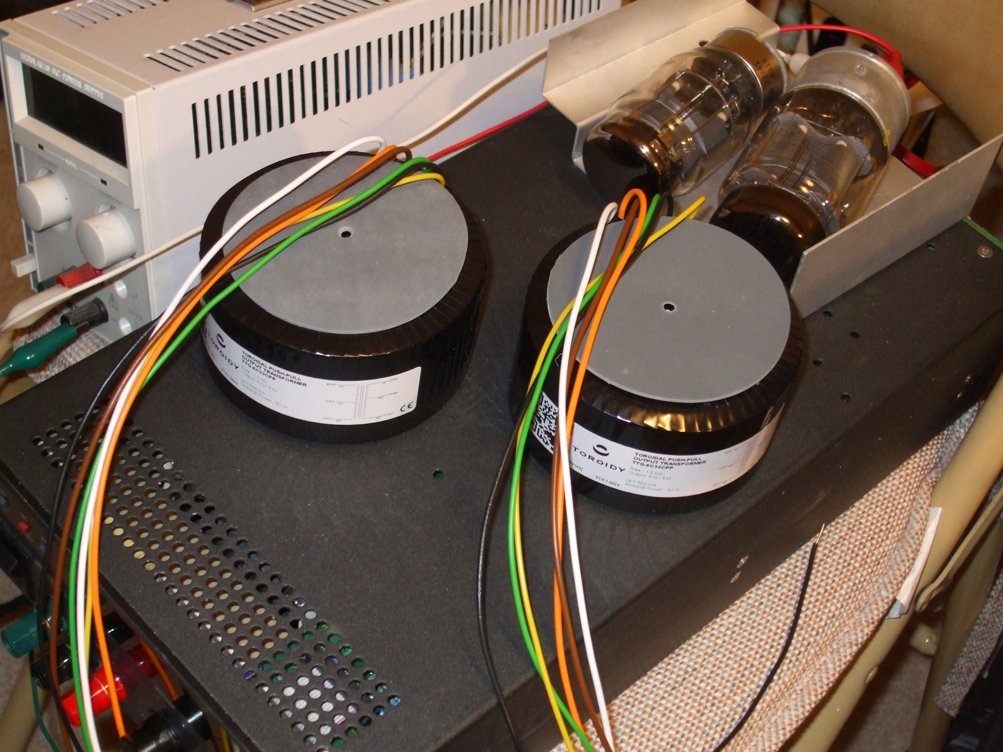

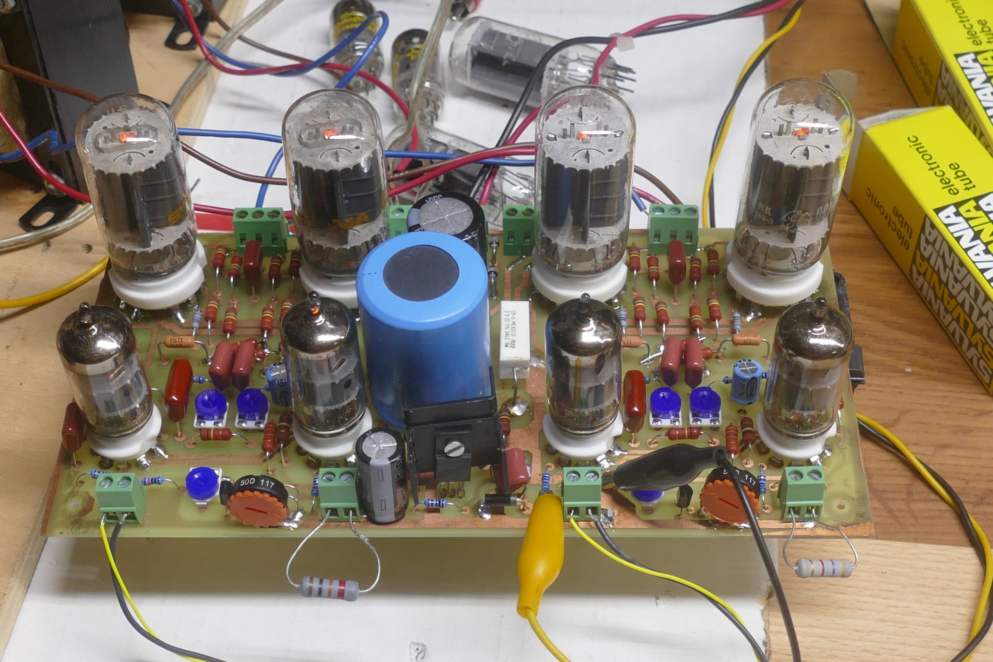

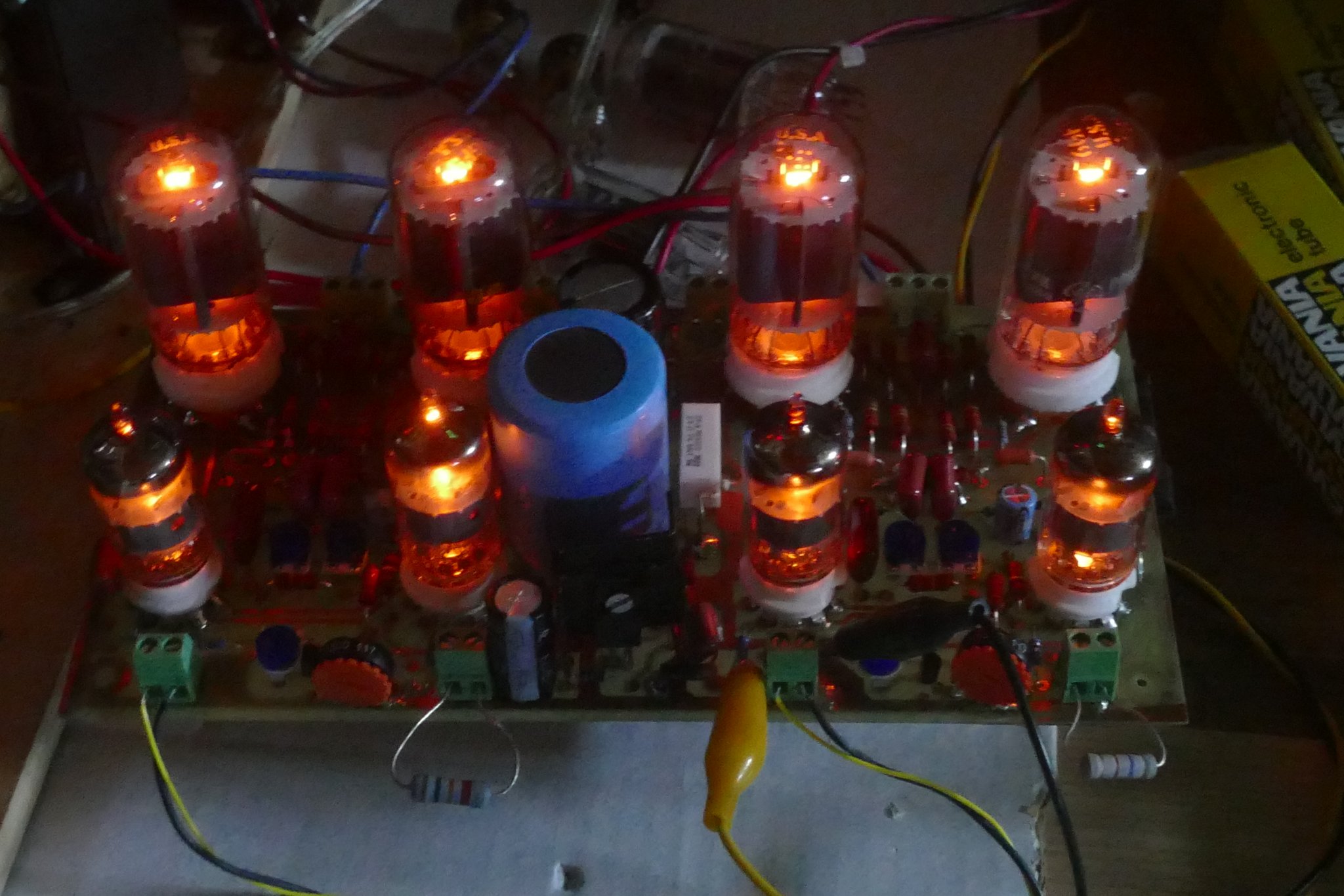

I got my Toroidy 1200 Ohm P-P 80 Watt OTs in. TTG-6C33CPP Now I can do experiments with 6+6 10 Watt tubes on the "tube rails" or the OTL cheat patent experiment using 6528 big 60 Watt regulator tubes. (and try some TV Sweep tubes too.) Either 80 Watt with the OT or 8 Watt in OTL configuration. US patent (Audio Precision) US4614914, allows removing the xfmr artifacts (magnetizing current and primary resistance ) so that the OT will be completely transparent.

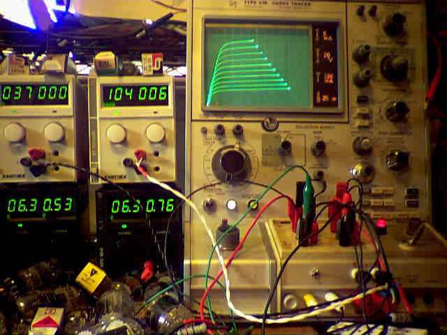

That's the Xantrex XHR 0-7.5 V 130 Amp Bench supply I dragged up from the basement to try and light up a 7241 tube (on top there with a 6528 tube also).
The 7241 had air in it. I have to return it for a refund. (it was only $50, I should have guessed ) Otherwise I would crank the V up and turn it into an arc lamp. (Tubelab style) I'll be staying with 6528 or 6336 for big tubes, SO much cheaper and new.
During the DOT COM crash, years back, I stocked up on various Xantrex bench supplies. I could get the XHR 1000W models (not working) for $50 to $75 and then fix them. Got 600V, 300V. and 150V. 100V models for tubes (or SS). Xantrex XT250V models for screen grid supplies, HPD60 supplies for heaters. XT120 models for biasing. The prices on Ebay now are just shocking.
