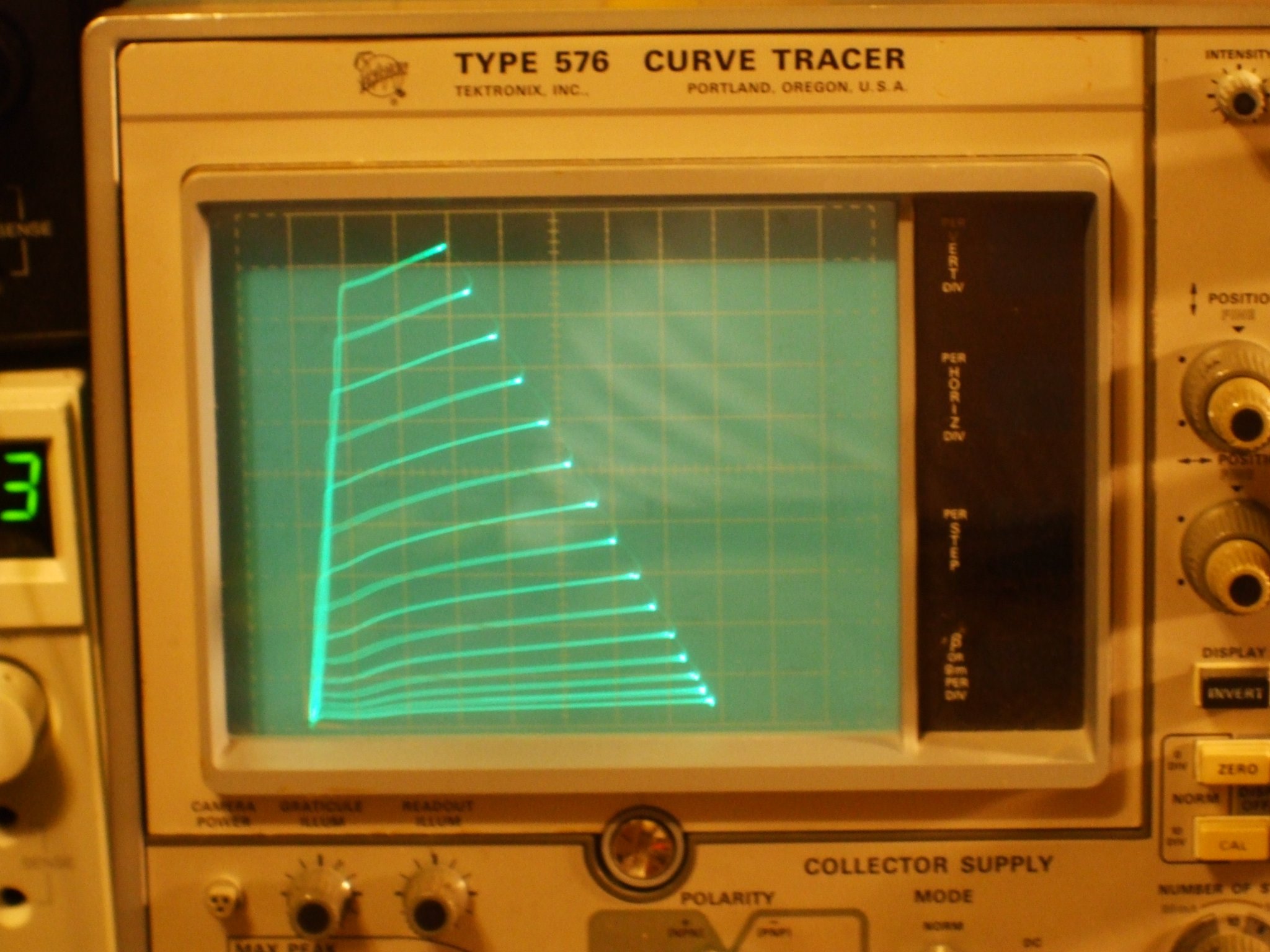

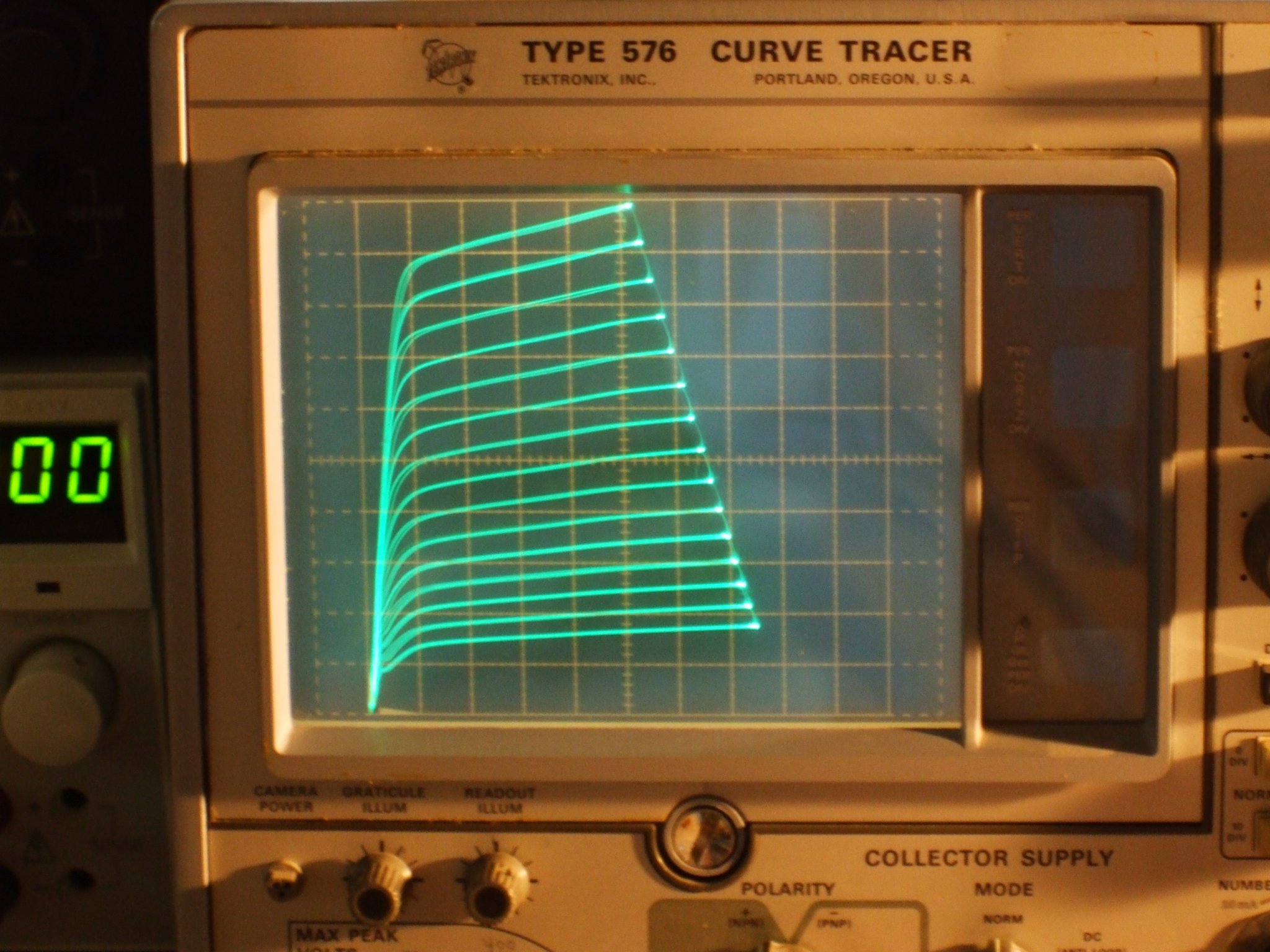

For someone with a 9 pin setup, the 6GC5 and 6DB5 are both 6W6 types in a 9 pin bottle. The 6DB5 is a about the same size as a 6BQ5 / EL84 and has a 10 watt plate rating. The 6GC5 has a fat 9 pin bottle with full size 6W6 guts inside carrying a 12 watt plate rating. I have seen 35 watts flow from a pair of 6W6's but haven't beat on the 6GC5's yet. I only have a few of them, but I have lots of 6DB5's.
From your list the only tubes that I have a good supply of is the 6197 and its sibling the 6CL6. There are probably lots more candidates for "science experiments" that are stashed in my storage trailer next door. I'll go take a look tomorrow.
There has been a 6AR8 rolling around on my desk for several years. Don't know where it came from. It might find its way into a guitar amp experiment soon though. I don't think I have any more BDT's though.
Looking in my GE "Essential Characteristics" Handbook for the 6DB5, I see scribbled in "good in triode", but the 1.2 Amp heater power consumption is too high for the crummy 55 mA avg. rating. 6GC5 does a little better at 65 mA avg. 12/6GE5-12/6JN6 do 175 mA on 1.2 Amp heater.
6197 only takes 0.65 Amp for the 6.3V heater and still does 50 mA Avg. I've been impressed by the pentode and triode mode curves for them. 6197 GE MIL contract tubes I have here in abundance from a sealed box, and they seem to be nearly all matched, box of 200. Maybe was an expensive contract! I got them cheap.

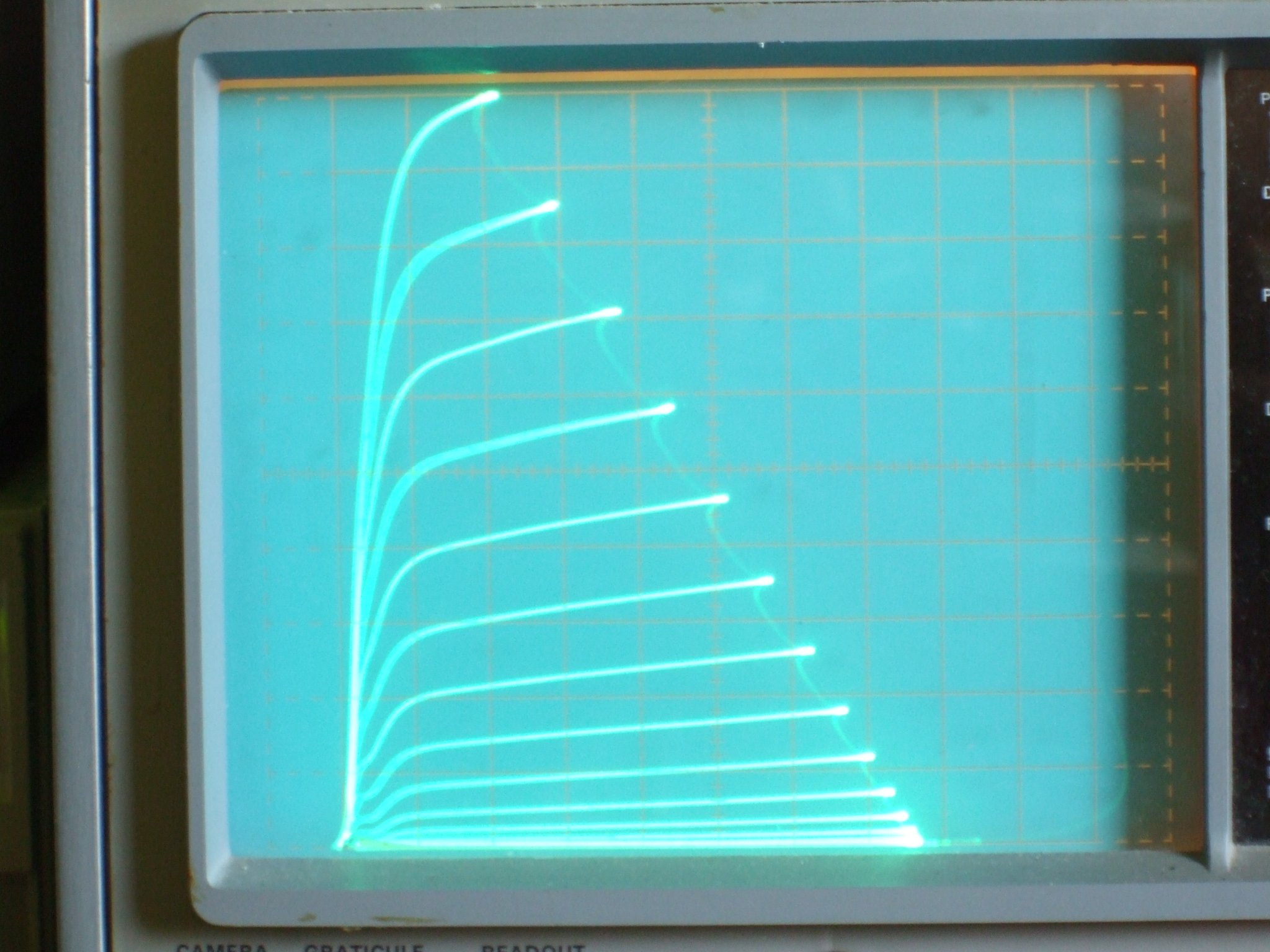

The 6197 is a 6CL6 with a cathode built for possible long term operation without current flow. This is mandatory for computer use where the tube is either non conducting or saturated for its entire life. I know that I had a LARGE quantity of these from a lot of over 100,000 old tubes that I got about 30 years ago. All were pulled from "military spares" and presumed to be good. The 6AQ5's that were intact with usable pins were indeed mostly good. They had been in an abandoned warehouse in central Florida for an unknown length of time before they were found when the old wooden warehouses were being demolished for a housing project. Vandals had trashed most of the large tubes and all of the windows in the building, and even the vagrants had left, leaving lots of broken glass (tubes and bottles) and bird crap everywhere.

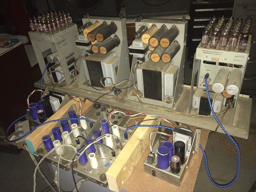

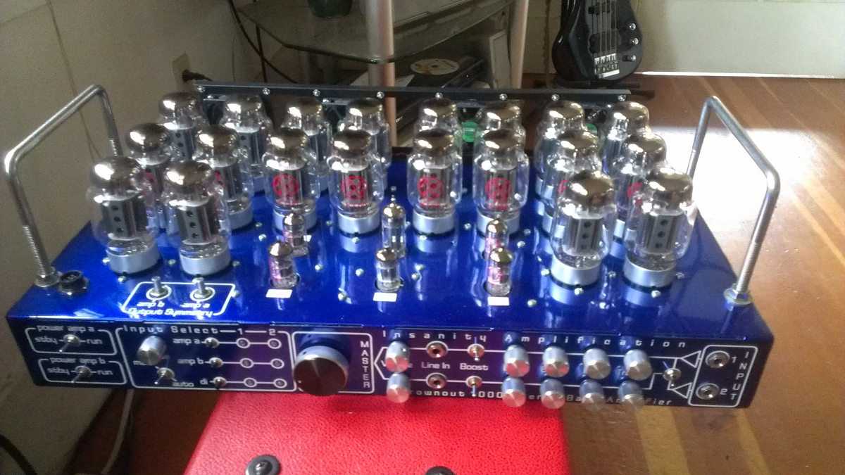

Somewhere in my brain was an image of a radial aircraft engine styled tube amp with 6 or 8 tubes. I remember seeing it pictured somewhere, and since it provided the inspiration for my "V" engine styled amps, it had to be before 2005. Google can't find it.Watcha need is a star engine, sockets in the middle for shortest wireing, tubes pocking out into the air for optimum cooling

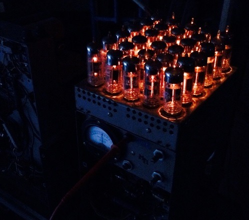

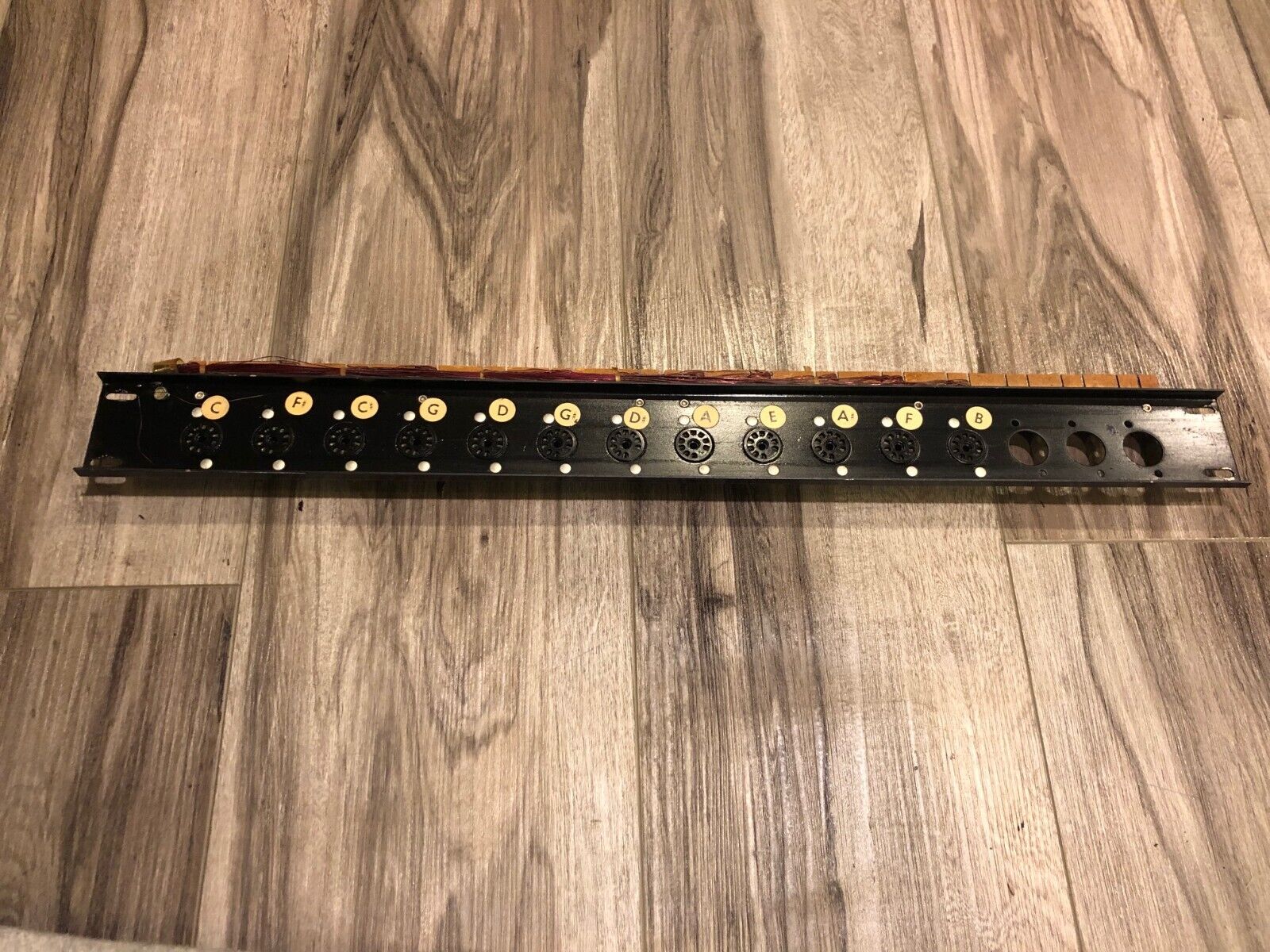

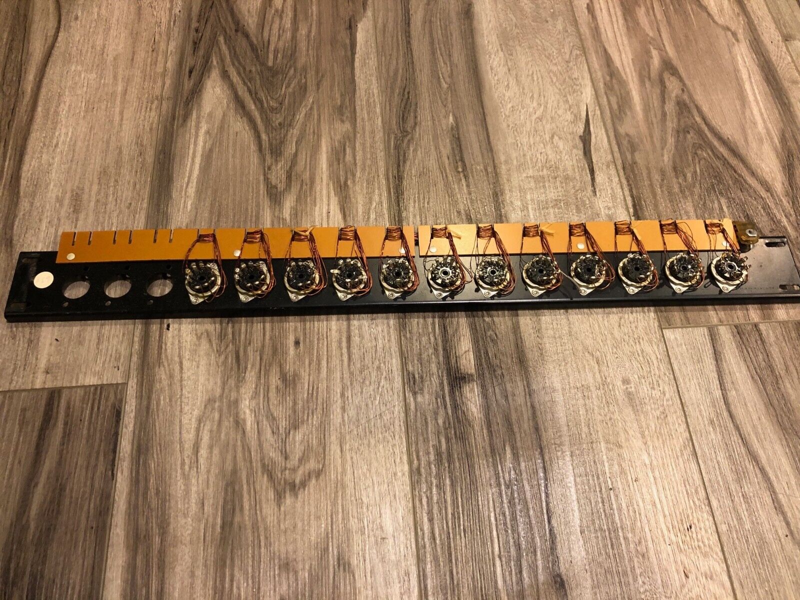

I tried some 6GC5 tubes next to each other on the 9 pin "tube rails" here ( 1-5/16" spacing ) and they almost touch each other. Like 3/16" gap. 6GF5 is the same 1-1/8" diameter, but a Compactron base. The regular 9 pin tubes have 1/2" spacing ( 13/16" diam. tubes ). If I make some similar ( from 22" long 2" wide Aluminum angle ) rails for 1.5" diam. Compactrons, there will be room for only 10 tubes. But then a 240 Watt 6HJ5 rail would be impressive still. Maybe two groups of 5x 6HJ5 for P-P. (Well, I've only got 100 Watt Edcor and Hammond OTs. Maybe I need to split those further for stereo.) Don't think I'll try to tackle plate cap type tube rails.
I recall seeing an OTL Amp with box-like rails above the tube rows for all the plate caps. And whoever bought all those 13GB5 tubes are probably dealing with them too.
Which reminds me that I should look for some U or double L strips to cover the tube socket wiring for the rails.
I don't think I'll ever be trying OTL designs with lots of tubes. Only thing close will be 2x 6528 tubes for trying out the OTL cheat patent # US4614914 with an 80 Watt 1200 Ohm P-P Toroid OT ( Toroidy ) versus OTL configured. ( like only 8 Watts OTL )
