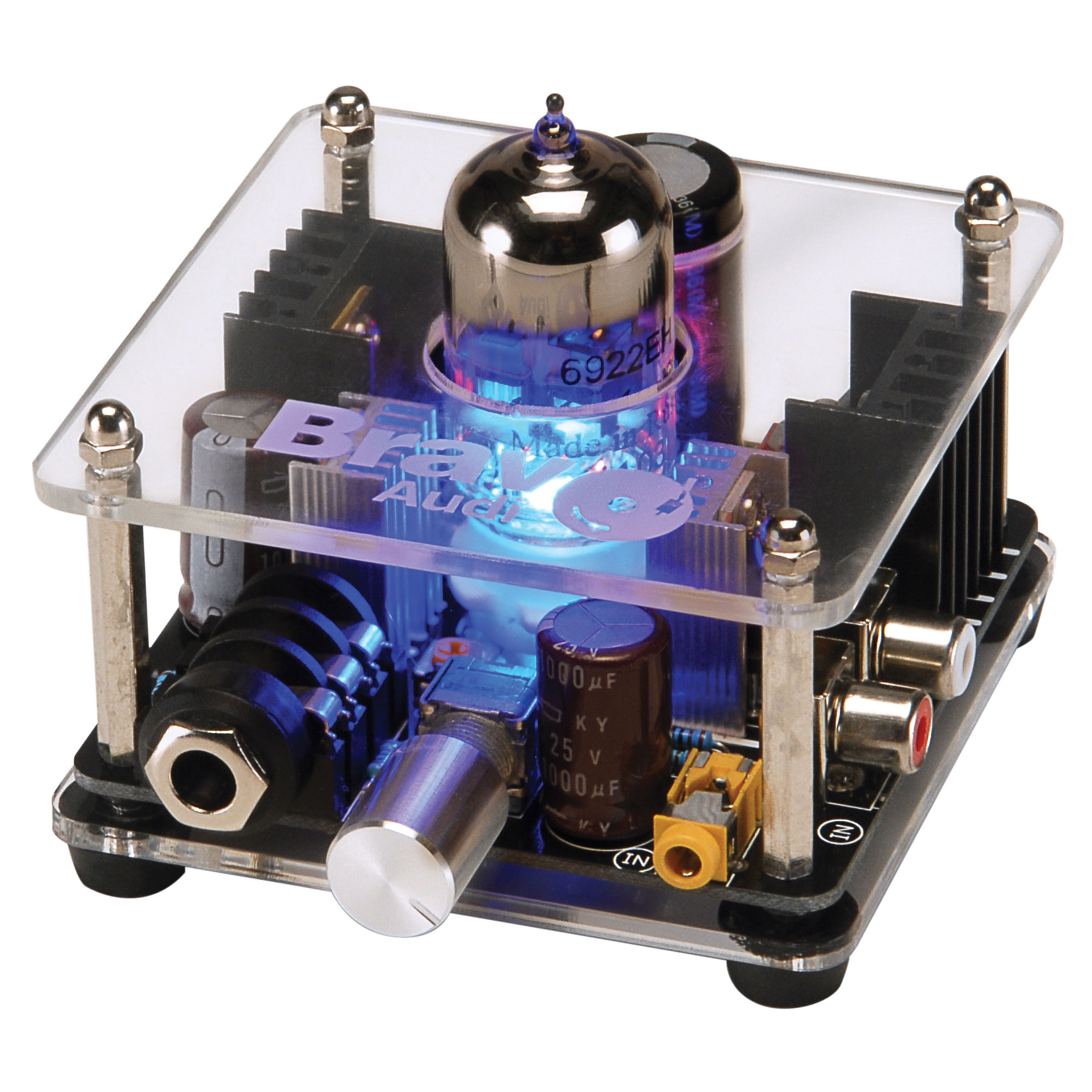

Ive decided on the Bravo Audio V1 http://www.amazon.com/Bravo-Audio-V1-Headphone-Amplifier/dp/B00A2QKTLW/ref=sr_1_2?ie=UTF8&qid=1460591998&sr=8-2&keywords=bravo+v1
This has the Russian EH 6922 Tube for amplification.
That will probably be a decent introduction to tubes for you. I'd guess that this is a tube + MOSFET design, not unlike Pete Millett's starving student amp.
Might have more gain than you need, might be more linear if it were higher voltage, but it will probably sound OK and can always double as an extra headphone amp.
Thanks for your comment Sodacose but unless I'm wrong I think it will work fine ill just solder my speaker's to bottom of the board on that headphone jack but the power should be fine as I have a mixer, 32band dual channel EQ and rack mount crossover with adjustable gain that if needed can boost the tube pre up.

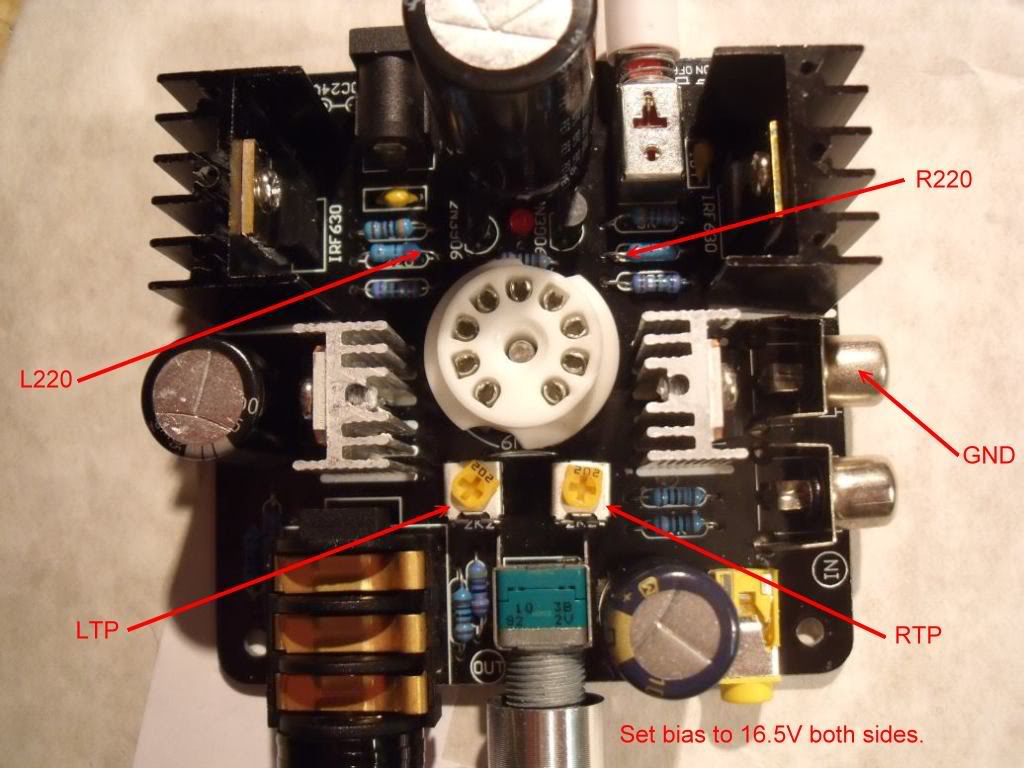

Mods to Bravo V1
Here are some mods to this amp that I found on Parts Express . Out of the box it sounds very good. Swapped out the output caps to 2200 mfd and swapped out the mosfets to IRL510 and WOW! What a difference. No way to beat the value and sound. This sounds very promising ....

ECC82 is the Euro version of 12AU7. Unfortunately for this amp, 12AU7 needs 12V for its heaters, not the 6V used by 6922. If you dropped a 12AU7 in there, not only would it be working at super-low plate voltage, it would also be working with starved heater. The tube would work with very weak performance (lower gm, lower gain, higher internal resistance).
Referring to Merlin's article, it does look like this headphone amp circuit has some serious compromises. The one that sticks out for me is the low input impedance of the input triode run with such low plate voltage (16V). In this headphone amp, the wiper of a volume control goes straight to the input triode's grid. The output impedance from the pot is going to vary, and the input impedance of the tube is low, so the two will interact.
I was looking at the "Starving Student" amp, originally published by Pete Millett. It originally used two 19J6 tubes, but the supply of these little tubes dried up. A couple of people modified the design to work with 12AU7 tubes instead.
The Starving Student uses a 48V DC power supply instead of 24V, and parallels two sections of a 12AU7 for each channel, running them with about 26V on the plate and 1.3V on the cathode (650uA plate current). Maybe that's enough to keep the 12AU7 out of grid current territory.
The other big difference is how the Starving Student Amp's output IRF510's are biased. The 12AU7 plates are RC coupled to the IRF510 gates, the bias for the IRF510 is derived from a voltage divider (R2, R4 and R8, R10), and the sources of the IRF510's are fed from the +12V from the DC heater supply for the 12AU7's, with no LM317 or other CCS used.
But maybe all this is not important. It looks like Pete M and dsavitsk do the same with the volume control as is done in the Bravo V1.
Maybe the whole idea of running these tubes with such low plate voltages is to get lots of tubey distortions happening and use the amp as a sort of euphonic effects box. Nothing wrong with that. I was thinking of putting together something along those lines and using it at work for playing Pandora, etc. Would take the edge off the digital compression artifacts.
Did you all notice that the Bravo V2 uses the DC heater voltage to feed 6VDC to the LM317 CCS for the IRF510 source?
Also, the Bravo V3 uses a 12AU7 and 12VDC heater, to the LM317.
So it looks like they're all derived from the Starving Student, just re-jiggered to work for a 24VDC supply (and resulting 16V on the tube's plate, which will raise the distortion, etc.).
