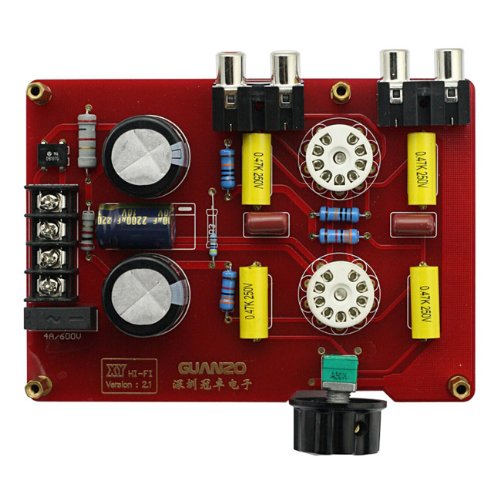

There are a number of different tube buffers being sold at Amazon and Ebay which is a good place to start economically. Be forewarned though it may put you on a path to spend considerably more.
Do you mean extra cost for a power supply transformer ?There are a number of different tube buffers being sold at Amazon and Ebay which is a good place to start economically. Be forewarned though it may put you on a path to spend considerably more.

One single ended tube in a preamp will inject the more natural distortion spectrum shape into the mix. If the poweramp is as clean as most are these days, the tube distortion, small as it is, can dominate, and give you a bit more warmth. 6SN7 is a top recommendation, but 8mA is enough according to the graphs I've seen. If you want to be exotic, you could follow it with a cathode follower buffer, and even replace the plate load resistor with a current sink, which will improve linearity, increase gain and perhaps most importantly give you much better rejection of power supply hum.I did this in a power amp I built.
No, The path of spending more money for tube gear.
Thank you so much Bob ,Ill keep this in mind ,i will probably just buy a prebuilt off Amazon. dont wont spend much as I already have quite bit in the SS... are the Russian made Electro-Harmonix 6SN7 EH Vacuum Tube any good ?
A 6SN7 operating at around 150V on the plate 300ish B+ and 12ma is a very nice sounding preamp. IT'll have inherently low THD and may be more neutral sounding then "tubey".
Highly recommended.
Look at the tubecad kits.
Thank you Scholl, but to see just how well a tube will enhance my SS I think I'll just buy a pre-built of Amazon rather stick allot money in the tubecad kits . those are very nice kits and I like how you can customize your kit . Maybe later.
Sanci Smart tube pre amp
I was actually thinking about a Sanci Smart http://www.amazon.com/dp/B008BGLN5G/ref=wl_it_dp_o_pC_S_ttl?_encoding=UTF8&colid=3RWG6NP4Q4X1V&coliid=I1PN449I0CFF5J it comes with its own transformer for hook up and play. Ill just drop this into my SS inline after the potimeters...
Consider sticking with the single ended tube common cathode type gain stage with just resistors. I find they sound best. I theorize that adding constant current sources or going SRPP may be better for noise, drive and specs. but they diminish tube sound. Not as nice.
YMMV
YMMV
YMMV
I now own a very simple tube pre as you describe but I am in the process of building the "cleaner" SRPP pre just for comparison. I love my simple tube pre with SS amps. I feel like the SRPP is going to be more like a SS pre but you never know until you try and I like to build.

Scholl, please bear with me Bro. as I,m a greenie to tube amps ,you say stick with a single ended tube ? what is single ended ?
