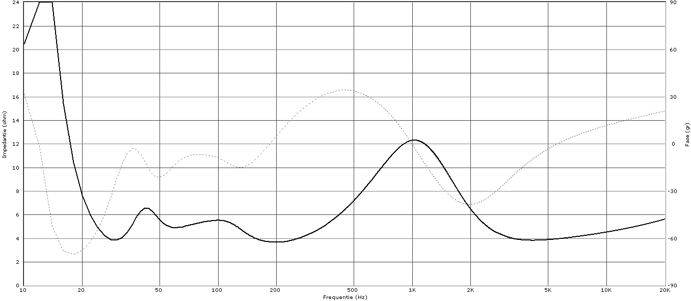

I've been testing my speakers alongside Paradigm S40, S20, Pioneer Quartet 70. All the speakers exhibit digital glare on solo piano music. Differences in the parallel and series fed crossovers was quite noticeable in this test. Compared with other speakers, the DIY series fed crossover has more presence, forward, dynamic, musical, and transparent sound. On vocals, it sounds magical with air, openness, presence. But on piano recordings, the digital glare is there especially in 700-1kHz range. The RTA revealed peaks at 700-900Hz (2dB), 2kHz (1.5dB), 3kHz (1.5dB). Amazing how much 2dB makes in the mids.
Then I decided to vary the value of the tweeter attenuation resistor from 0.68 to 0.82 Ohm. Digital glare improved slightly with a nice balance using 0.75 Ohms. The "digititis" is more tolerable now. Then I changed the Mundorf Supremes to Rike Audio S-Caps PIO, and all the MOX to a Jantzen Superes, and the Mundorf L200 coils to Jantzen wax foils. Wow! It's as if I switched from digital to analog! The digital glare was even more tolerable, and the piano registers were clear with no stridency. Spatial imaging, air, and transparency is the same, but somehow there is less grain than before. Below is a plot of the impedance and phase.
