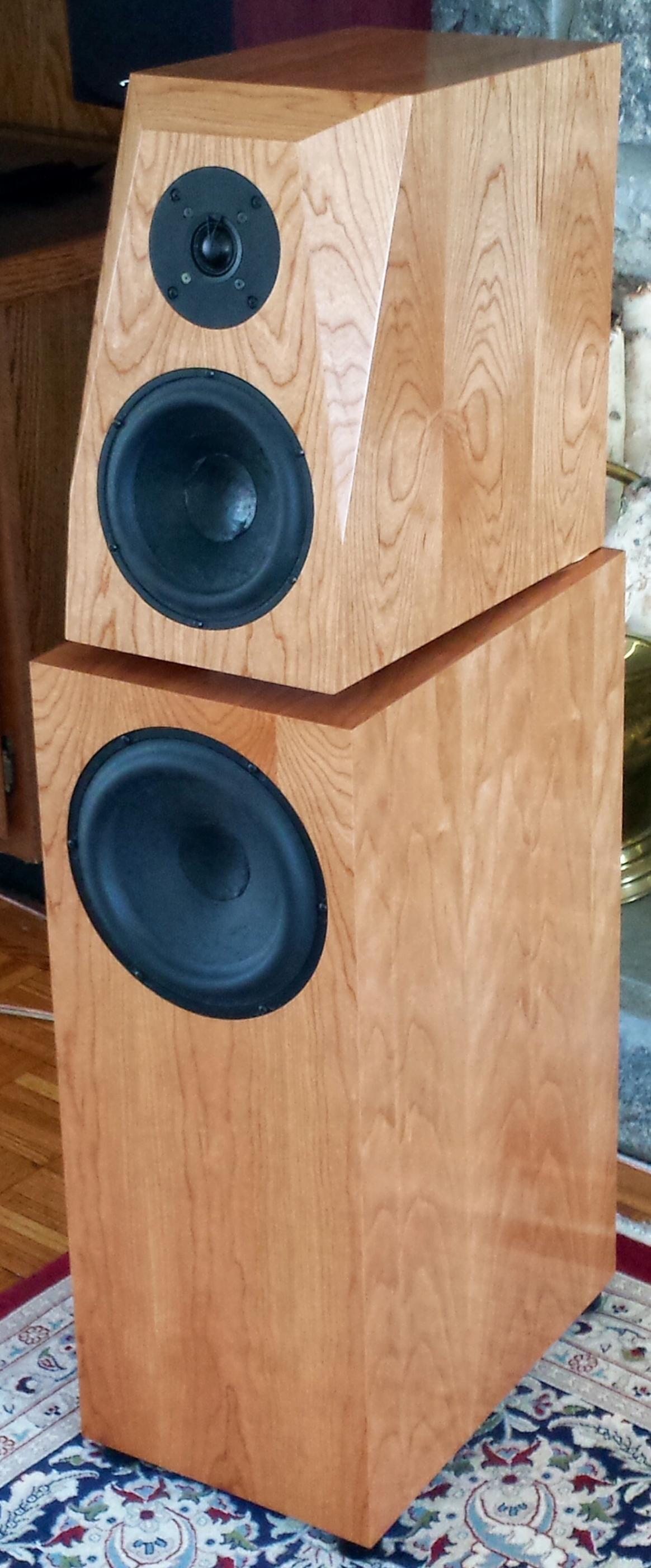

Your speakers look like a wonderful project but from someone who has built lots of genius speaker ideas that sounded like Doo-Doo, take it from me, build some based on a design that's been tested, measured and has agreement it sounds good: Pi, Audio Note Kits, Madisound, Zaph Audio, etc

Thanks for the good ideas! Agreed Jean-Paul, it's difficult to control the direction of any thread, but I am thankful for the great ideas in a open round table type discussion, be it over "tea" or beer.
Feel free to change the title to "Tube Preamp: Remedy For Digital Glare? Sources Of System Weaknesses."
When I started the thread, I thought that having a tube preamp in the chain could provide a neutral and holographic sound, and the Aikido seemed like an easier project. I didn't address digital glare from the outset because I just assumed that the inherent "warm" nature of some tubes could tame digital glare as a byproduct. I know I am not the only one who hears digital glare, nor am I the first to assume "tube treatment" as a possible remedy.
I've been testing my speakers alongside Paradigm S40, S20, Pioneer Quartet 70. All the speakers exhibit digital glare on solo piano music. Differences in the parallel and series fed crossovers was quite noticeable in this test. Compared with other speakers, the DIY series fed crossover has more presence, forward, dynamic, musical, and transparent sound. On vocals, it sounds magical with air, openness, presence. But on piano recordings, the digital glare is there especially in 700-1kHz range. The RTA revealed peaks at 700-900Hz (2dB), 2kHz (1.5dB), 3kHz (1.5dB). Amazing how much 2dB makes in the mids.
Then I decided to vary the value of the tweeter attenuation resistor from 0.68 to 0.82 Ohm. Digital glare improved slightly with a nice balance using 0.75 Ohms. The "digititis" is more tolerable now. Then I changed the Mundorf Supremes to Rike Audio S-Caps PIO, and all the MOX to a Jantzen Superes, and the Mundorf L200 coils to Jantzen wax foils. Wow! It's as if I switched from digital to analog! The digital glare was even more tolerable, and the piano registers were clear with no stridency. Spatial imaging, air, and transparency is the same, but somehow there is less grain than before. Below is a plot of the impedance and phase.
