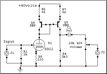

great prog, but probably is someone here who already knows better how to use it.. I will try to recalculate CF with +/- 50V, but I am not fell sure to my work..
please, I need just a moment of your time...
thanks
I can only see the 12AX7 triode and all others are greyed out. Is this what you mean by tube models? If I'll be using 6922 or 6DJ8, what do I do? Sorry for the questions.

I am newbie and I have a lot of problem to recalculate elements values for CF, driven with +/- 50 V (100V)....also I dont understand quite about adding a diode between the grid and cathode of the cathode follower, to make a soft start....
thanks federico...
Hi trancy.
no it does not make a soft start.
If you have a normal start the grid of the second tube
will go at 165V ( or 280V) since the heaters are cool and
the tubes initially do not conduct.
This is very dangerous since when the heater become
hot and start to conduct that is the risk of too great current.
so the diode in such a place is to avoid this and to protect the tube.
I again advice you to download a free copy of Micro Cap 7 demo at
http://www.spectrum-soft.com/demodown.shtm
bye
Federico
