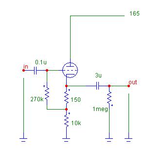

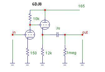

great prog, but probably is someone here who already knows better how to use it.. I will try to recalculate CF with +/- 50V, but I am not fell sure to my work..
please, I need just a moment of your time...
thanks

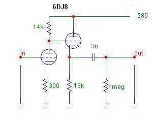

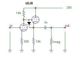

)....also I dont understand quite about adding a diode between the grid and cathode of the cathode follower, to make a soft start....
Hi trancy.
no it does not make a soft start.
If you have a normal start the grid of the second tube
will go at 165V ( or 280V) since the heaters are cool and
the tubes initially do not conduct.
This is very dangerous since when the heater become
hot and start to conduct that is the risk of too great current.
so the diode in such a place is to avoid this and to protect the tube.

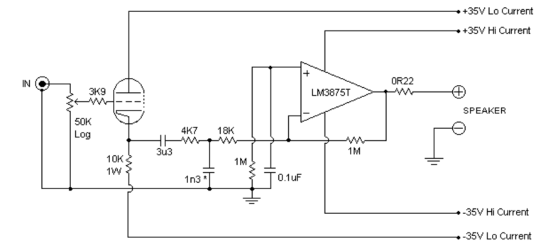

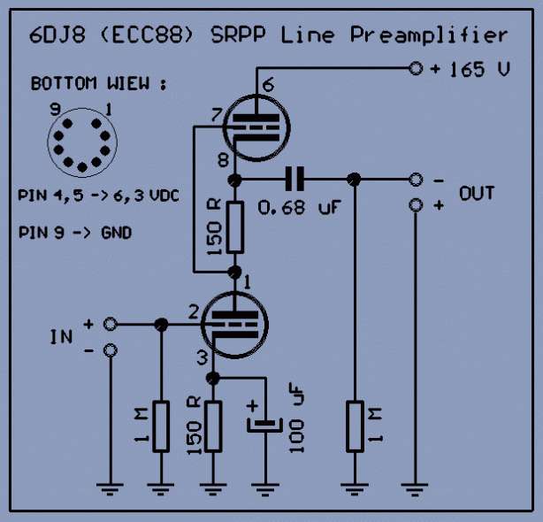

HI!
Is it possible to use this preamp for a ZEN amp or for what is it good for, except for nice background illumination? 🙂)
Thanks!
Tyimo
