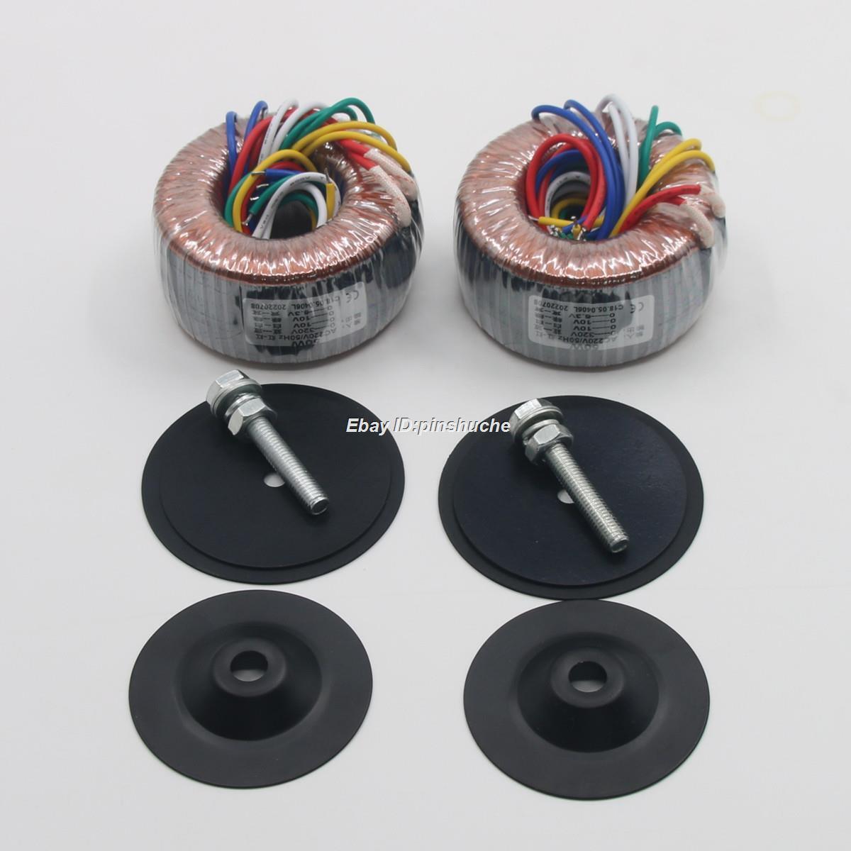

Let me know what you guys think, the seller recommended these transformers:
https://www.ebay.com/itm/164561307729
However I'm wondering if there's anything better that would improve the sound, what transformer and 6Z4 tubes do you recommend?

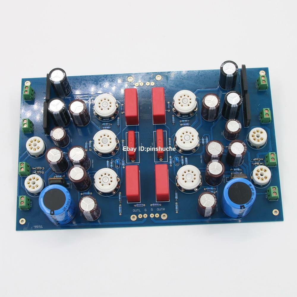

Hifi 6Z4 +12AX7 SPreamp Board /Kit Base on France JP200 Preamplifier:
https://www.ebay.com/itm/164561341392?var=464128057395Let me know what you guys think, the seller recommended these transformers:
There's something wrong if you say transformers...in a car!
Probably you want to install a DC/AC converter, so 12 VDC>120 AC then Transformers!
An elegant way is to take power for HT directly from 12 V DC and use a switching circuit to elevate potential to 200-300 V.
But you don't need it!
The warmth & sweetness of the sound don't depend on the particular circuitry, well, substantially you would want to use transistors where they're needed ( line level) and tubes for power.
The second one is not going in the car.. It's for home. So you can recommend some parts.
The 7 pin pentode 6n1 or 6n3 is about 1 inch tall easier to fit 2 into the head unit as opposed to 12ax7. A small buck boost circuit can do the B+ of 40 to 50v. The 12v may work for line levels.
