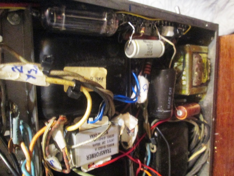

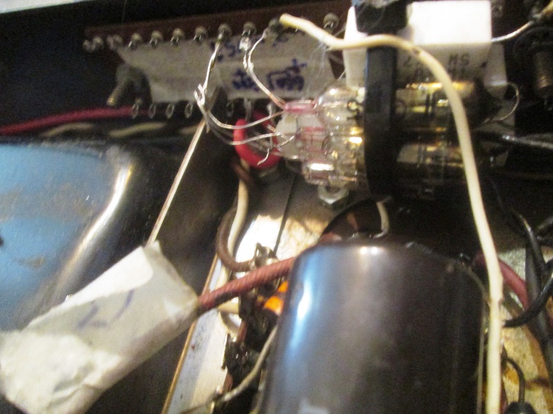

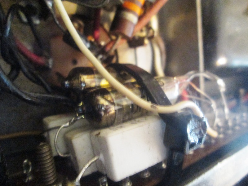

It strikes me people are putting chokes in, where they don't help at all.
Here is a stabiliser I built up somehow, shoehorned into the guts of a MO200.
There is absolutely no room under the chassis of that thing.
It's all built up of a single tag board.
The gas stabs are wired across the main 675V HT line to give a static current of 9.5m/a, in 150V steps, giving 150v, 300v, and 450v references.
They consume less than zeners (1.4w each) are more stable, and produce less noise.
I could even squeeze an old partridge choke in there to take the hum out of the screen grid circuit.
That's the point, it's pointless doing chokes for supplies which are not ripple sensitive.
That little triode is wire ended.
A brilliant little thing that supplies ripple free 320V to the entire dual AF amp and driver stage. No matter what happens in the main current loads, it doesn't budge.
Anodes are pretty impervious to AC ripple, for the simple reason 1/ it cancel out, and 2/ the gain change of the anode circuit is insignificant compared with poor ripple rejection inherent in single ended class A drivers and poorly decoupled gain compression when HT sags.
Screen grids are very sensitive to AC ripple, which is why they often end up recycling and pumping hum and noise.
AF amps because of proper decoupling should be largely impervious to supply noise.
Just saying. Solve the real problem, not the non-problem.

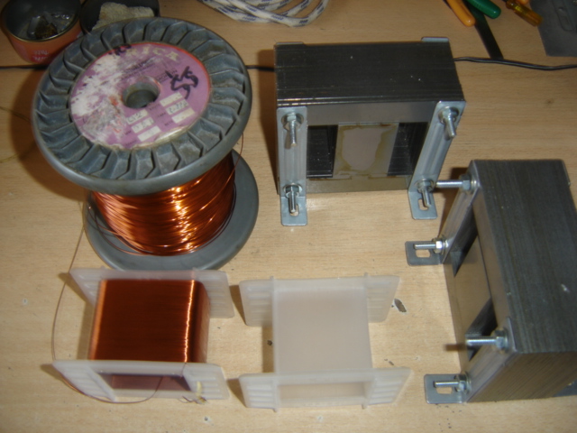

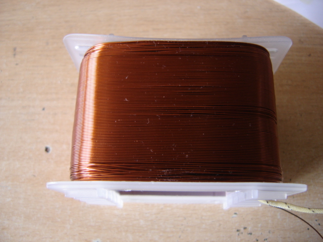

After reading your opinions AND demos i understand now well,that IN AUDIO the tuned choke with a capacitor is not a good solution.
We could have less 100 hz buzz but at the price of more hash in the 200 to 800 hz band.
Thanks to you all...

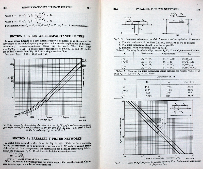

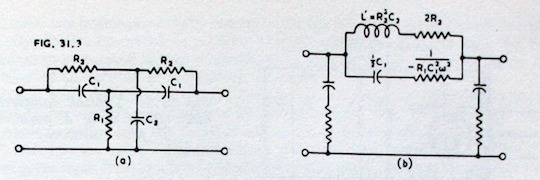

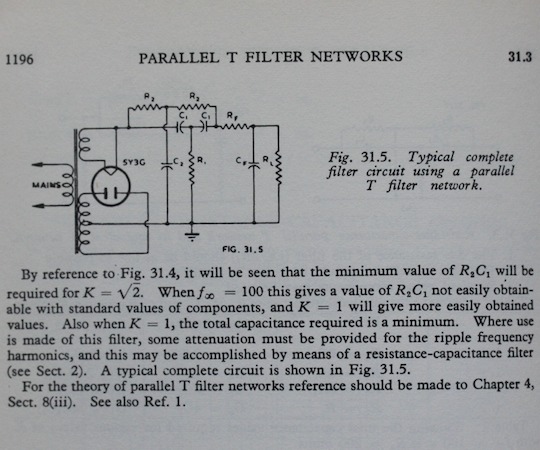

You might consider a parallel T filter network, although one might end up with impractical values...
often, a T filter works best at one frequency.
An unequal balance of full wave rectification results in some fundamental 1 x line frequency coming through.
Unequal DCR in the 1/2 windings of the secondary; un-equal individual plate to filament/cathode rectifier voltage drop; and directly heated rectifiers whose filaments are not powered by a center tapped winding; are examples.
The 2 x line frequency is what many filters attack.
The 3 x line frequency can get through too, & higher harmonics, etc..
Capacitors of a given capacitance and voltage rating are smaller than ever before.
RCRCRC filters the fundamental, and more effectively filters the higher frequencies (the frequencies that we are more able to hear).
A choke makes the filter much more efficient, and rolls the mid and high frequencies at an even higher rate.
For a preamp, you may get by without a choke.
For a power amp, a choke is often needed to reduce power loss.

The twin-T notch can be a useful circuit, but I seem to recall reading somewhere that it has an effective Q of 0.25. This could actually be useful in a PSU application because it means that it attenuates somewhat (not a lot!) over a wide range of frequencies around the actual notch. When used for processing signals it is often bootstrapped by a slightly-less-than-unity-gain follower, which increases Q.

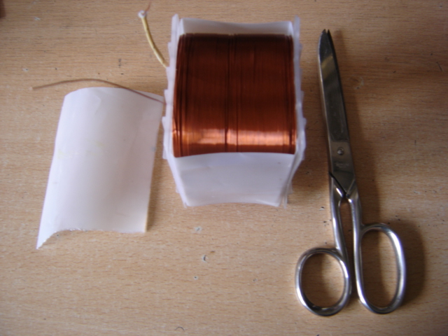

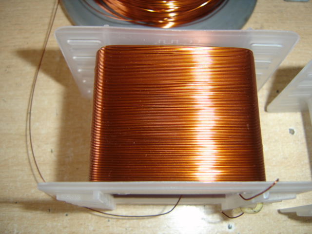

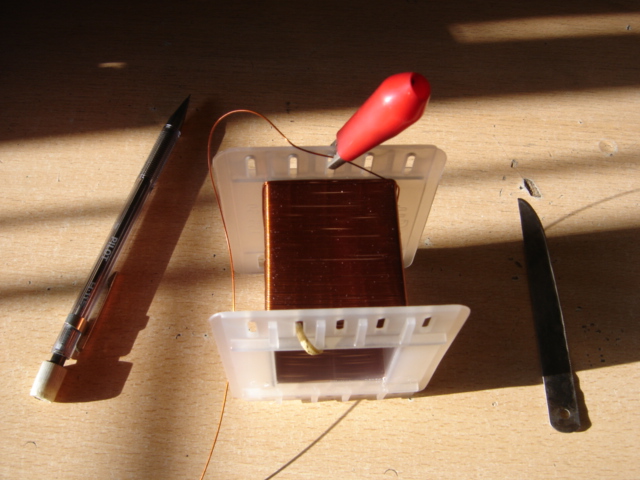

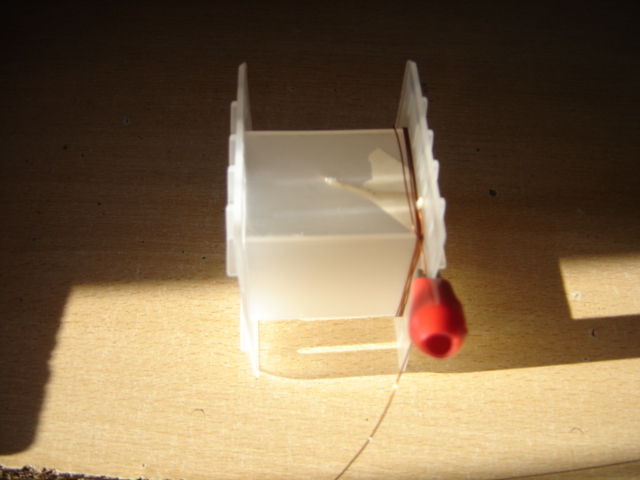

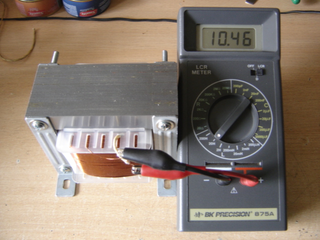

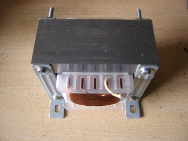

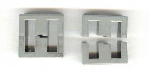

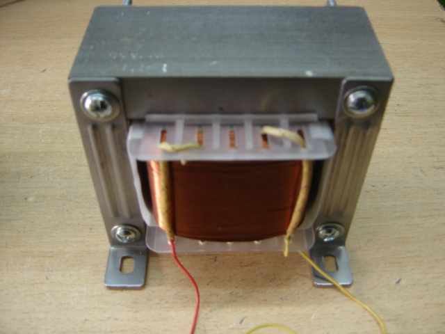

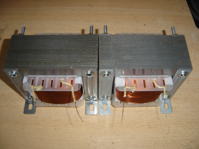

I like very much the choke input filtering method. And I able to make my own chokes. It is not difficult.
