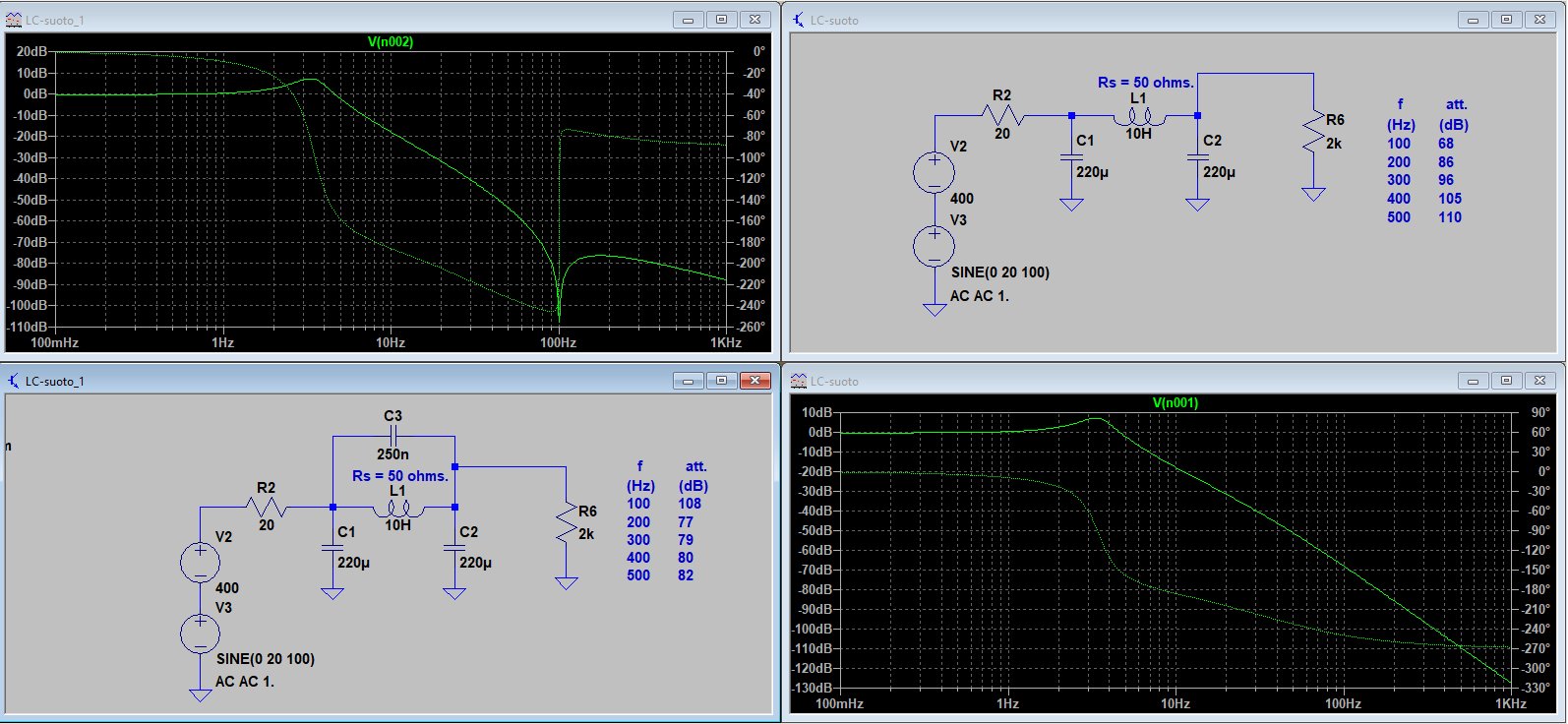

But if the filter is an inductor with a parallel capacitor and a capacitor at each end to reurn wire, the ratio of the caps defines the ratio of impedances, and hum attenuation, but also participates in the tuning formulae. If I don't remember bad, it is called m-derived topology.
Yep. Just as you say.
Outside that notch though, the filter rapidly stops filtering. Almost all of the harmonics above 100 Hz will be passed.
This may be a bit of an exaggeration. Below two CLC-filters, one typical, the other with the 100 Hz notch. The attenuations are written on the schematics.
The minimum attenuation of the filter with notch is improved some 6...7 dB
if 220 uF capacitors are replaced with 330 uF.
This technique may be useful if you need unusually low hum, you can use a CLCLC filter (with one choke tuned), and you are exceptionally good at getting grounding right (poor grounding would inject far more hum than the choke will remove). Unlikely for audio. These days we just use bigger caps instead.

This circuit (CLC with notch) maybe differs a lot from pure band stop filter, since the notch is located at the frequency where attenuation is already quite high due to 2 x 220 uF capacitors.
The simulation shows only some 12 Vpp across the inductor/250 nF capacitor.
...The attenuations are written on the schematics.....
Good; because the two graphs came out different scales and it is hard to compare them.
(Your sim can't plot two lines on the same graph? Draw the circuit both ways and drop two probes?)

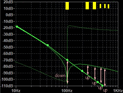

Also we don't expect milli-Hz coming in. Yes the bump at the corner may have significance but is the same with/without tuning. I have denoted the expected harmonics because that's what we need to reduce. (Assumed 100Hz power.)
My re-plot shows much less 100Hz but easily 20dB-30dB more at 300Hz up. Depending on room, speakers, listener, this lower midrange hash can be more annoying than the 100Hz partial.
An aside: this plan does have merit *for TV* where the 100Hz wants to beat with the vertical scan and make the image "hop".

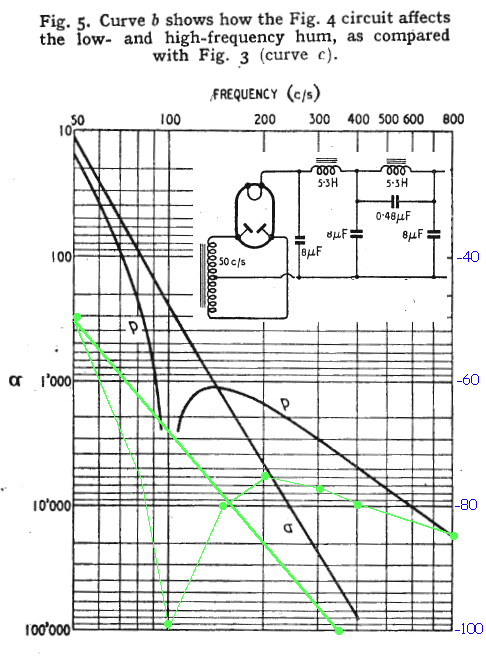

'Cathode Ray' (aka Scroggie) did a write up in WW Nov 1949, along with a measured result.
https://americanradiohistory.com/Archive-Wireless-World/40s/Wireless-World-1949-11.pdf
Thanks. We can trust Scroggie. I don't see that his curve is measured (it smells calculated). And *note* that he uses 8uFd not 220uFd, and he uses more *sections* than the sims run in post #8 here. So his curves start with less initial (50cps) attenuation, but have steeper slopes. (And are drawn upside-down from the way the sim plots it.)
It is interesting that the modern big-cap few-stage plan, and the 1949 plan, arrive at similar filtering at 800Hz (where it hurts). Do note that both are tutorial examples and not necessarily fit for any specific purpose.

I liked Scroggie commenting on a few items such as balancing the rectifier to suppress some discernible 50Hz. I'd suggest that few appreciate the variation in secondary half-winding DCR values unless they measure them to get say a PSUD2 parameter value, or the variation that can occur with tube rolling dual diodes - and even fewer would have a spectrum analyser at the ready to confirm minimum 50Hz - it almost seems like a humdinger is worthwhile.
However I would suggest that tuning is done to suppress 100Hz at idle operating current, as that would be perhaps the most discernible time to hear that hum, rather than tuning for max loading through the choke.
With respect to the effective Q, we don't really know from the OP what the DCR is, or what current the choke is rated for, so 50 ohm is just a guess. Plus there is some advantage to adding series resistance to the C, so as to lower the Q and to improve high frequency attenuation a titch.
What the article didn't add any comment on was how to actually tune the filter, given the inductance may vary noticeably over the load range. Scroggie just comments about the flatness of the tuning, due the sq-rt of L. It may not be that safe to accurately tune (if that is what one is after) as it could require some switched capacitor configuration and iteration, plus a spectrum analyser to confirm what is happening to the 100Hz level.
