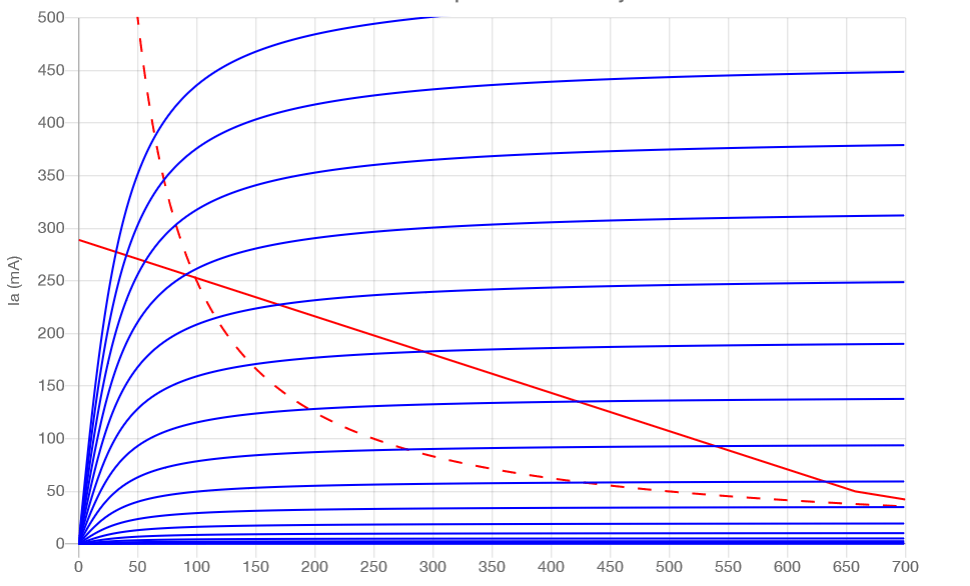

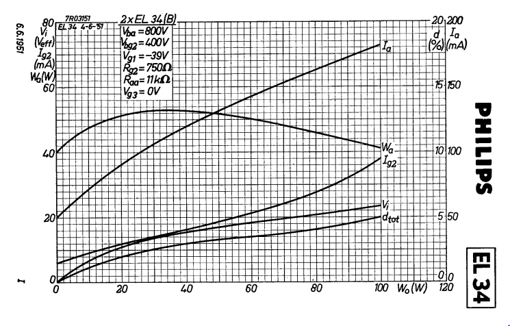

To be clear, max. output power cannot be calculated from max. PD and theoretical efficiency of operating class.
I gave an example of two EL34s in class B (the datasheet calls it class B while the tubes are actually idling at a rather hot 80% of the 25W PD limit ) delivering 100W.
I actually have an industrial Siemens PA 100V-line amp from 1955 that is built according to this exact datasheet example, putting out around 95W into 100Ohm before clipping with two EL34s.
This example shows that Pout can be up to 4 times the PD of a single tube.
But it wouldn't work with 6L6GCs, having a PDmax of 30W. Achievable output with 2 tubes is only around 60W.
Main difference is that the EL34s can be used with a B+ of 800V, while 6L6GCs are limited to 500V.
Power output depends on a number of factors like B+, plate load, operating class, tube dissipation and voltage limits, plate "saturation" voltage ....
So there can't be a simple formula (or a single number).
Rather, power output is found from a careful loadline calculation taking into account all tube limits.

Rikaro,
You did not give the quiescent plate voltage and quiescent plate current of the industrial Siemens PA 100V-line amp.
Perhaps it goes like this:
80% of 25 watts = 20 Watts quiescent plate dissipation
20 Watts / 800V = 25mA quiescent plate current.
Depending on the plate load impedance, the peak plate current might be 200mA.
With a ratio of 200mA/25mA = 8 (only 8), you might, or might not, be able to convince me that is real Class B operation.
8:1 current does not exactly meet the old transmitter definitions of Class B . . . but who cares, we are talking about audio, not RF, Right?

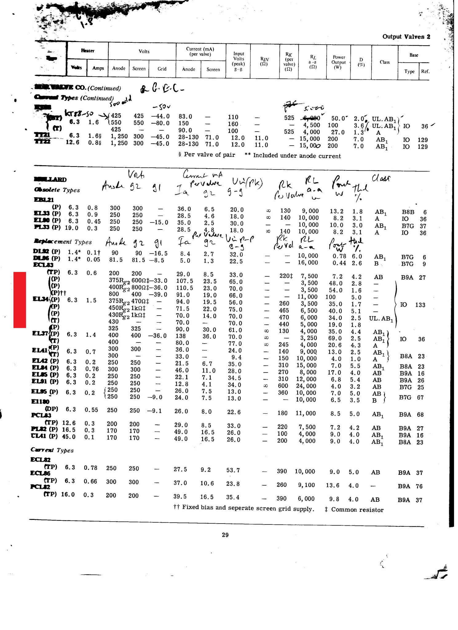

I have never seen the EL34 data sheet that lists the conditions to get 100 Watts power out.
I am sure it exists, but lots of data sheets list more or less information.
The early 807 RF data sheets listed the maximum screen voltage as 300V
Then along came audio, and Triode Wired operation . . . suddenly the maximum screen voltage became 400V (only for triode wired).
Then along came Ultra Linear, 50%. The data sheet could list maximum screen voltage as 350V, but it Never did (only for UL mode).
Marketing comes along and sometimes changes things, sometimes not.

https://frank.pocnet.net/sheets/030/e/EL34.pdf page 3
It is not my intention to convince you of class B operation. I think it should be called class AB.

I am sorry but it's you against Philips! The amplifier works as per datasheet, my results confirm it and your catastrophic assumptions simple do NOT happen. See below. If the G2 peak dissipation were so critical why didn't they bother to put in the graph???? Looks like snake oil to me.45,

Anyway it is important to know what is theoretical possible in terms of efficiency
45,
Thanks for the Philips Graph!
No, I will not argue with the Graph.
If I read the graph, I get:
100 Watts Out, Good (Hit the Goal square on the head)!
Plate:
800V x 70 mA = 56 Watts (in two plates that are rated for 50 Watts total, we are short by 6 Watts! Not good)
Screen:
400V, a 750 Ohm series resistor, and 38mA. 750 Ohms x 0.038A = 28.5V drop; 400V - 28.5V = 371.5V
371.5V x 0.038A = 14.1 Watts (Much better, two screens rated at 8 Watts each would max out at 16 watts; We have almost 2 Watts to spare on the screens, Good)
I am trying hard to be fair, but we are over the plate dissipation limit.
Do not forget, those hot plates reflect heat back onto the screen, control grid, and cathode.
56 Watts + 14 Watts (70 Watts) = More than 50 Watts + 16 Watts (66 Watts).
Do not forget the 6.3V x 3A for two filaments, another 18.9 Watts.
70 Watts + 18.9 Watts = 88.9 Watts inside two glass envelopes.
See how this works?
The final outcome:
Distortion:
Sorry, We have 5% total distortion on the graph.
No more than I actually expected (hope springs eternal, there is a fix for that).
Philips graph exceeds their own rules.
And, 5% distortion is a long way from 2% distortion, and even further from 1 % distortion.
Obviously, two things are needed:
1. Negative feedback to get the distortion down to 1%
2. A fan, to extend the life of the hot and overloaded EL34 tubes.
What is the sound of an amplifier that dies prematurely?
The same sound as one hand clapping.
You can see why I was just a little bit skeptical.
Too True to be Good;
or
Too Good to be True.

All quantities in the graph are for 2 tubes. So 55W maximum plate dissipation happening at low power delivery means 27.5W per tube which is the max rating per tube WITH signal (25W without) for the EL34. The EL34 is a much better tube than many think....in ALL aspects.
As I said, your assessment of the cathode feedback effect on distortion is not correct. It might be ok for GRND fbk. Cathode feedback is a LOT more effective at killing non-linearity. Moreover the 5% figure is not the bible, it could be 4% or anything around the datasheet figure, depending on several things. It seems that you never built an amplifier.....
A fan needed? Don't be ridiculous, please. You are sceptical just like those who didn't believe the Earth was round.
So lets actually get some visual about what we are talking about.
From the EL34 datasheet:
Va: 800V
Vg2:400V
Raa: 11kohm
Ia_bias:25mA
Which results in the following graph:
(https://www.vtadiy.com/loadline-calculators/loadline-calculator/)
Granted, in almost full Class-B mode you can pull a bit more out of the tubes.
But I have a hard time believing that these will have a long life in this mode?
I do think that back in the day they already got a sense of "music power" instead of just continuous output power.
So yeah I can see this working when you consider that the average power of music being played is a lot lower and your amplifier needs to provide the occasional (relatively speaking) peak power.
In the end there is always a time variable in dissipation power (thermal mass inertia).
Meaning that for short periods of time you can actually dissipate more power.

I would also add that many users are correct over querying power tube performance. Sometime ago a friend gave me a box of Russian 6550B plain glass (rather boring to look at with button getters) and on my jig in AB, I darn´t push conditions more than 30W # 450V #60mA (each) was the best with red anodes well established. What do we have here ? I never got this red anode with latter Svetland 6550C´s nor any other with comparable anode size for same operating conditions. Can anyone come to the conclusion that the 6550B is really a very poor mans Btetrode ? These Russian 6550B tubes seem way below what the 6550A or C version is capable of pushing out, and yet there are some marketing ? claims that the B version is also a replacement for the A/C. That is not what I found. Although the B version measuring AB distortion is surprisingly low I would never put these in amps rated over 25W when the original 6550A IMO was a darned good robust tube (42W anode and it mean´t it) and such a pity it is extinct. Comparing tube specs from 60 yrs ago to the same named on todays made tubes, is a case to be on one´s guard.I have never seen the EL34 data sheet that lists the conditions to get 100 Watts power out.
From 1960 here it is in tabulated form Class B ICAS (intemittCommercial Amateur Service)... savage conditions as the transmitter modulator amps at that time were modified to be used as PA horn announciators where quality wasn´t required.
rJ
See the datasheet that I just posted (above the graph) 🙂I have never seen the EL34 data sheet that lists the conditions to get 100 Watts power out.
This is basically the standard EL34 datasheet as far as I know it.
Otherwise it would not be possible to achieve 100W with two 25W tubes.

1) Seems you misread the graph. The plate current @ 100W is 91mA per tube.Plate:
2) Multiplying plate current and B+ gives total consumed power - not plate dissipation.
PD is lower because average plate voltage is significantly lower than B+.
Now lets do the math using datasheet values:
Pin = 2*91mA*775V = 141W
PD = Pin - Pout = 41W
So PD per tube at full output is 20.5W.
Definitely works fine as my old Siemens amp shows.Yes. It's even not possible, for sure...
I's a proven and rugged design also used by some professional Philips amps of the time.
Don't forget that Siemens and Philips both were major tube manufacturers, knowing their tubes.
As said it won't work with 6L6GCs, which need to stay below ~60W.
So no rule between PD and Pout.
That calculator doesn't seem to be correct for this class of operation , 800V ( the idle point ) should be in center and of course the voltage for reactive load goes up to 1600V . Looking at the angle of the load that is impossibleSo lets actually get some visual about what we are talking about.

Could be, I have made my own excel sheet where I just simply calculate and ax+b graph and when it intercepts with the Pd curve. I haven't checked that yet.That calculator doesn't seem to be correct for this operation , 800V ( the idle point ) should be in center and of course the voltage for reactive load goes up to 1600V
Usually it's in line with this loadline calculator.
