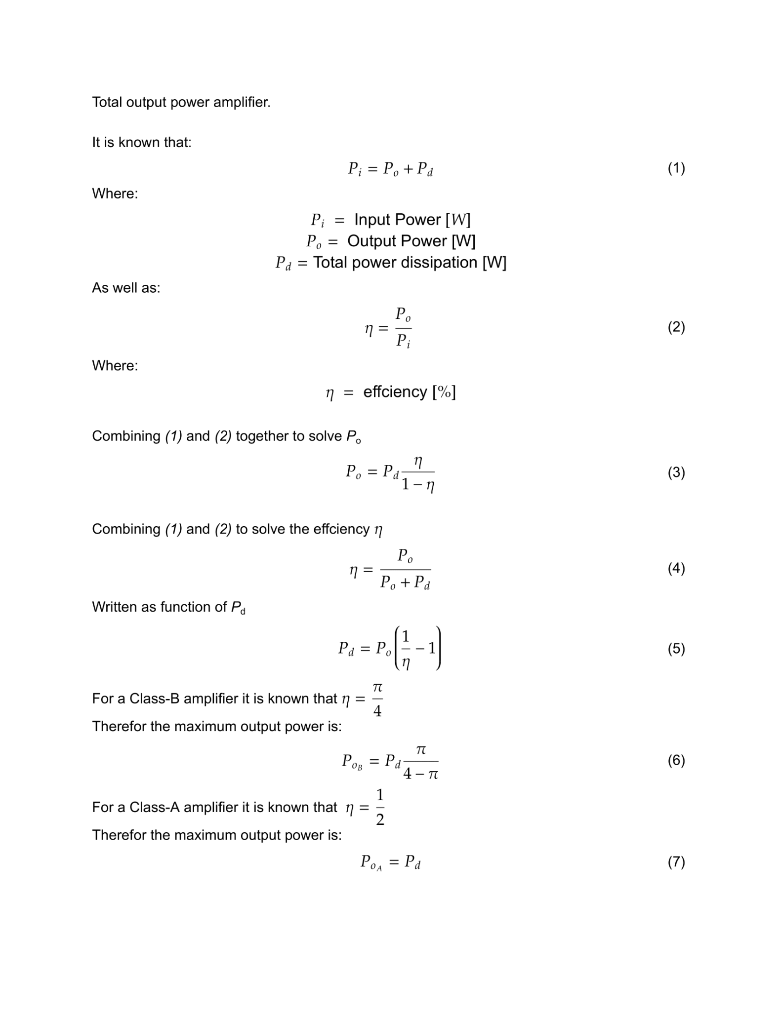

Thank you for the reply. I do understand that the tubes not designed expressly for audio output, would have no need to give output power. OTOH, some of those tubes have made fine output tubes nonetheless. I think the 6AQ5 was one of the tubes that would be in this category. Concerning your last sentence, YOU can easily calculate those things. LOL You forget, I'm very new to this and have never had any bench experience at all. I'm hoping to change all of that but at the moment, I'm still 'in school' learning from whom I can. You know, when I look at the curves on the datasheet, my eyes just glaze over. They are next to meaningless to me. It's like reading Chinese. No offense intended to anyone.Some datasheets of old included specific numbers for specific use cases (SE, PP, different B+, biasing, OPT impedance etc). But there are many pentodes/beam tetrodes that were not designed for audio, therefore there was no need for that.
Almost all datasheets include anode curves, with that in hand you can easily calculate an estimate of the expected output power.
I have yet to read all of the answers here but this one seems top notch. Being able to hear about max efficiencies does help. One thing that is obvious, is that not all tubes operate at max efficiency. OTOH, some outdo the theorectical, I can only guess, by being underrated to begin with. I don't like ending a sentence with a preposition but I will leave it as is. lol Thank you.this!
Also a transformer coupled Class-A amplifier, has a higher efficiency compared to a non-transformer coupled amplifier.
So for Class-A tube amplifiers (which are basically always transformer coupled), the max theoretic efficiency is 50%.
So half of the plate power dissipation (minus the losses obviously).
For a tube that has a plate dissipation of say 12W, the absolute theoretical max is 6W of output power.
For a Class-B amplifier (push-pull) the max theoretical efficiency is 78.5%
So for two tubes with 6W plate dissipation, the absolute theoretical max will be 2 x 6 x 0.785 = 9.42W
As a bonus, two tubes parallel used in a Class-A amplifier:
2 x 6 x 0.5 = 6W
You can't get more out of them without breaking the laws of physics. 😉

Agreed. That is normally the definition.Efficiency is not output power divided by total plate dissipation.
Rather it is output power divided by total power consumed.
E.g.: Two EL34s can produce an output of 100W (see datasheet).
Assuming that total plate dissipation at full output is 2x25W, the total power consumed would be 150W.
So efficiency results as 100/150 = 0.67.
Then as someone else says, efficiency is not constant from zip to max Pout but it is pretty irrelevant as long as plate dissipation is within tube limits which is normally the case for datasheet suggested operative conditions.

Yes, you're totally correct, I just had the biggest brain fart yesterday.Sorry, no, again. In your example 100 W output power relates to the efficiency, as always. Input power calculates to 100 x 100/78.5 = 127.4 W. Hence, waste is 27.4 W.
Best regards!
I asked the mods to strike out the text, but apparently they don't do that and have a rule with what is written is written.
(kinda strange imo)
So consider that post as unposted.
I did derive the correct formulas today and will post them later.
Yeah, absolutely no idea what I was thinking yesterday, omg
Anyway, here the correct way of calculating (hopefully I didn't make any major typos).
Little practical side note though, this can look a bit surreal.
Keep in mind that these efficiency calculations don't take other (practical) variables in mind.
Therefor you might end up with weird values.
For example a Class-A tube amplifier that is (close to) center biased, will mostly be around half of Pd for any practical purposes. (maybe that's where my brain went total weird).
Also a Class-B amplifier is not the same as a Class-AB in sense of efficiency.
