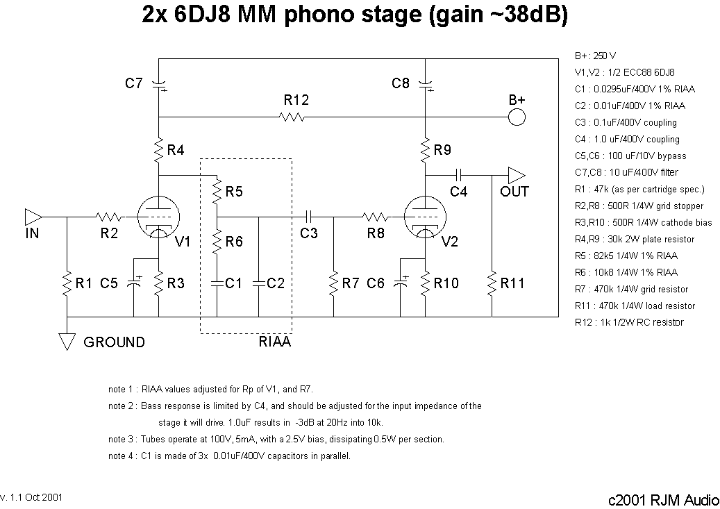

I've built this and it works well. RJM Audio - Tube passive phono preamplifier
I was looking at this last night I really like the sound 6DJ8 give out, and seeing I have a el34 6dj8 amplifier i built already. this one will make the list of choices, thanks

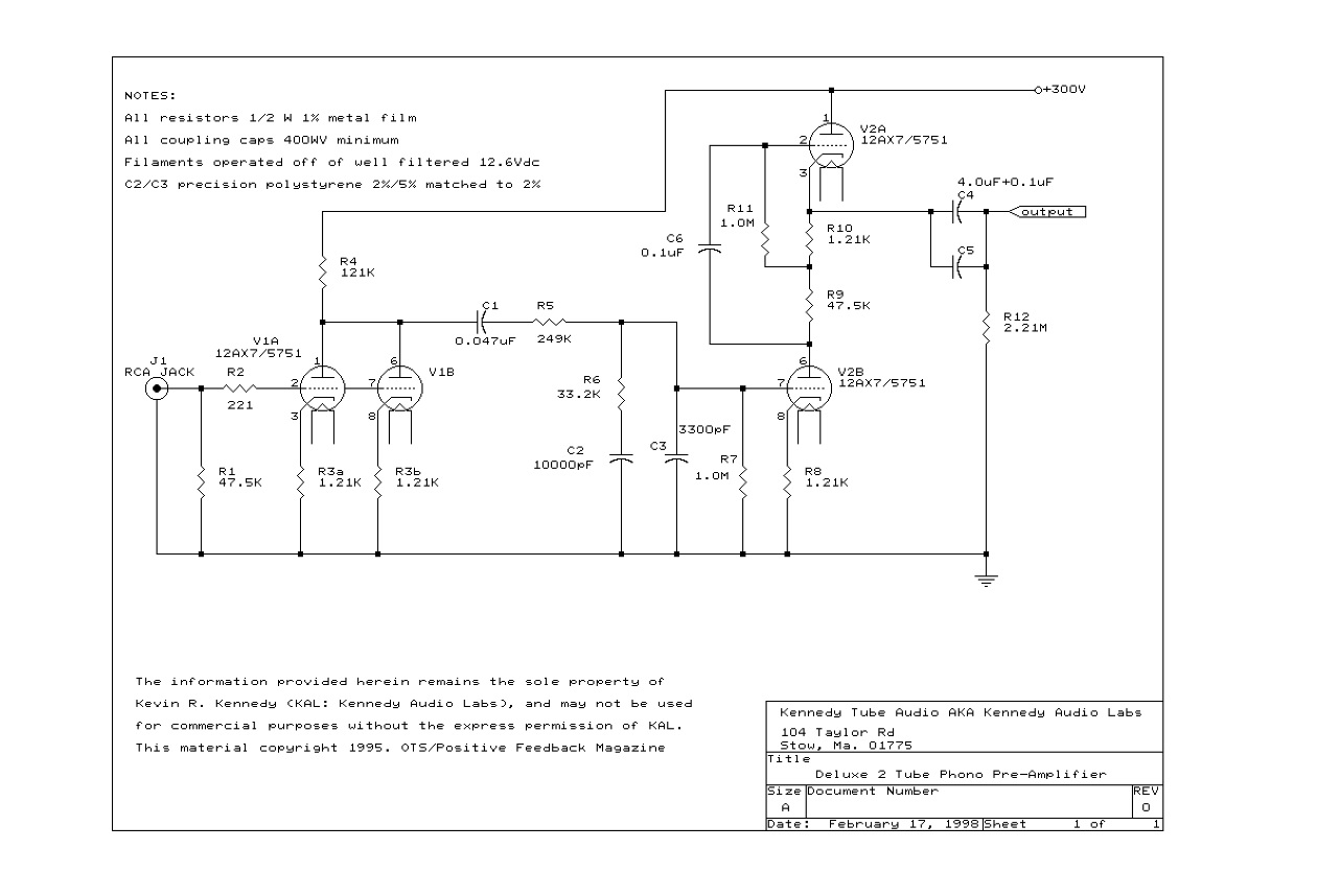

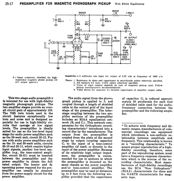

The first one would seem to increase input capacitance. The third has gotten some decent reviews but I think it would be worth splitting up the EQ network and adding another stage of amplification since it is a few dB shy on gain.The middle one also does the passive EQ in one step and also would benefit from a follower at the output.

May I ask a sincere question about that design?
Why is the plate load on ECC83 T3 (T3A and T3B) only 22k ohms? That's less than half the rp of an ECC83. What is that supposed to do?
There are things that look good in simulation but work terribly in real life, with real devices that have more complex limitations than those in the models. I fear that might be at work here. I don't see how a 12AX7/ECC83 could work well as a clean amplifying stage with a 22k ohm plate load. But hey, the author may know something I don't. Either I'll learn something or I'll have exposed a flaw in the design. So... Which is it?
Well, I have, as carefully as I could, read the article of that Bucci and I cannot find anything in it which is not carefully designed. From that second stage of the RIAA circuit it is possible to increase the gain somewhat more by increasing that 100k resistor R34 after the coupling capacitor because it is shunted by the 50k volume control resistor R23A when the RIAA output is selected by S3A.
But anyway, why should the voltage gain of that gain stage be larger that it is now (about 20dB hand calculated)? In total the gain is enough to amplify the MM cardridge to a sufficient level.
That stage is not meant (I think) to supply max power, if so then yes, its plate resistance R32 must be a lot more.
But I hope that rongon or other participants of this thread, can enlighten my lack of knowledge in this matter. Always glad to learn something. 🙂
And yes, there are other tubes to do that job producing lesser noise than that ECC83. But it was not the intention of this design to perform top level performance.
Careful and competent are not the same thing 🙂
... From that second stage of the RIAA circuit it is possible to increase the gain somewhat more by increasing that 100k resistor R34 after the coupling capacitor because it is shunted by the 50k volume control resistor R23A when the RIAA output is selected by S3A.
Not with the 22k anode load. The 22k dominates the gain.
Nothing against the guy, but I'd also be curious as to why the 22k and also why the 22uF coupling cap. There are some other odd choices in that circuit but I'm not really interested in dissecting it. It does smell a bit odd...

Regardless, if you examined his design closely and it was done competently in your opinion, perhaps you can explain his choice of the 22k load, 22uF cap and I might have a couple other questions after that 🙂
